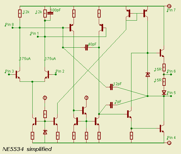

Hello!
I have attached a simplified schematic of the NE5534 circuit.
I have put in a few values of components
that I have been able to find.
I think it can be interesting to compare this circuit to other amplifiers.
The NPN input differential stage, with offset adjust possibility,
drives a dual PNP stage, which is brought together by a mirror.
So far is like many other amplifiers.
But the last stages are all NPN based.
There are no less than 4 small capacitors, that helps amp to do better.
100pF, 40pF, 7pF and 12pF.
This last 12 pF is the internal compensation cap.
This is recommended to be parallelled with external 22 pF ( Pin5 - Pin8 )
when using NE5534 as a buffer. Gain = 1.

lineup said:The NPN input differential stage, with offset adjust possibility,
when using NE5534 as a buffer. Gain = 1. [/B]
Good PNPs are hard to make in ICs without fancy fab processes
The NE5534 was a masterpiece of nested feedback to get its distortion figure low.
