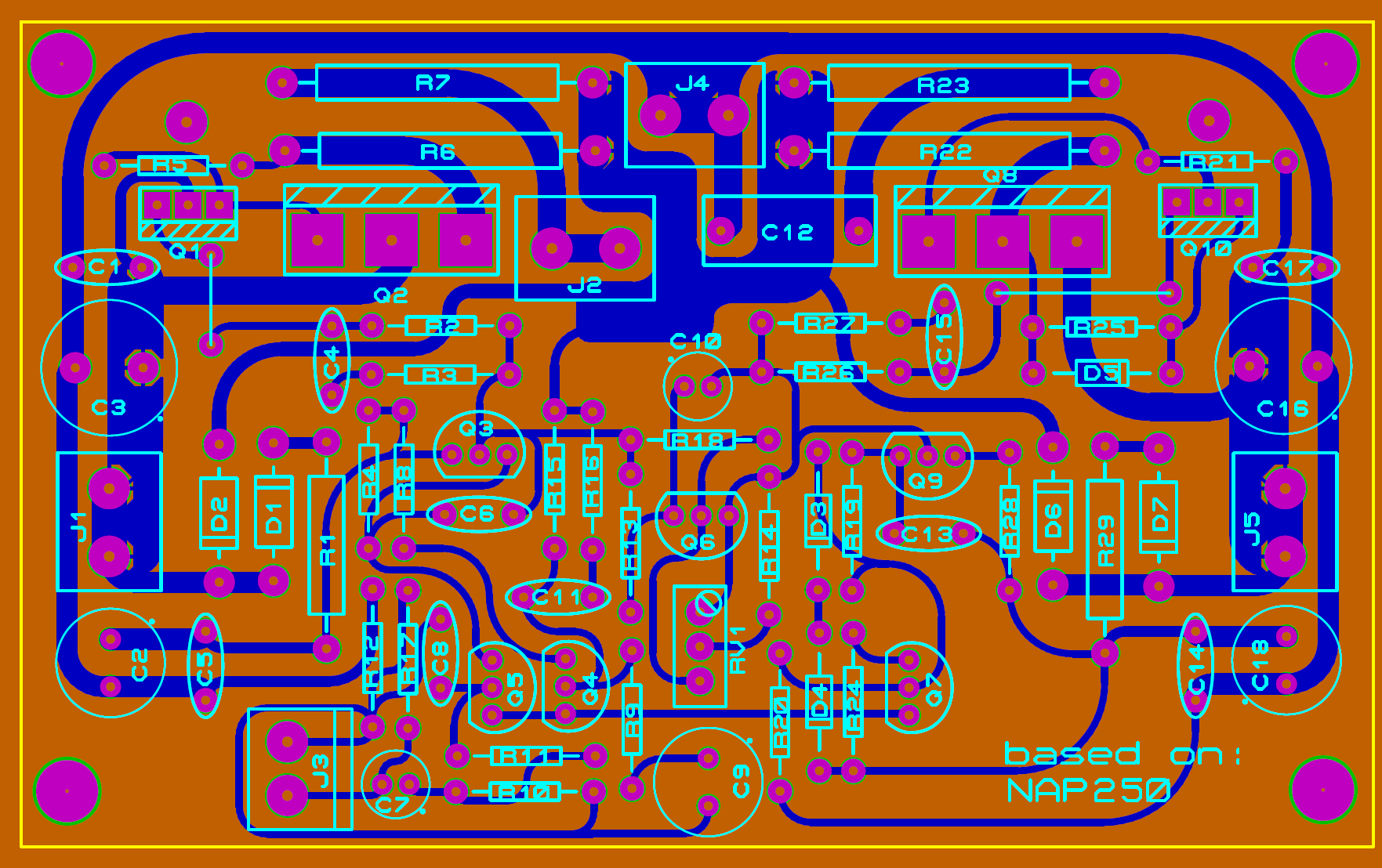

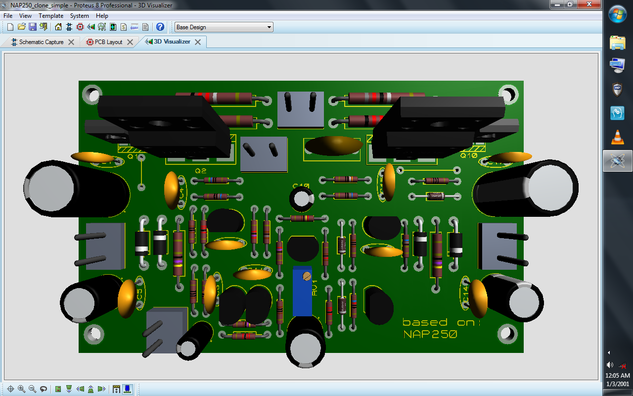

The NCC200 by Avondale are based on NAIM right? I am also doing a version based on NCC200 which were based on NAIM, so my work is also a NAIM copy (not a clone I guess). I'm doing my own pcb lay-out, it is single sided and trace routing is mostly done by electra with a few re-routing done by me to shorten some traces. Don't mind the copper zone the program wanted me to label reference points for the zone. By default it was laid as ground plane...anyway I hope I am allowed to show my work here.
