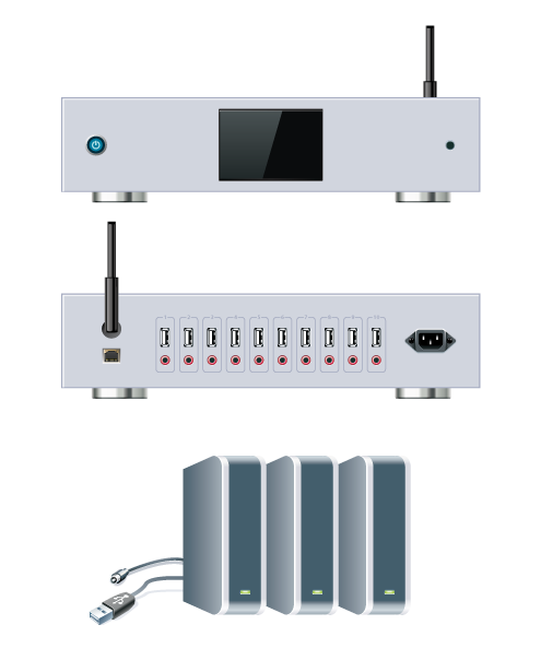

I have several external USB hard drives with audio and video. I'd like to make NAS and connect them to that NAS so that the drives would be visible on my home network.
Is it also possible to combine NAS and Streamer functionality? Is it really required to use a dedicated OS (e.g. OpenMediaVault) or it's possible to make NAS without it using just the regular OS (e.g. Raspberry Pi OS)?
For the hardware I think to use:
- Raspberry Pi 4
- Powered USB Hub to connect external hard drives
- Relay board to switch on/off external hard drives
- Small touchscreen if the system will have the Streamer

DRONE7, thank you for reply. I'd like to use the hard drives as is without removing them from the enclosures so that I could easily move those hard drives around.

phofman, they are just regular external hard drives. The regular usage will be when only 1 maximum 3 (3 users using different disks) of them will be spinning. Hopefully that's not so noisy.
