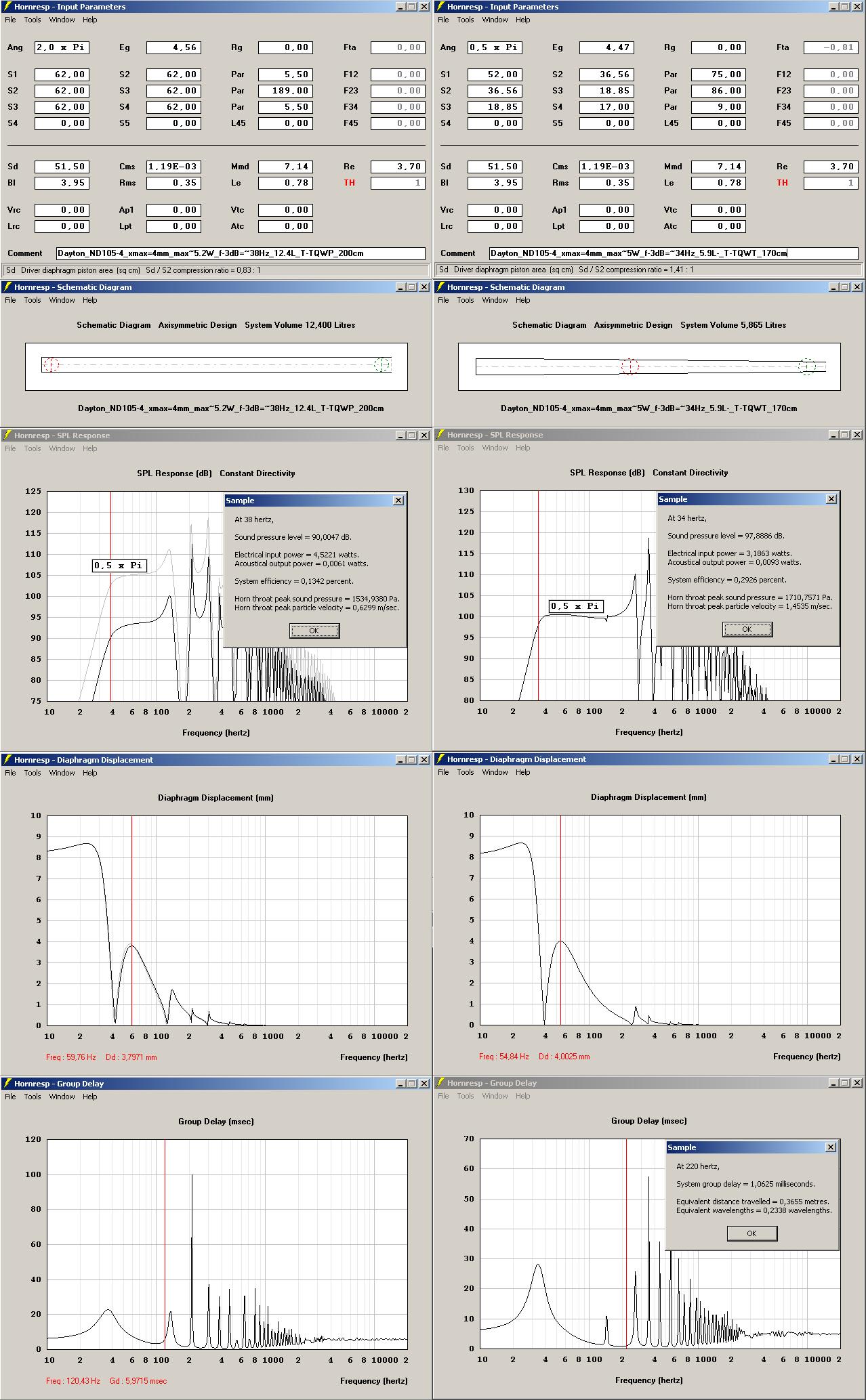

Here is a suggestion of very small footprint subs (single-folded) both reaching below 40 Hz that should be listened at short distances:
b🙂
I would build a Bose Wave Cannon.
For 40hz the overall length should be about 84". The front pipe length should be about 1/4 the total length, or about 21". Ideally, the ends of the pipe would be 42" apart, as the Bose car systems do.
4" cardboard mailing tube, or 4" schedule 40 PVC pipe would be fine.
The original Bose radio-cassette boom-box used a single 4-1/2" driver driving an 84" (total length) plastic labyrinth, and it impressed me (other than the price).
