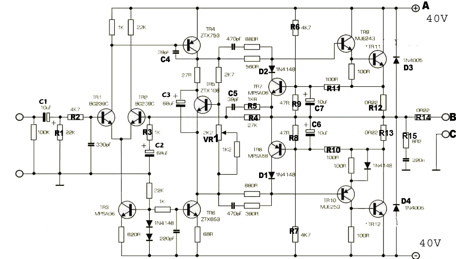

Hello folks. I need to limit the current draw (due to power supply limitations) under extreme conditions. There are two ways to do this within the amp (I think). Reduce the overall gain to a fixed value, or add a photo-coupler circuit to the feedback loop or the gain circuit. Problem is, I have no idea how it works in the first place.
Here's the schematic:
Any comments would help greatly.
There already is current limiting built into in this circuit. That could be increased somewhat.
Limiting the gain would not protect it.
Thanks rayma. When I send a 20V 10kHz square wave into it, the current goes to my 3A limit, but very slowly climbs beyond that as the transistors start to roast. It was shut off before knowing how far it would go. There are also TO-220 1 Ohm 25W resistors on the rails with heatsinks.

Increasing R12 and R13 to 0.27R or 0.33R would reduce the current limit
I will try that. Thank you very much.

@Ian Finch: Aha! A fly in the ointment. My testing is on the bench. I have repeatedly checked the bias current from cold start to almost breakdown. This clone recommends 10-20mA. I tried the whole range and it seemed not to have an effect at any power level. I did twist the pot too much once and the current skyrocketed causing both SMPS to shut down.

I am not sure that it is a good idea to add heat sources in a box in common with this diagram because the basis of everything is the control of the internal temperature of the box which will determine the current supplied at the output.
if you add a heat source, you will "cheat" the detection transistor which will reduce the current unnecessarily even if in absolute your case being made of aluminum will also rise in temperature and participate in the artificial heating of the output transistors.

Naim's products had quite low bias, so the amplifier shouldn't get much warmer than some 15°C above ambient until the power is peaking above 25W. It might not seem much power but in a musical instrument application, high power isn't the big deal it becomes with commercially produced music and audio systems, where enough power for the deep bass is the practical limit to how loud the system can go.
As huggygood already mentioned, altering or limiting the temperature 'seen' by the sensing device is a bad idea when what you need to control the bias current, is an electrical current that is analogous to the average temperature of the output stage - not a version which is subject to other influences. Otherwise, any settings won't be under control at all or only partially and the results will be about as successful as mine once, when I built a few Quasi amplifiers that either had very little current but were docile or they suddenly skyrocketed to semi-heaven when I tried to set the recommended current.
The trick that finally dawned on me, is the location of the Vbe multiplier or sense transistor and its loose thermal coupling via the air, which damps the response and makes possible a smooth bias control that doesn't react to brief signal fluctuations. Setting it may not be so simple, though. The delayed response can be frustrating to work with but if you follow the procedures often advised here for Naim gear, you shouldn't have much trouble. I've posted this link a few times now but the article is informative and gives you some insight into what works, why you shouldn't worry too much about precise settings and how simple it can be in practice, once you get the physical layout with its enclosure right. Just one thing about music - when it hits you feel no pain Scroll down to "More Naim stuff" > "bias settings in Naim amplifiers".

The NAP250 schematic you attached is essentially the same as the clone. It does include some VI limiter circuits but these can simply be deleted. All you then need to do is list the TR numbers against the abbreviated transistor substitute types (e.g BC556> BC239C. 5551=2N5551>MPSA06. The Vbe muitiplier, shown as TR5 is now "669" or actually a copy of 2SD669A. Soon you'll be left with the schematic that matches the parts overlay or close enough. Just remove R6-11, D1,2, TR6,7, C6,7 and their connecting leads from the schematic, as these don't appear on your clone PCB stuffing guide.
I'm certain there are edited versions of the NAP250 or Avondale Audio's NCC200 clone schematic sans limiters, out there already because folks are scared that the limiters will hurt their precious sound. 'Funny how the original amp that uses them still sounds superb even after 50 years of further audio development.
Yes, its a "bitser" of a clone and won't show any resemblance to the original's sound quality because that lies in particular specified types of transistors but I wouldn't think you were expecting that for your purpose anyway. However, limiters would be a smart idea for guitar use, where you otherwise might need to be super careful with output peak levels.
