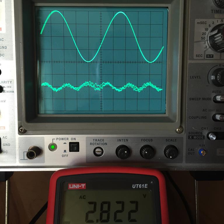

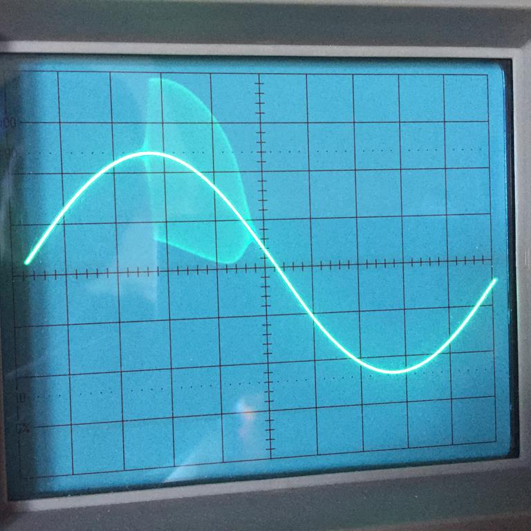

There is a high frequency noise on the right channel, which seems to be around 2 Mhz, with varying strength. I have attached a few pics of output on scope. Test signal is 1Khz sine.
One picture shows just the HF noise present with the amp idling and no input signal. (Time on scope is set at lowest here: 0.5 uSec per division.)
During this test I found a clear connection with Iq (bias) level: The noise would disappear when as I lowered Iq to around 20mV (specification states 40mV). As I raised Iq towards 40mV again, the noise would come back!

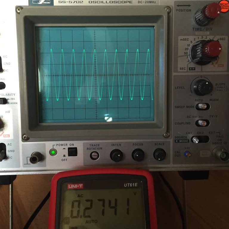

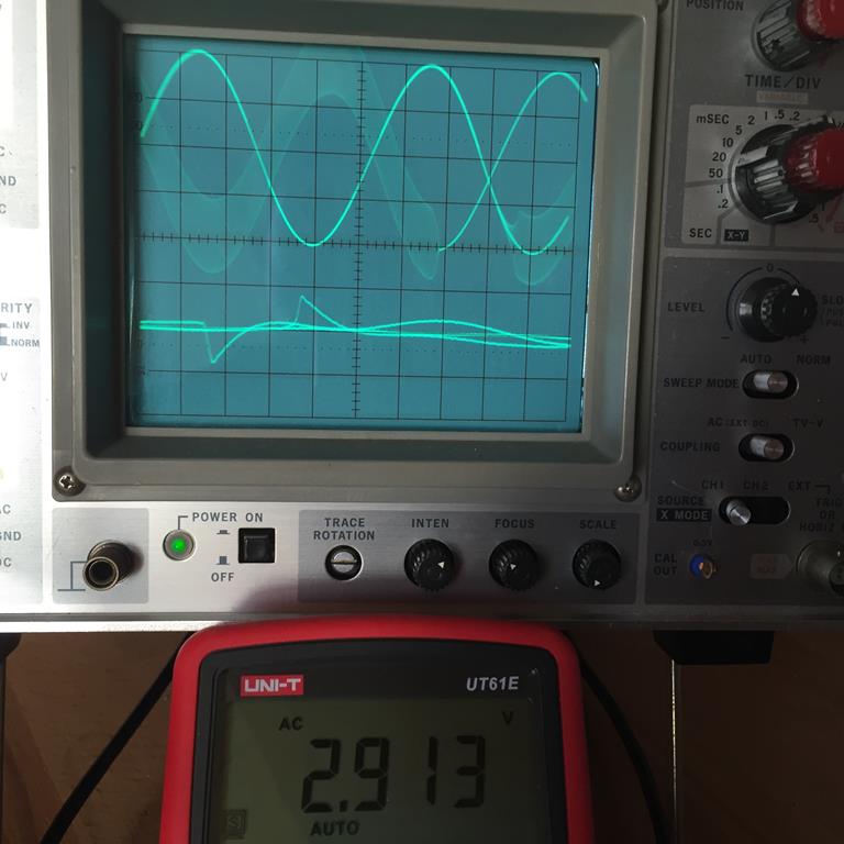

At a second test (today) I was unable to replicate this exactly. Now I could just see the problem from the high distortion level at 1w output, and also my oscilloscope actually makes a high pitched whine when I connect the right channel - which does not happen with the left (good) channel.
One photo shows distortion residual from HP339 distortion analyzer below the 1w 8ohm output (1 khz sine test signal). The HF noise is clearly visible on the sine output. DMM shows RMS value of amp output.
DC offset is around 4-5mv, so that seems fine.
For comparison, I have also attached a pic of the the left channel output, and with distortion residual below. Very nice.
So the fault seems to be related to Iq level, but varies periodically in serverity.
At this point I am thinking defective output transistor, so unless someone has a better idea, I will desolder the source resistors one by one (in pairs), and try to eliminate the fault that way.
But if anyone has seen this issue before (perhaps even on a Threshold of similar design) I would really appreciate your input. Thanks in advance.

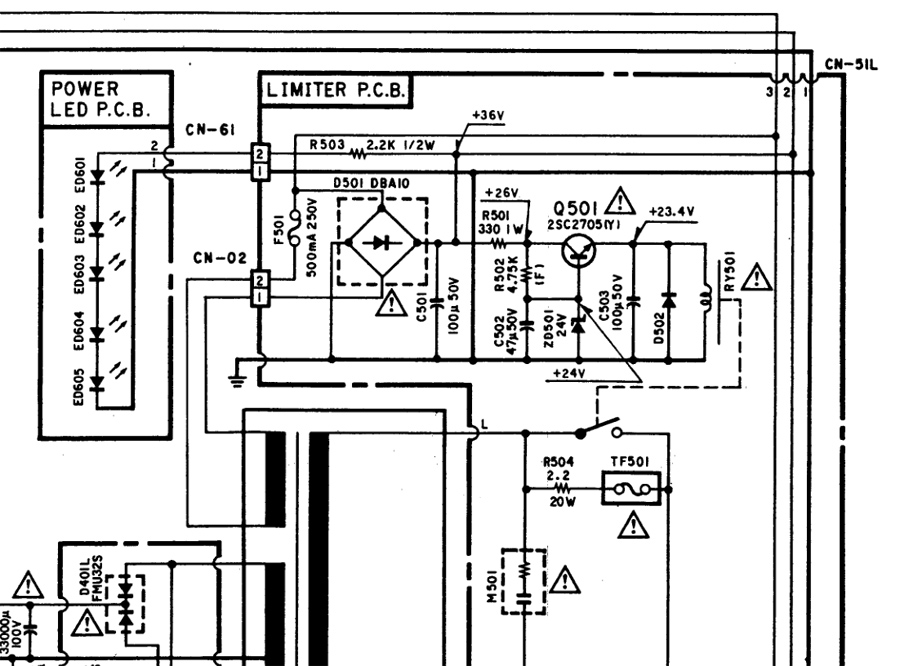

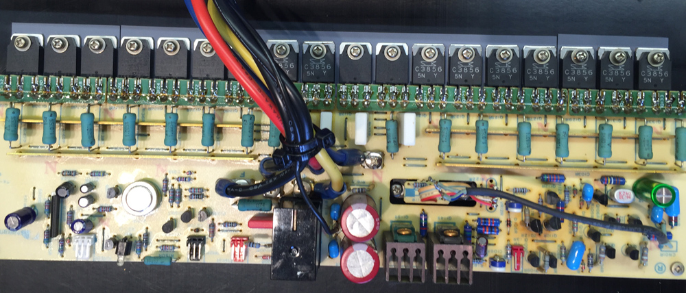

Hi, I believe I have now fixed the original fault, but there was some unexpected "collateral damage" in the proces. Here is what happended:
In order to check if the output transistors were the source of the oscillation, I disconnected the source resistors for one half of them (in pairs), to leave them passive. Then if the problem was still there, I would do it vice-versa with the other outputs, and that way quickly determine (hopefully) if I should focus on the driver section - and try stabilizing with resistors as previously suggested.
Well I definitely got a result from this, but a bit more dramatic than expected:
After about 20 seconds, the Iq level suddenly went off the charts (I had initially set the Iq level very low), and the amp's fuse popped..
I then checked all the outputs, and Q132R was a dead short.
So this basically meant all new output transistors in that channel, and fortunately I managed to find the correct Sanken devices. After soldering them in, and having checked all resistors and capacitors, I powered it up (using test bulb) but nothing happened! After some investigation, it turned out that the R504 20W R2.2 limiting resistor had burned out in the earlier test - which is a bit worrying.. (The TF501 ought to have prevented this afaik).
After replacing the R504 with a 5W type (while ordering the correct 20w model), I was able to get some initial measurements on the repaired channel, and dial in a little Iq. Everything looked good for around 10 minutes 🙂 - until the amp switched off again.. 🙄
So I had a closer look a the limiter PCB, and discovered that the RY501 wasn't engaging after a few seconds as normal. The relay works just fine, the problem is that it doesn't get the 24DC trigger, so the amp had keept drawing power through the 5W resistor until it gave up.. I believe the problem is the Q501 SC2705 BJT on the Limiter PCB (See schematic in post) - but havn't yet found a replacement.
To sum up:
The oscillation problem seems to have been a leaky/unstable A1492 transistor, that then decided to short out during fault finding (a somewhat "funny" coincidence though..) . But I still need to run a few more tests to be sure the problem is completely fixed.
Questions:
- What would cause the Q501 SC2705 BJT to become defective here? - And can anyone suggest a suitable replacement?
Thanks again for your help.
Regarding SC2705 replacement: I has some SC2547E, and after a quick datasheet check I have soldered one in, and it works just fine: Amp powers up and relay clicks. Still don't exactly know why the SC2705 failed in the first place.
However, all is not well, as I now again have a shorted output transistor on that same channel! Seems like that shorted A1492 output may have been an effect rather than a cause.. I suspect it failed due to Iq (bias) run-away (just a theory at this point), so next step will be to try and find what could be causing this issue. Seems to be intermittant, as I had it running for a while with no issues, and then suddenly it goes whammy on me :/
Update: After desoldering most of the outputs, the shorted devices turned out to be Q120R and Q117R. The Q120 is a regular output transistor, while the Q117 is one of the four Stasis/driver transistors - which were also new. Both are SA1492 PNP. So I still suspect a problem in the Iq/bias circuit, but will leave it for now, and continue fault finding next week... Also need to order new transistors - again.. Qualified advice is welcome..

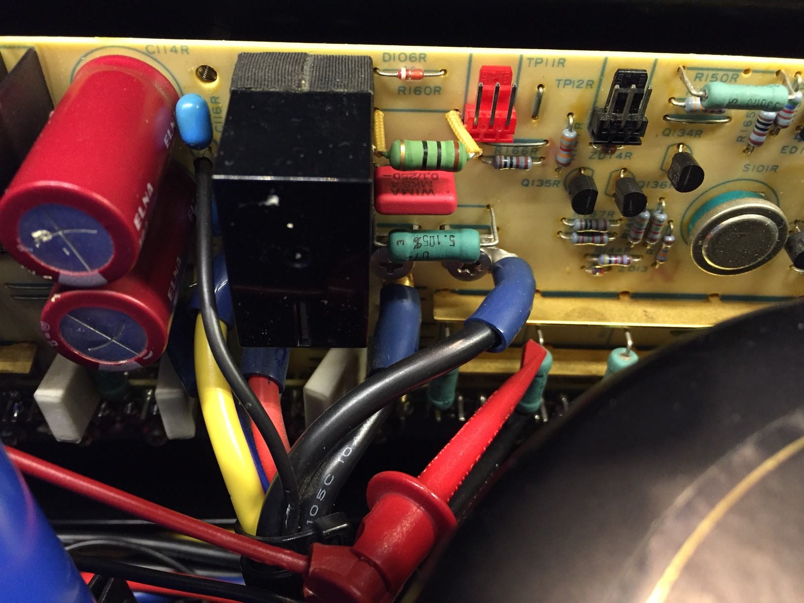

Bad resistor found
While waiting for new transistors to arrive, I decided to check all resistor values in the channel. I had already checked most resistors earlier on, but had apparently missed R160R on the positive rail, which turned out to be bad: it measured around 16Mohm. See attached photo and detail from schematic (the complete schematic can be found at Hifiengine, see link in initial post). The original was a 1/2w type, and I have replaced it (and the counterpart R161R) with 2w MOX types - which is what I had on hand. These should at least be up the the task.
Now the channel is running with 5 output pairs (two pairs are missing at the moment), and seems to be stable. No noise or oscillation, so thats very good!
I have not found any other defective components (other than the dead outputs), so I think (and hope) this rail resistor was the actual cause of all the problems. Silly that I didn't find this simple fault too start with, but I guess I was overly focused on finding the unstable transistor(s) 🙄
The THD in the right channel is however somewhat higher than in the left, and the distortion shape is not nearly as pretty. To match the nice low 2nd-3rd harmonics of the left channel, I have to turn the Iq way up: Around 170mV (and ditto mA) it cleans up very nicely, but that is of course much too hot for continual use.. Will perhaps try with a different "driver quad" and see if it helps.
Will come back with a final update, once I get the two missing output pairs installed.
