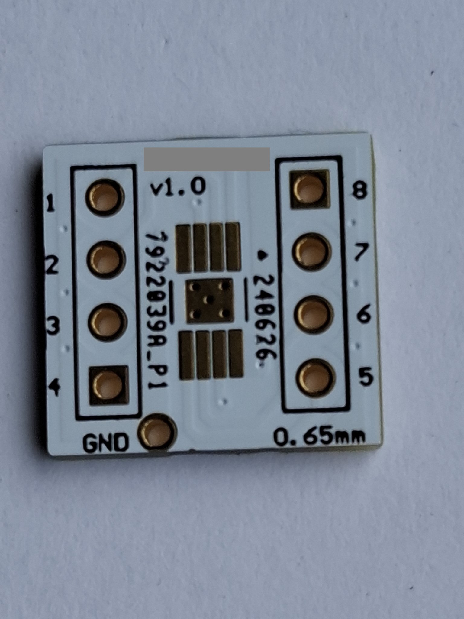

In the end I swapped to the DBX234XL and have nearly finished upgrading a pair of those to audiophile level.
Upgraded the capacitors to Wima FKP and Nichicon UKZ.
Rolled the Op Amps to OPA 2828 (dual OPA828 ) and OPA 1644 for the quads.
I had to make a custom PCB for the 2828 as well - (if anyone is interested to buy some OPA2828 PCB's let me know).
