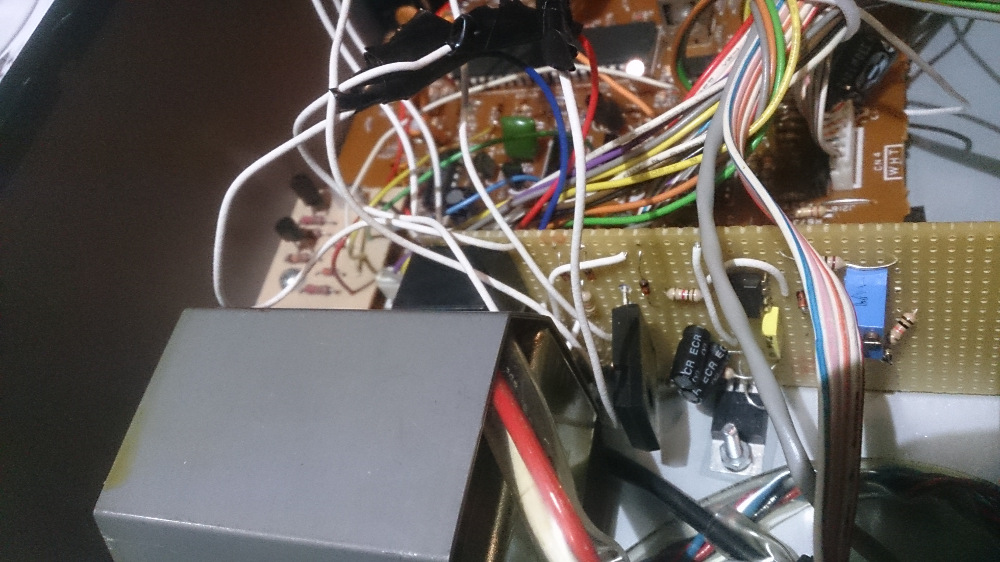

Then I had a sudden and absolutely crazy idea 😀: instead of wasting hours to try and find the problem, why not build my own motor controller, which would only be activated during play/record, on rewind and fast forward the original controller would work, being my controller circuit bypassed. I decided to go for a very simple PWM circuit based on 555. Yes, crazy. It needed a lot of tweaking and changing, as in the beginning the frequency was way too low, making the motor whine, I then settled at about 35 kHz (well outside audible range), also the voltage turned out to be insufficient, in the end I opted for 9V and regulating the duty cycle very much close to the low end, so that motor wasn't too fast and didn't give too much torque, but still receiving higher voltage, hoping this would help to not oxidate and stall so soon again. It worked!!! the motor didn't stall. Or at least seemed so. Then it was quite a challenge to get the right logic signal to switch the bypassing (which was done in the most clean way possible with two relays, to avoid that the circuits could interfere, also it means this mod is totally reversible cutting a few wires and taking the circuit out and soldering the orignal wires, in case one day I'd find the defect or something), I finally managed with the signal which is output by one of the logic ICs which drives the Play LED on the front panel. So, my circuit was working fine! Problem now was the adjustment of the torque. It started to stall again!!! I drove it up in speed, but results were bad: too much torque, tape was getting pulled by reel motor now, clearly noticeable in bad sound, with "oscillation" on top of the sound and higher pitch. So I was going too far. But why would the motor stall if lower speed? Maybe it was beyond repair and I would really have to exchange the motor?

So, this was my journey so far, never had modified a tape deck, or even heard of using a PWM controller to driver a reel motor, so feel free to call me crazy, but it's in fact working fine and solved this problem! If anyone wants more details or the schematic, I can try to provide it, I only have a sketch, don't have much time, but if necessary I can do this. Attached goes a photo of my circuit in place.

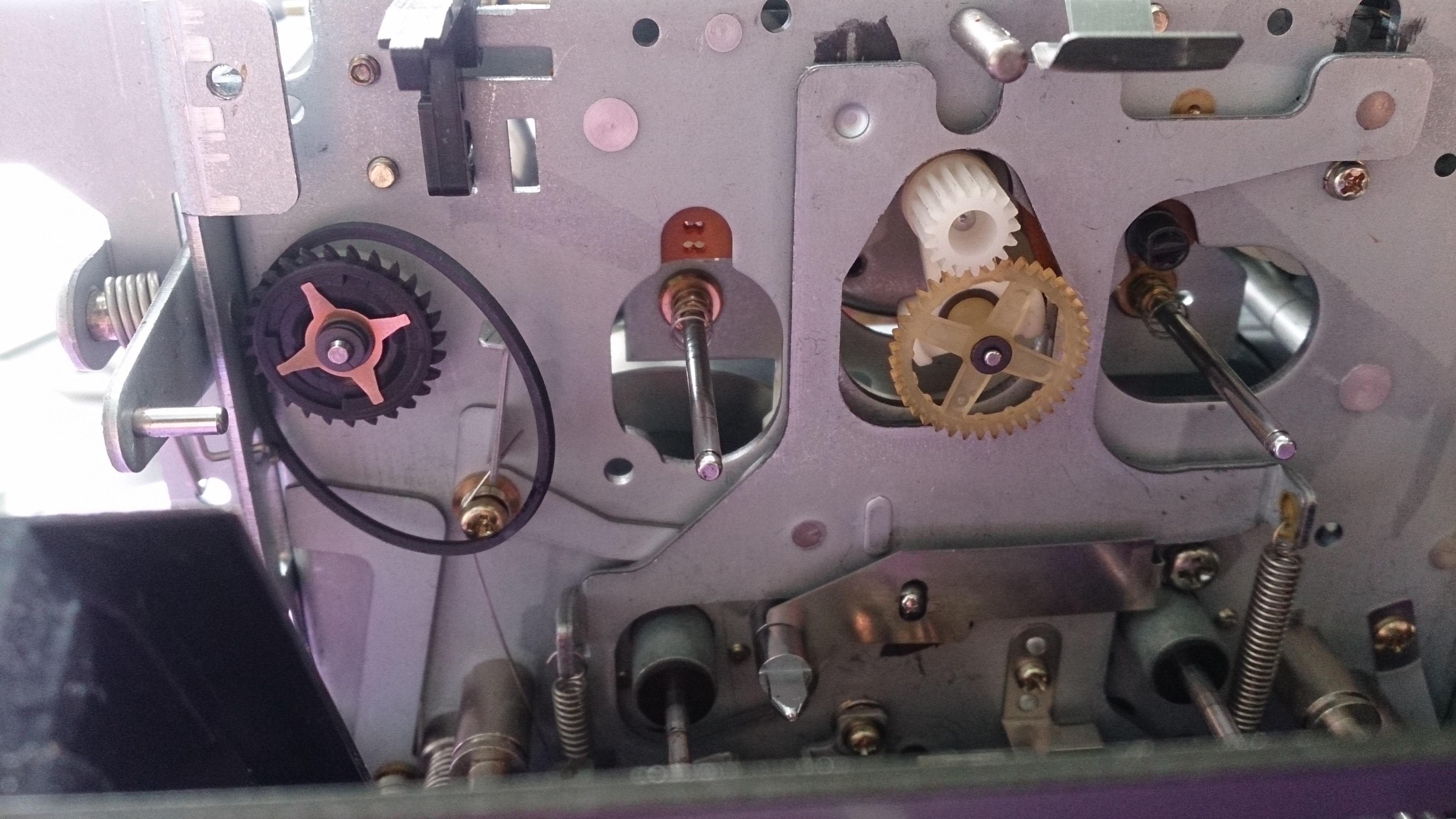

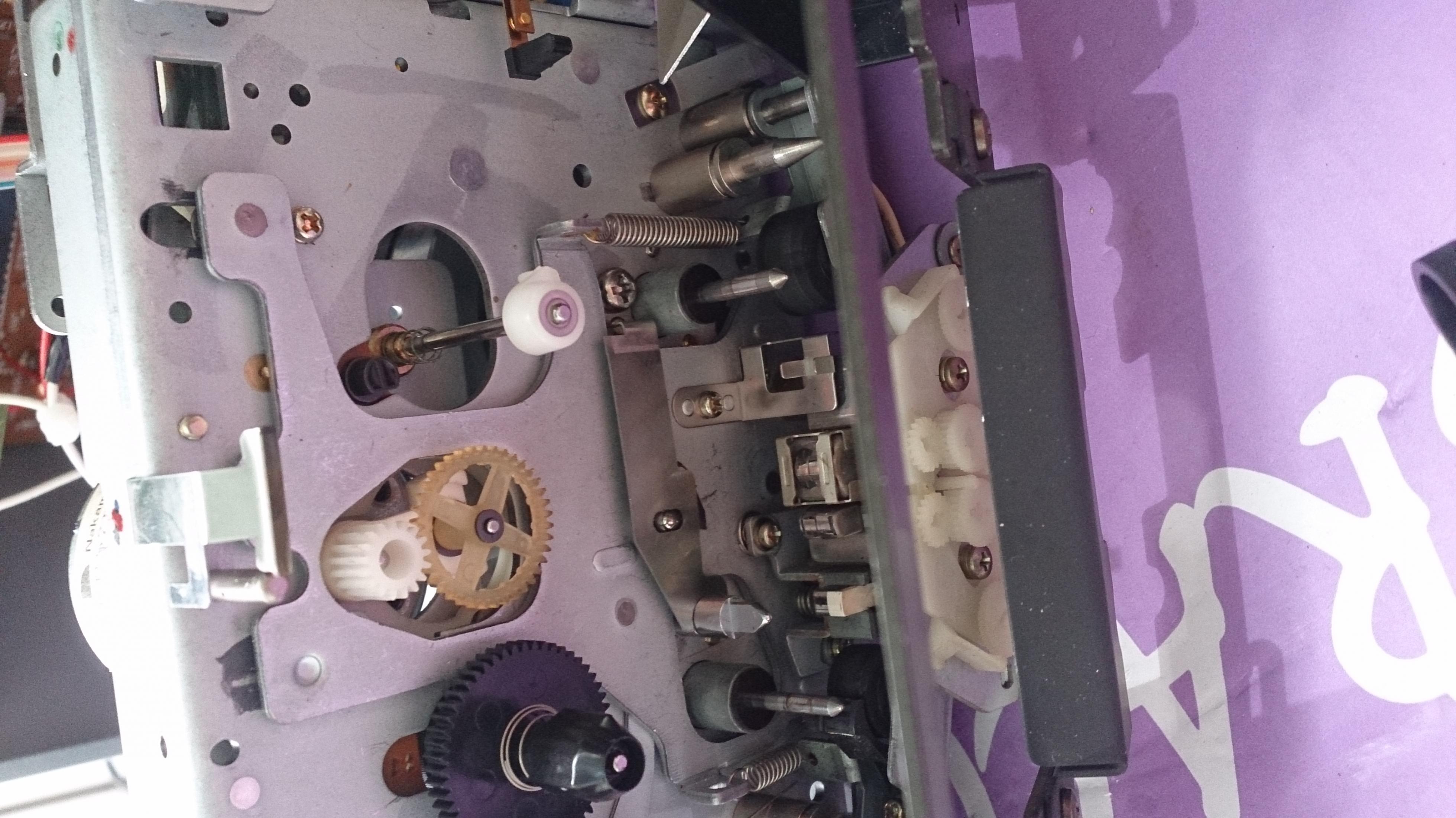

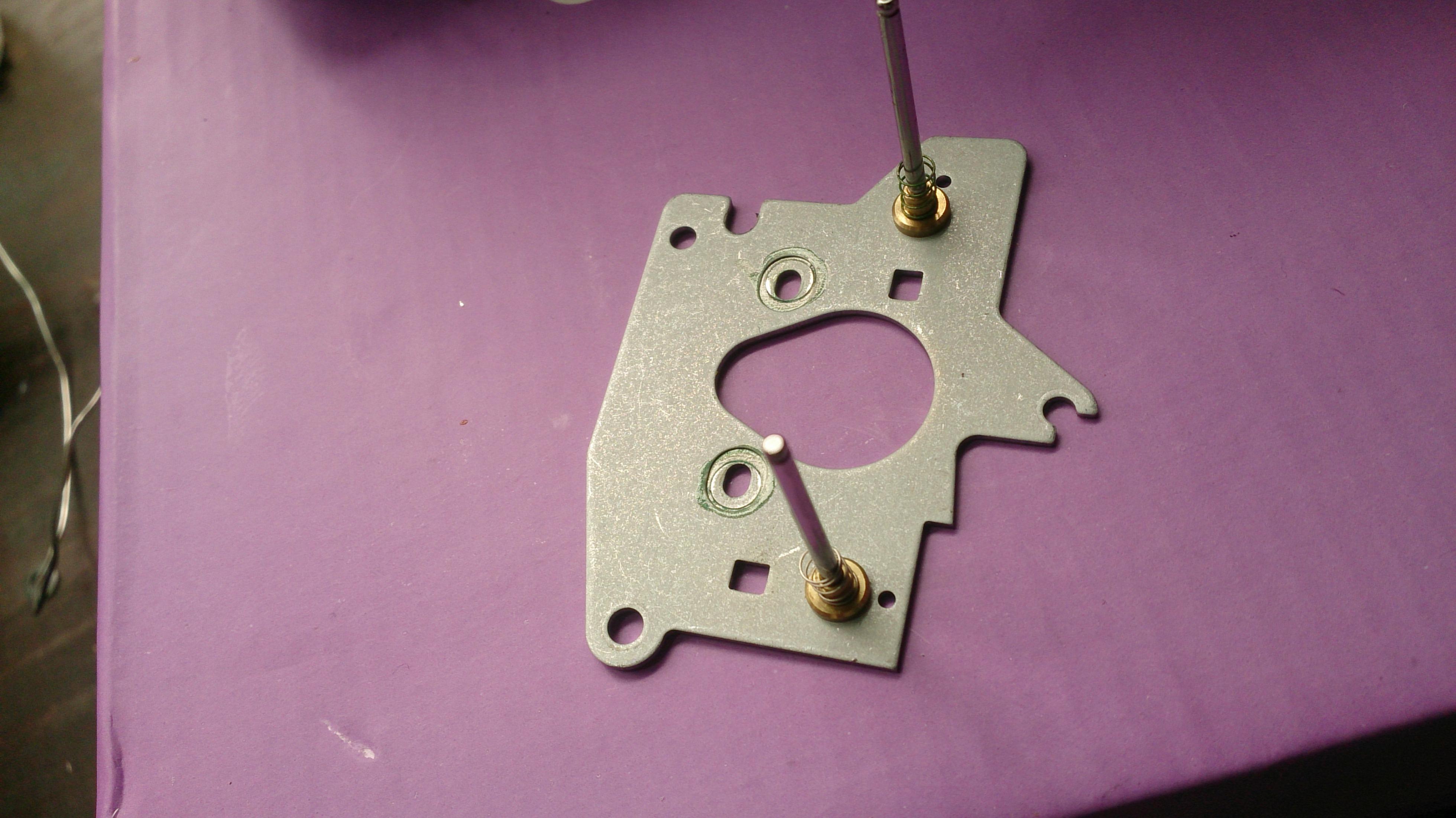

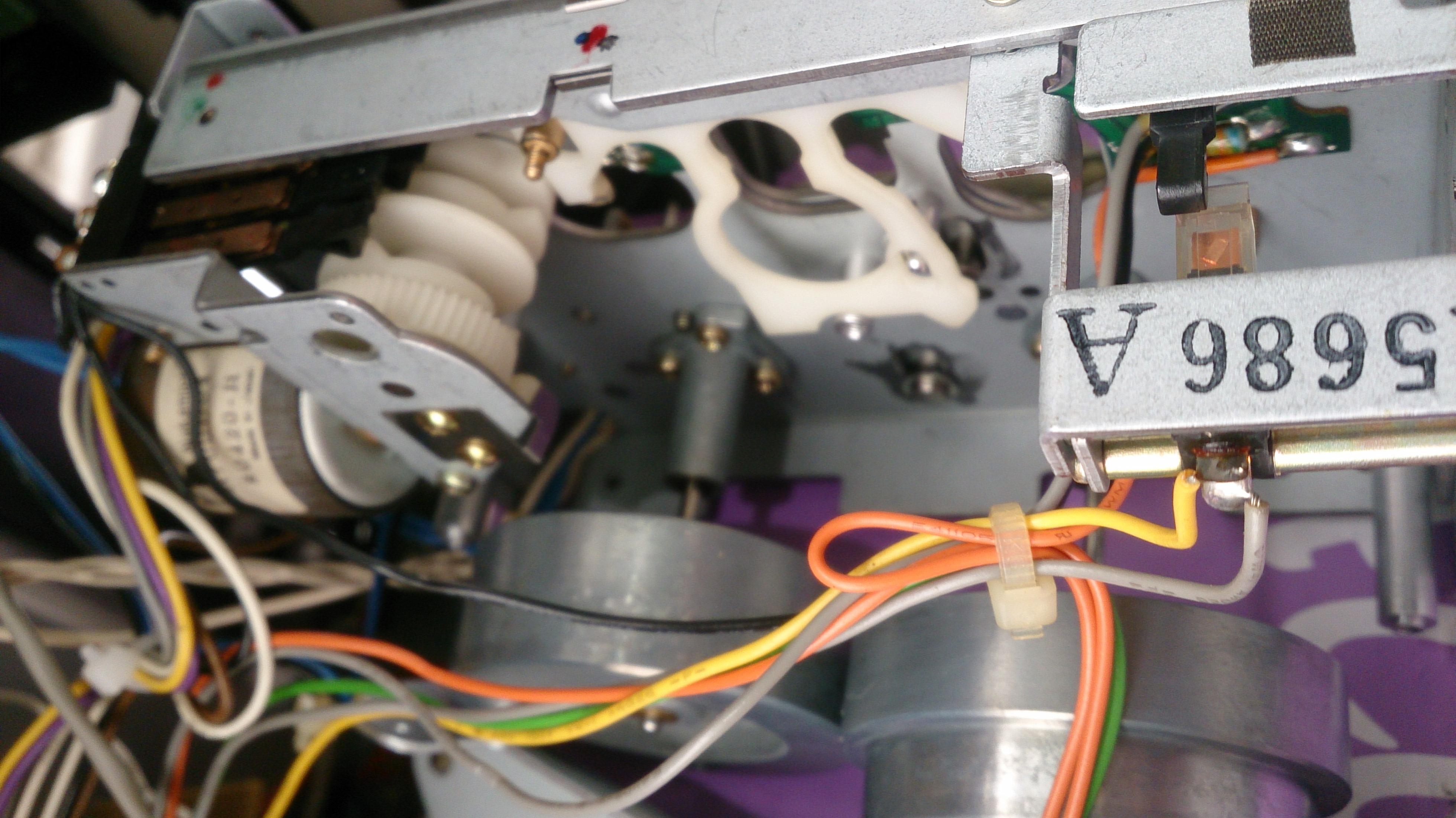

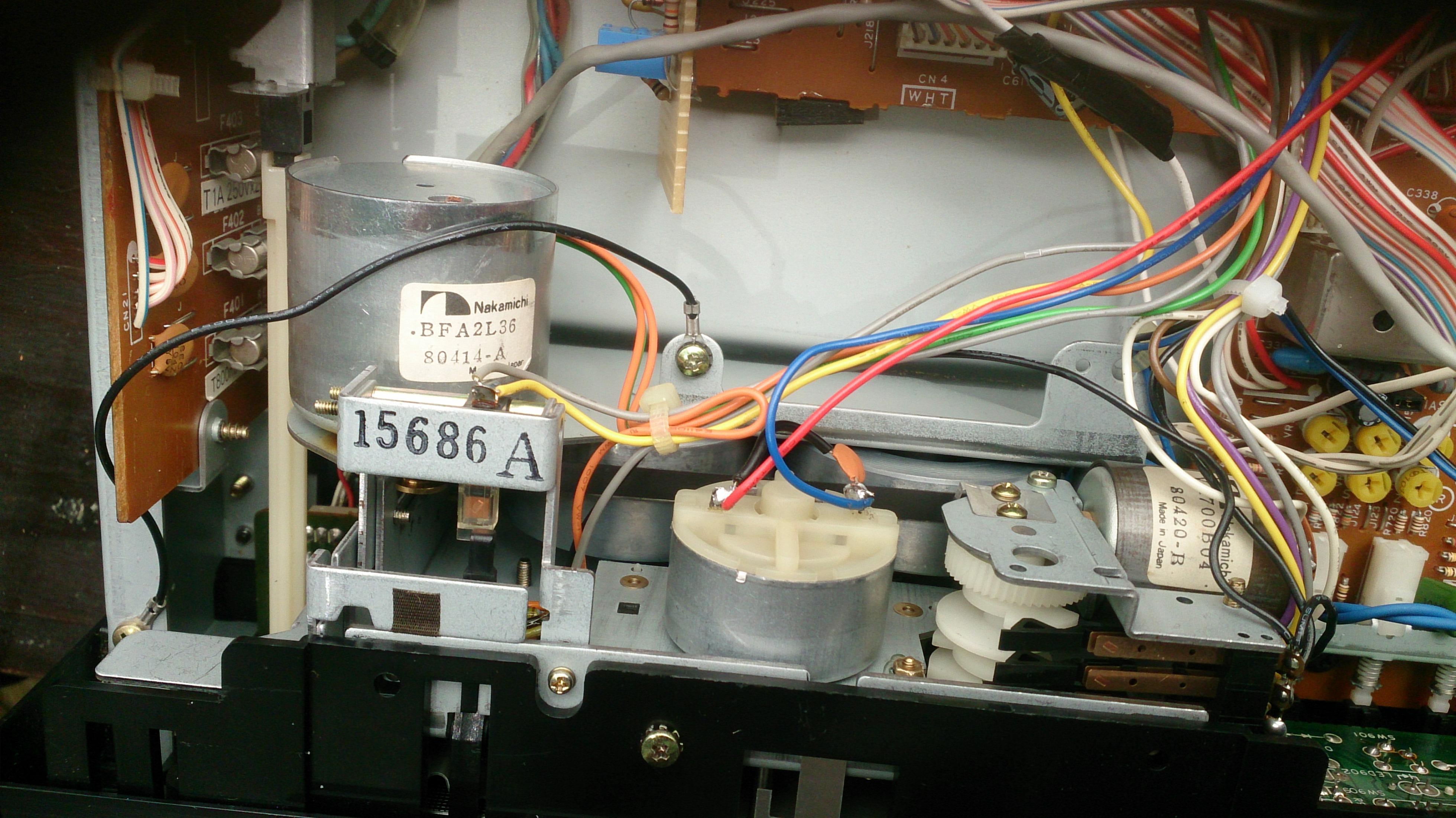

Well, a quick update to this: the motor continued on its unavoidable path to motor-heaven, starting to stall every now and then if not used for some time (and I already had done a second rebuild)... so I decided to get a substitute on ebay, after some research and asking for advice on tapeheads forum, I ordered a couple of RF-500TB-12560. As they are cheap, I figured it would be good to have one extra spare in case they won't be available anymore twenty years from now (yes, I sometimes think about the future haha).
Wasn't very easy to substitute, especially those small plastic washers (is this how you call them?) which hold the two reel hubs. I managed to get them off and back on, later, but I figure that without the proper tools they wouldn't survive this operation more than twice. I'm glad this was the first time for them. Then, it was also difficult to remove the gear from the original motor, had some very bad luck as it suddenly took off, making the tool pierce my finger 😱 (quite bad, but no ambulance needed, though, lol :mummy:) and make the gear and all piece jump far away (spent about ten minutes on the floor looking for them, found all except for the spring, which I managed to remake from another spring I had somewhere). Hadn't seen that coming... But in the end all went well, new motor installed and running nicely, never had any more tapes stalling, my pwm controller was easily adjusted to good torque by common sense and ear (I set it to minimum torque that would not cause the most difficult tapes to stall when starting close to the end), sound improved again quite a bit (which kind of surprised me) and there's one not so perfect change, though: rewind and forward is about 1/4 of speed as before, seems this is not a perfect electrical match (though it's a perfect mechanical match - shaft length is optimal and the mounting holes wasn't a problem, either) - possibly they sold me motors with wrong voltage rating. But I don't mind, I can wait, what I need is perfect playback and that is possible now. Checked the playback of 400 Hz test tone and got a really good result. Attached is a pic.
So, in the end this seems to close this long story - lesson learned: when the motor's dying, it will die, a rebuild will only be a temporary fix. Now I'm glad I did come up with this crazy PWM controller, as the new motor probably wouldn't have run at all with the original controller with its hard to find problem. Also, this can make the motor have a longer life, as it is running a higher voltage, closer to its specs.
