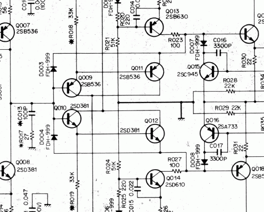

The right channel on a Nakamichi 620 amp I bought off EBay keeps burning out (it was advertised as such when I purchased it). My repair technician replaced the transistors once, it ran find for a few days, then burned out again. He's not an authorized Nakamichi serviceman, but he's been reliable over the years I've known him.
It's been suggested that the amp needs rebiasing when repairs are made to it. Hence, the help I need:
Can anyone provide me instructions for doing this? I need the bias settings, calibration method, where to measure, instruments needed, i.e., generally, how to go about getting this done: written instructions that I can pass on to my technican. I have a 620 service manual with schematics for all of the modules, including the output module, that I can provide if that helps. It does mention biasing in terms of measuring distortion levels but that's about it.

If we are to assume that you would set the bias in a more conventional way, such as deciding on a reasonable idle current and measuring that current across emitter resistors, then any advice would hinge on the value of those emitter resistors.
A glance at the topology of the output stage would be very telling. Scan & post it.
Edit: Found a schematic online. Looks like 0.22 ohm resistors, with a 4.7 ohm in parallel (what for?)
Anyway, I have no idea what Nakamichi thought was a good bias current, but if you want to stop blowing it up, connect the positive lead of your meter to the output NPN emitter, and the negative lead to the emittter of the PNP output. Adjust the bias so the meter reads about 21mV, which will result in about 50mA of current flow.
I also noticed that the amp supposedly uses 2SD555's and 2SB600 output transistors. If your tech is buying transistors with these numbers, there's about a 99% chance that he's buying crap Chinese counterfeit parts. Buy some new On-Semi MJ21193 and MJ21194 transistors from a reliable source, such as Digikey or Mouser, and quit trying to source out-of-production Japanese parts.

Could it be some kind of copensation if the 0.22 5W resistors are wirewound ?

I design and build my own amps and the method I use is:
1/ Connect amp to a speaker.
2/ Turn the bias down as far as it will go.
3/ Apply 1 volt sine wave to input
4/ Monitor output on scope.
5/ Turn bias voltage up slowly until crossover distortion goes.
This method has the advantage that it adapts to different output transistors sets and sets the bias just enough to get rid of distortion without dumping heat into the heatsink unnecasarily.
Works for me every time......

On most amps with global feedback, this is not possible. The input stage will attempt to correct and nicely 'cover up' the crossover distortion. You'll never see it.
EchoWars said:On most amps with global feedback, this is not possible. The input stage will attempt to correct and nicely 'cover up' the crossover distortion. You'll never see it.
My amps all use global feedback and crossover distortion shows up very well on my scope with low bias.
Howeve,r you must make sure a speaker is connected for this to work.
Unreliable method. He's asking here because the amp has apparently blown up more than once. I'm of the understanding that he's tired of repairing it.

This one, seems to me that has automatic control
Nothing to do with this amplifier... an almost perfect design..this one, made to listen to... and only.
Nothing to adjust i think.
Maybe i am wrong..but what i see is automatic.
This one is a hell creative design....bias is modulated by audio... send it to highly skilled people, alike Anatech.
Avoid even touching this wonderful machine ... This would be like to profane a temple.

Hi Dr. Mac,
I just happened to see this thread, so my information may be too late.
You have a really nice amplifier, or at least it was at one time. There is no way to easily adjust the bias current. It is set by the Vbe drops in the output stage. This is something I call a "power diamond buffer", for want of a better explanation.
There are no special parts beyond the transistors used originally, so that means you will have to substitute wisely. If there are "NTE" or "ECG" transistors in there, it will not work.
The normal Nakamichi service network should be able to restore you amplifier to good running condition. As it sits now, you may cause further damage running it.
This design is not something I would suggest skimping money on. You will end up repairing it until the PCB is no longer reliable. Dead amp for a few bucks. 🙄
If your technician doesn't understand this design, get it to someone who does.

The number of good TO-3 transistors on the market now is pretty slim, and virtually all of them are made by On-Semi. My suggestion is in Post #2, and I'd be surprised if Chris has something different in mind (except maybe the MJ21195/96 or one of the old MJ1502x classics).
These transistors are commonly counterfeited too, which is why it is important to buy them from a vendor who sources them directly from On-Semi.

The orignal 2SD555's and 2SB600's were NEC and are long discontinued. If anyone else is making transistors with these numbers, they are counterfeit by definition and not to be trusted.
While there may be NOS transistors out there, it is difficult to tell these devices from a market which is flooded with Chinese counterfeits. I don't have the time or the financial resources to sort through them to find the good and bad ones, and neither do most other DIY techs. Your chances of buying a useless counterfeit device is 100x higher than actually finding a NOS original device. So why play that game? Buy a new device from a reliable source, and be done with it.

I would normally go for current Japanese, or On Semi. The 2SD424 and 2SB554 will work as substitutes I think. The Vbe is important in setting the bias current. Also, check the drivers.
If your technician can not find known good Japanese transistors, then On Semi is much better than some things you could grab. There is one other avenue available for you in extreme circumstances. Find an older unit that uses the same parts and reuse the ones from the good channel. The parts in a channel that has failed should be considered bad parts, even if they test good. Remember, this is a last resort. Do this only when you need those exact parts and they are no longer available.
I am very concerned that your tech does not understand this amplifier at all. Its not something you want to learn on for one. The simplicity belies the finesse of the circuitry. You have to be exactly correct in order to have it work properly.
