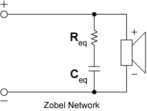

Naim claims Class AB amplifiers, which typically use Zobel networks at the output for stabilization.
Add one across speaker terminals, any change?
Typical values are 0.1uF ceramic + 10 ohm 0.5 or 1W resistor.

Thanks for your reply, Juan. The zobel components were the first thing I checked (not easy, this thing is a layercake construction). I'm fishing for someone who has "been there and done that". There's nothing special about the poweramp, it is just sandwiched amongst a pile of digital fruit. Waiting to see what Naim have to say as the problem appears to be endenic (lots of hotties). Tried all sorts of loads - 8,600,open - no difference.

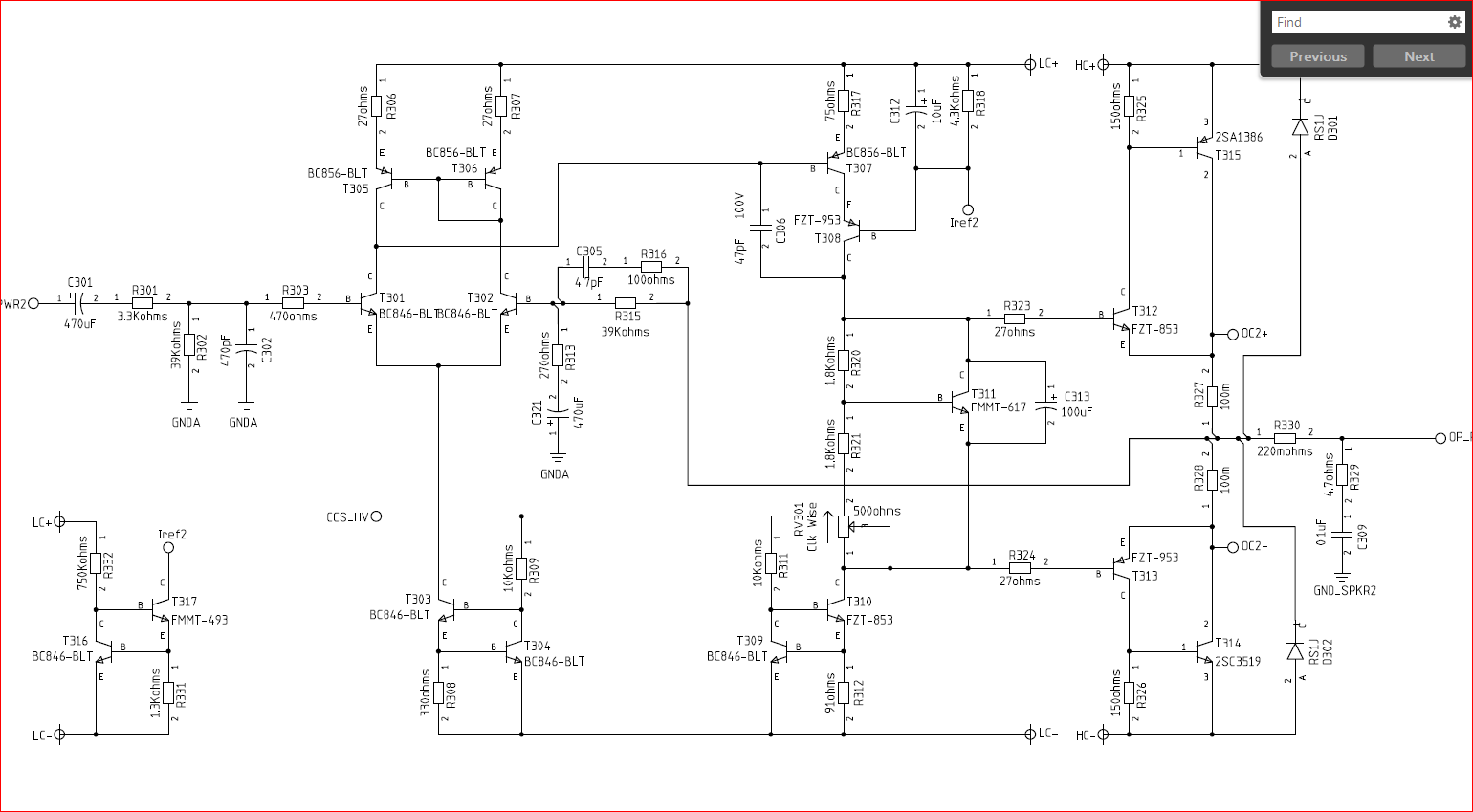

Try to find some comparable Naim amp schematic (say, between 30 and 60 W RMS or so) and post it here, all I found was a "250" which to boot required registering.
A schematic for the more recent Nait 5i was attached earlier. Here it is again, since it's rated at 50WPC, as I recall, but features other standard textbook style refinements too, as does everything since 2000.
