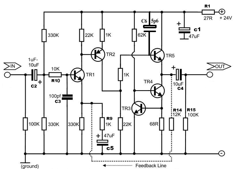

Hello. i was wondering whether i could lower the gain of this preamp by changing the resistor values of one of feedback resistors.With the original values of R14=12K and R9=1K ,the gain is 22dB. By changing R9 to 4.7K the gain is about 10dB.
But is there going to be any stability problem?
