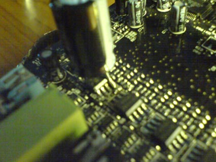

All opamps sound better with additional decoupling on-situ (right on top of the opamp). I use Rubycon ZA 220uf/35V soldered directly on the rail legs with great results (sense of power reserve, openness and so on).

- rail (cap) + rail. Well, I use a quality cap here of over 47uf making sure that the rating exceeds both rails combined (usually 30V hence my Rubycon ZA 220uf/35V). Just make sure you orient the - stripe to the neg rail...
See attached pic... and yes, that's a changed LM49720 on a sound blaster 24 bit card (sounds really decent with changed caps) (sorry but that's what I had at hand at the office).
I'd like to know what others think of this mod for OPAs, I find it VERY worthwile.

Hi, I'm intrigued by this. You are not adding extra decoupling to each supply pin BUT bridging the 2 supply pins with a large polarised cap ? How does this work ? I have seen this topology on a Rotel schematic elsewhere in this forum, though it was a small plastic cap and hence bipolar. I'm wondering if this might work with a 5534 IV & output stage on my old CD104. Thanks
I too am puzzled by this. Decoupling the rails I can understand but not with an electrolytic. For analog you'd normally decouple the rails with something like a 100nF film cap - you want something with good HF properties not a large electrolytic.
Putting a seperate electrolytic between each supply and ground risks coupling noise from the supply into the ground which you don't want to do although you do obvious need enough storage to support the rails so you have to reach a compromise on this.

but why couple the +ve and -ve supplies together at all ? Surely they should be independent
Try it, it sounds really good. Dual opamps have no ground connection of their own and they can be operated very well using a single supply (in which case you should use signal coupling caps). So basically what I'm doing here is providing a power reserve and also making sure that we have the same noise in both rails (maybe common mode rejection gets better or???).
Can't really explain why it sounds REALLY good, but it does.
