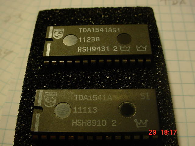

I hope it wasn't an S1 double crown TDA1541A you removed? Might be wise reinstating it if you trace the problem to elsewhere.
Yes is was the S1 double crown.

Hi David
Here you are:
/JJ
