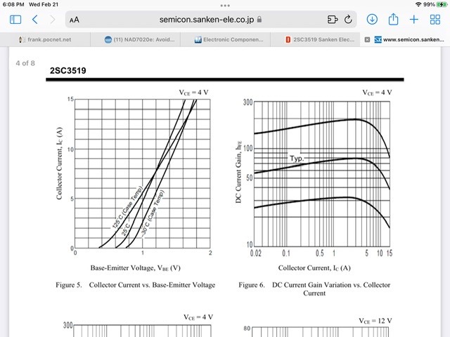

Look at the Vbe/Ic curves. They go linear at high currents. What does that tell you about the construction? (Also the R has a positive temperature coefficient).
The LAPT type can often be used without external emitter resistors. At relatively low Vce - dont try this on +/-80V rails where you need to parallel a bunch of them.
Even the original 2N3055 is a relatively big device for the application. I’ve seen many many many receivers from the 80’s and 90’s using 2SD525/B595 on the same +/-30 volt rails. They wouldn’t do 4 ohms, of course - and not at all without emitter resistors.

I appreciated the detailed response. This is above my level of comprehension, I can only surmise that you are highlighting the dangers of blind transistor substitutions. I'll take a stab at disseminating what you're saying.
I'm guessing that you are pointing to some aspect of thermal stability here. The linearity at higher currents is indicating that the current increase (delta-I) for a given voltage change (delta-V) at relatively lower Vbe/Ic level has increased at higher levels, ie. at higher levels of Vbe/Ic , the given voltage change (delta-V) is associated with a larger delta-I. I assume meansrelatively more heat and then more thermal instability risk (? because there is no asymptotic/convergence behavior).
I know nothing about what this implies about the construction.
For someone at my level of knowledge, it's probably best to stick with the 3055/2955 combo and add resistors to fix the amplifier. I'll come back when I encounter more hurdles.

The Sanken LAPTs have a small parasitic resistance due to internal ballasting of the multiple cells. Better thermal stability than types which do not have it. The old hometaxial 3055 had excess bulk base resistance, but that was just because it was a POS. When modern types “improved” this, they became less thermally stable. When making good rugged fast transistors, the best way to do it is with multiple parallel cells on one die - or at the very least, multiple emitter fingers. This requires base and/or emitter “resistors” internally. They are just an order of magnitude less R than you normally see in an amplifier. But make no mistake- they are still there. RCA experimented with it early on, and the result was things like the 2N5240. Sanken does it with their epitaxial planar process, Toshiba does it with their triple diffused. Both are the kings of their respective hills.
The internal R values (between .01 and .05 ohm) are not high enough to run without emitter resistors in circuit at elevated Vce or when paralleling multiple units which may not see absolutely identical thermal resistance. But at sufficiently low Vce you can get away with it. Personslly, I think +/-30 is a bit high to get away with it, but at 15 or 20 you absolutely can.
If you are using 2N3055’s (or MJ15003’s) just add 0.1 ohm emitter resistors, or 2.2 to 4.7 ohm base resistors and call it good. I’d still do that with LAPTs, and never worry about it running away.
