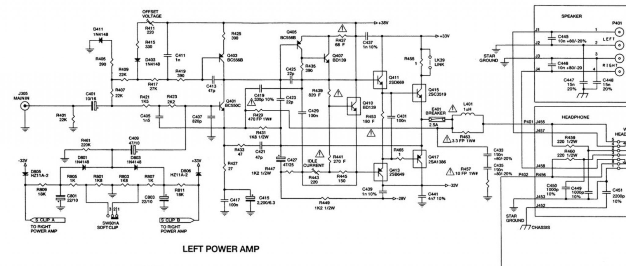

Hello All,
I've got problems to my NAD312 amplifier.
I felt that the sound of 2 channels are not the same level.
The amplifier have the U-bridge at backside (pre-out to Main). I am using 1 Khz sine tone generate to Aux and measured the level from pre-out are same to left and right . Then i think pre-out stage is ok.
From the power stage: can someone help me:
What is the correct bias to the R455 (1 Ohm) on the schema?
I measured (the amplifier using 0.1R , not 1R as show on schema), and Left channel is 0.3mVdc, Right channel is 0.6mVdc.
