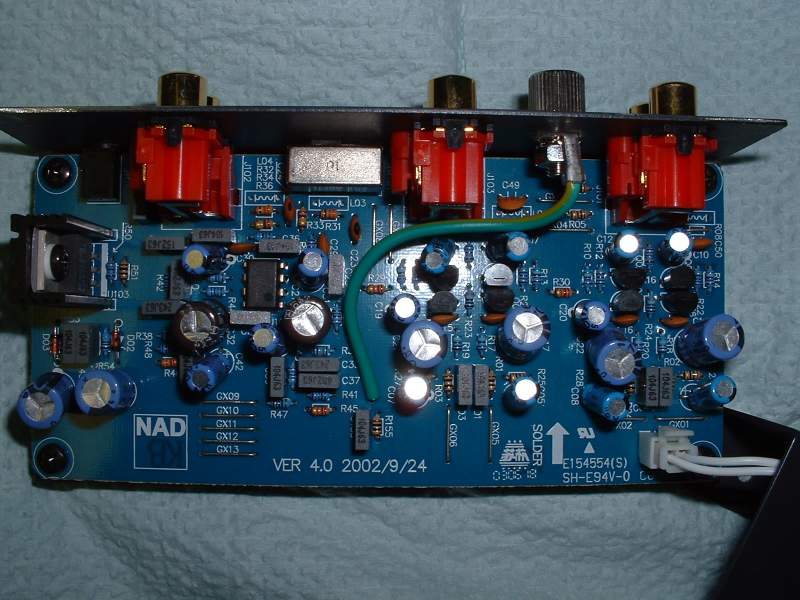

This is the inside. Pretty neat for such an inexpensive preamp. Already, for the price, it seems to be a bargain.😎
Very well built, metal film resistors, low noise transistors. Good quality, gold plated connectors, good, small casing. MM and MC separate inputs. Good specs. Difficult to beat even by diy.
If it is worth it, I plan to replace the cheap electrolytic caps inside with some Panasonic FC that I have in stock, can't hurt I guest.

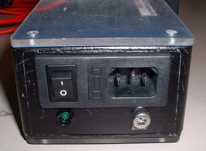

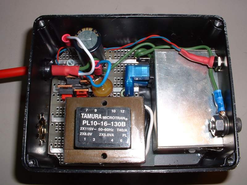

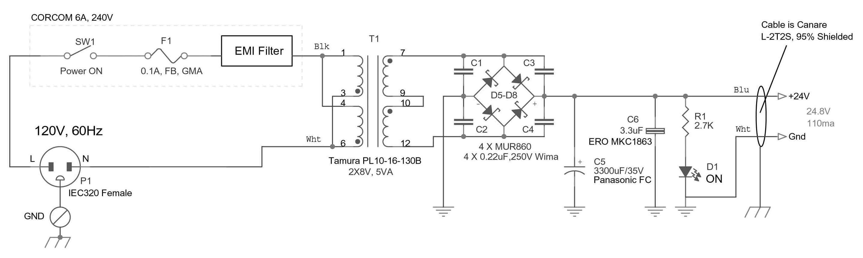

Anyway, I had all the necessary parts in stock (from previous projects) to build an 24V upgrade power supply. It took a few hours and there it is.
It is using an EMI filter, soft recovery diodes bridges with Wima snubber caps and a nice Panasonic FC 3300uf, bypassed with an 3.3 uf ERO cap. The cheap plastic power cable is now replaced with a nice length of Canare L-2T2S, twisted copper pair, 95% shielded with copper braid. The AC socket can now accept better power cord.
This little supply provides at the input of the preamp 23.8Vdc, 62mvac of ripple and now the output of the regulator is much quietter at 20.1Vdc and less than 0.5mv ac of ripple!
As I said, the parts are probably not optimal, the transfo can be bigger, can have more filtering caps, etc, but they were in stock, and I can do a quick check and see if I get improvements.

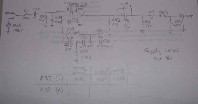

Henkel I got your answer. The gain is set by R37 (Left Channel), and R28 (Right). The default value is 249R, gain of about 34dB
If you parallel a resistor of this value with R37 or R38 you'll have these gains:
R38 or R37 // 220R = Gain 40dB
// 100R = Gain 45dB
You should use metal film 1% resistor, otherwise you can have left and right gain missmatch.
Solder the resistor on the bottom of the PCB, much easier.
Try that and let me know.
The image is showing where R37 and 38 are located.
Have fun.

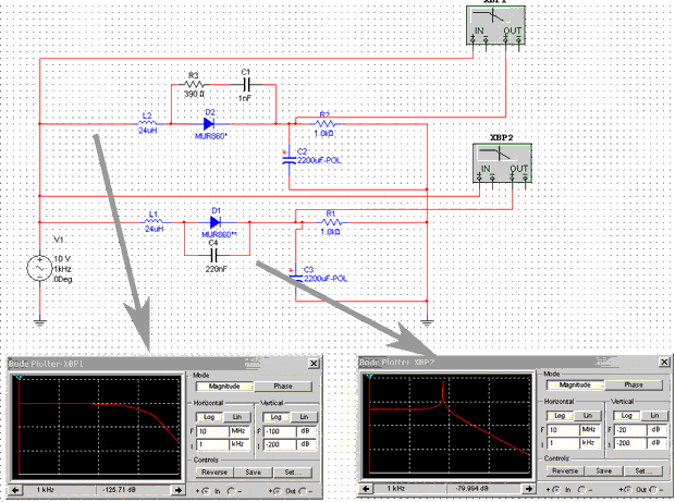

the predecessor, the PP-1, was reviewed by Gary Galo in Audio Electronics 3-2000. He pointed out a couple egregious errors in the design (some were pretty glaring) which have hopefully been corrected in the PP-2. One of the designers responded to the critiques, but it was pretty lame.
One thing of note in your power supply -- the capacitors across the diodes just lower the ringing frequency -- possibly bringing it down into the "hearable" region -- remember that the secondary inductance and the diode capacitance form a resonant circuit. This actually becomes important in a low level gain stage like a phono preamp -- you can demonstrate the ringing in LTSpice.
MUR860's have a capacitance of around 130pf at 24V -- try using a 390 ohm resistor in series with a 1nF capacitor --
