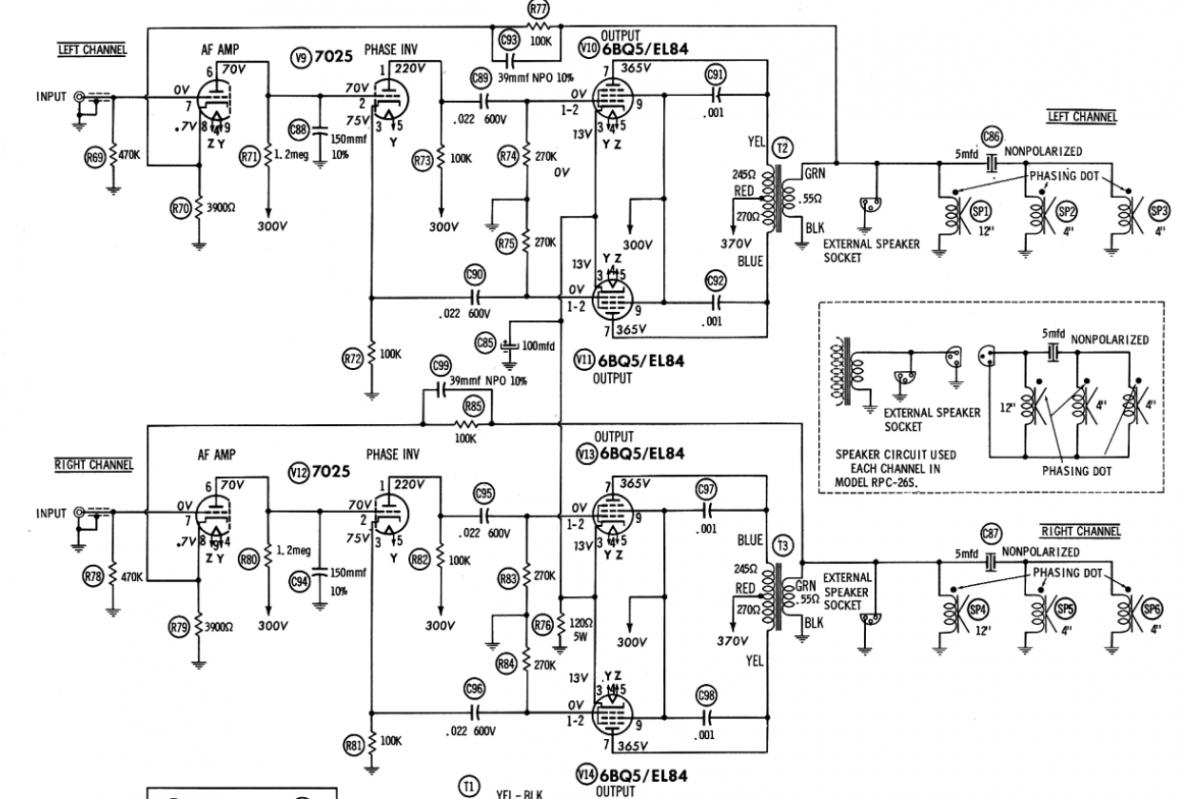

1: I'm not reading a vdrop from pin-8 on the rectifier to the plate of two of the tubes. On the two tubes that I do get a reading on, I see a power dissipation of 10 & 11 watts, which seems extremely high... I kind of expected 6-7 watts. I checked the 120ohm/5w/10% cathode bias resistor and it's reading 129ohm. Everything looks right except the dissipation.
Am I measuring incorrectly, or am I somehow seeing the vdrop for both tubes on the plate of a single? I had assumed that each side was like a push/pull guitar amp + negative feedback.

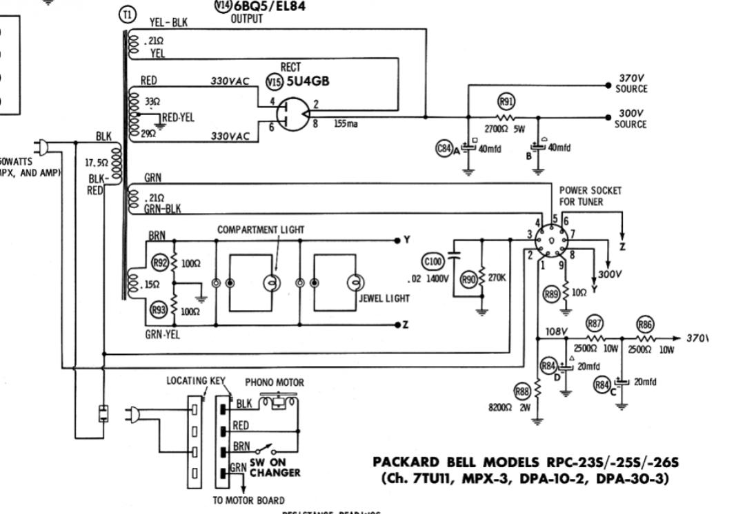

I've attached a very close schem (DPA-30-rev3) in case anyone needs it.

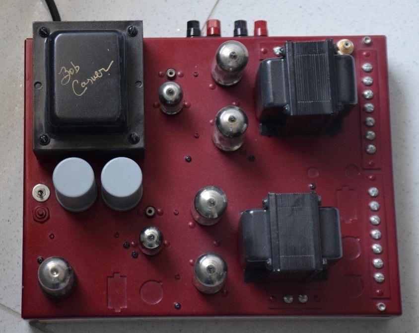

This is the kind of amplifier, or one very similar to it, that Bob Carver (audioshopper on eBay) would buy there. Do a little work on it along with a sloppy fire engine red paint job and sell it on eBay. He'd hype it up big time like only Carver can, even invoking Stewart Hegeman's name to intimate he had something to do with it, and then get stupid money for it from gullible buyers. I witnessed this at least twice on eBay several years ago. Now I'm not saying the amp isn't good when fixed up. Only that there's nothing special about it, even from BC.
I remember those! I always thought it weird how arbitrarily some parts were removed for painting and others were not. I also found it slightly disturbing that those phenolic terminal strips at (what I assume to be) the outputs were covered in metallic paint. Not to diss his efforts, but considering the source I expected a bit more class - even if only in the form of masking tape. 😛
