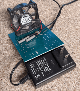

I did not notice that the NAD 3045 had no ventilation when I purchased it new and set it up in the vertical orientation. However, when I recently changed to horizontal, I noticed the NAD etched metal "badge" was hot to touch. When I put a small, brushless 12vdc fan between the cables behind the unit, the case cover cooled down to 28C.

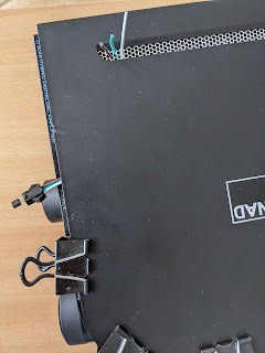

The case cover is difficult to remove but I pried it open enough to insert an DS18B20 1-wire sensor for temperature measurement vertical/horizontal, with/without fan.

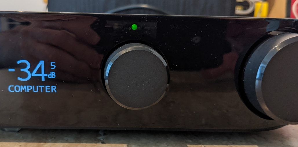

Since the D3045 power status is poorly placed, I installed a green LED on the front to show on/off state.

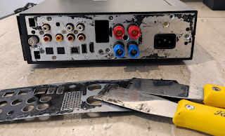

Opening the case was difficult as can be seen here:- Unbar The Foo The retaining screws on the back panel are hidden by a cover plate stuck on with a tarry substance.

The NAD D 3045 Hybrid DAC Amplifier is very compact so the controls and indicators are minimal. There is a temporary indication of audio volume and source when power is applied. Nothing is indicated when the 3045 continues operating except the amber/white power status which is poorly located on the top or side (vertical/horizontal and barely visible in daylight. I added a LED inside and above the source knob which is green when the amplifier is active.
The glossy plastic is mostly transparent. There is a layer of dark material applied inside to block unwanted light. However there happens to be blank spot above the source knob and that is where I installed the green LED.

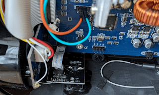

The LED needs a power-on signal. Without a schematic, I found no test point that could be tapped. But there happens to be a transistor power enable on the power-on touch board seen here in the lower left corner of the upside down 3045. I carefully soldered a 30 awg solid wire (white) which will activate the LED.
The green LED and related components are soldered on a PCB fragment which is tacked to the top of the source selector using glue gun thermal glue. In addition to the power-on signal, which needs to be buffered by (R2), the PCB needs 3v3s (orange to D1) and gnd (green) from the mainboard header.

Now we open the case. Notice there are rectangular tabs around the inside edge which are to be caught by tiny fingers on the top cover. I pried the cover partially open with a spackling tool to feed in a temperature sensor. That was a temporary task to measure the operating temperature (52C). An external fan is needed because heat is the enemy of semiconductor electronics.
Removing the cover completely is difficult because the means of attachment are invisible. For example, the blue analogue input module is screwed to the top cover and also to the rear metal panel (light grey) which is covered by a thin black metal plate which has the connector labels. The black plate has three screws to align it but it hides six more that prevent opening the case.
The two plates are joined by a sticky, tarry substance. Separating these two requires intuition and determination. But after the internal work is done, it can all be assembled without apparent damage.

There is internal space where a fan could be installed in the D3045 but that would require drilling holes in the glossy plastic. Instead a fan placed behind the unit will lower the internal temperature and keep the cover near ambient. I attached the fan to a spare pcb to prevent it from tipping over when positioned between the wires.
