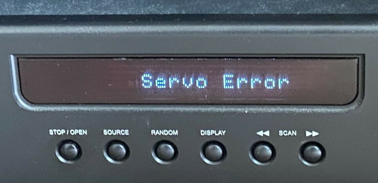

I picked up a NAD C546BEE CD player for cheap because it wasn't reading discs and the VFD just displayed SERVO ERROR. The door would open and close but the disc would not spin up and the laser head would not move.

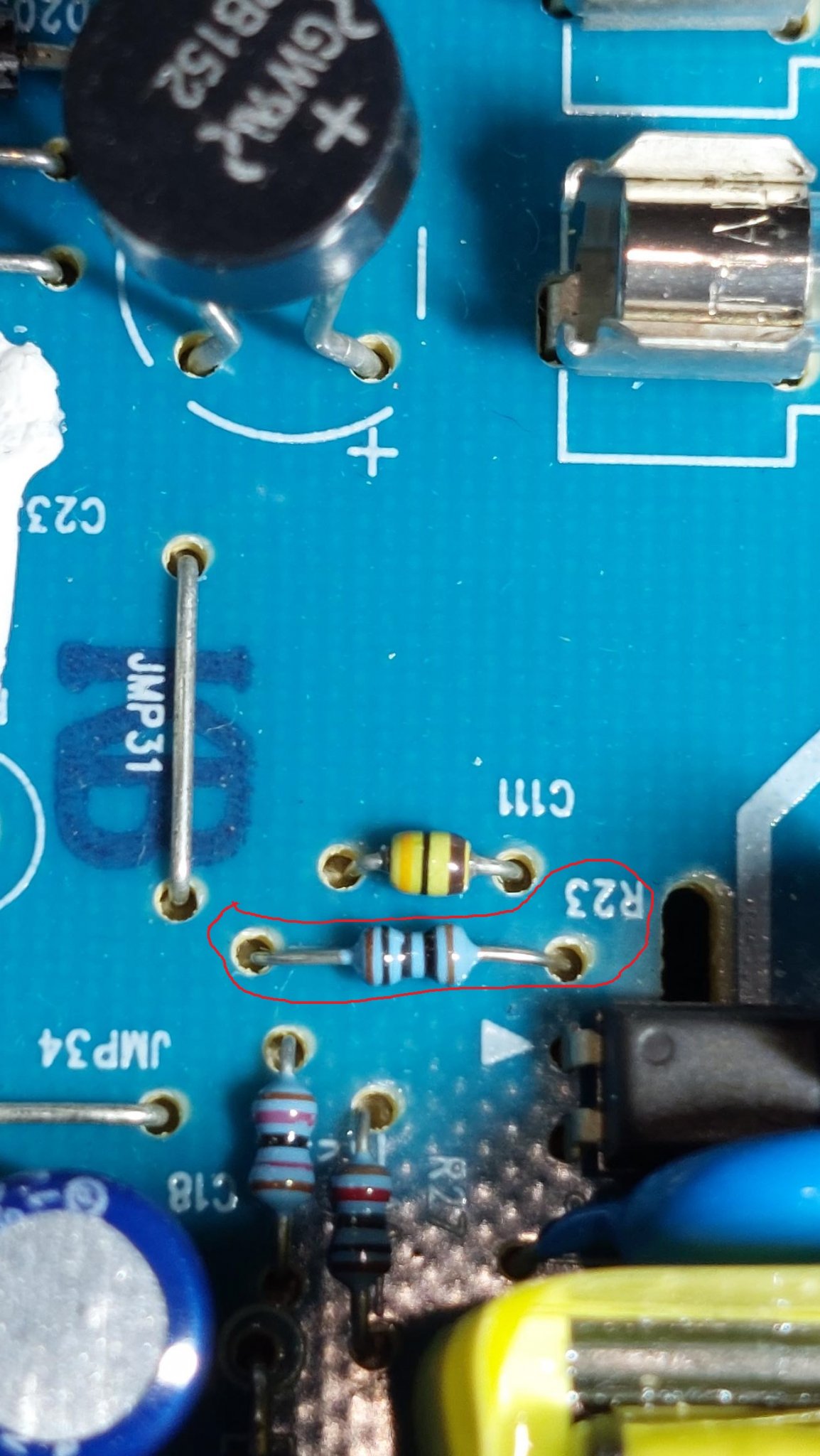

On the Servo Board there is a motor driver IC3 (MM1669XH) which has a "mostly" built in linear regulator; it just requires an external PNP transistor. This external transistor Q71 (2SB1457) has a 33 ohm resistor (R23) on the emitter. The collector of Q71 is the output of the linear regulator and provides clean power for a few different +3.3V rails.
The problem is that R23 is an 0603 size surface mount resistor -- just way undersized for this application. It had burned up and failed open, and the three power rails which should have been +3.3V were hovering around 1V. I tacked in a 33 ohm 1/4W leaded part and we're back in business.

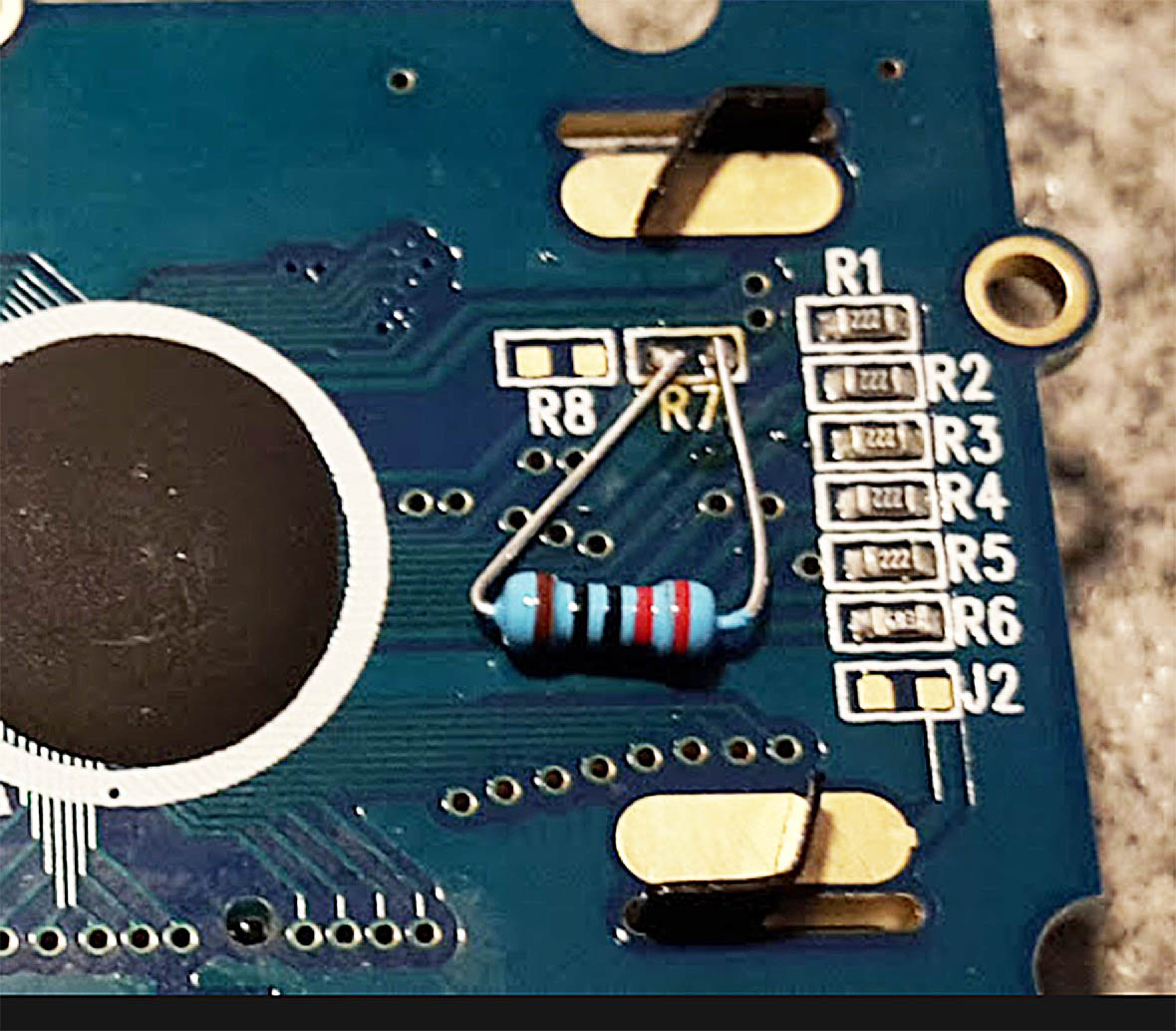

My question:
Duc say you replaced the resistor. But that is not so simple in purely practical terms. Did you drill 2 holes in the tracks and then solder the new resistor - or how did you do it?
Thank you very much for an answer.
o my God, thank you very much for this absolut quick answer:
But the picture is so pixelated that I can't make anything out.
What did you do?
Did you just "solder over" the resistor?
What did you do?
Thank you for the quick reply.
I will try it out. It's worth the effort because I think the NAD 546BEE is absolutely fantastic.
