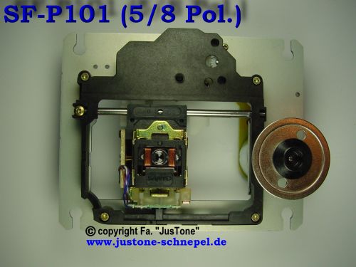

i have a nad c540 waiting to be repaired, indeed his transport is broken , what about his transport ( Sanyo) ?, where can i find it ?

I think I can help here,
The mechanism your CD player has is SANYO SF-P101N.
They come in two flavours: 15PIN version and 16PIN version. (just count the number of wires you ribbon cable has!). Otherwise, they are exactly the same and quite good! They are very sensitive to static discharge and come from the factory with a solder bulb that has to be removed once the unit is installed. Antistatic wrap must be used.
They are available from everywhere for around 20-30 euros.

Hello, Extreme_Boky
I have a defective spindle motor C540.
Is SF-P101N the code for the replacement part also in this case?
Thanks,
Call NAD for loading mechanism.
