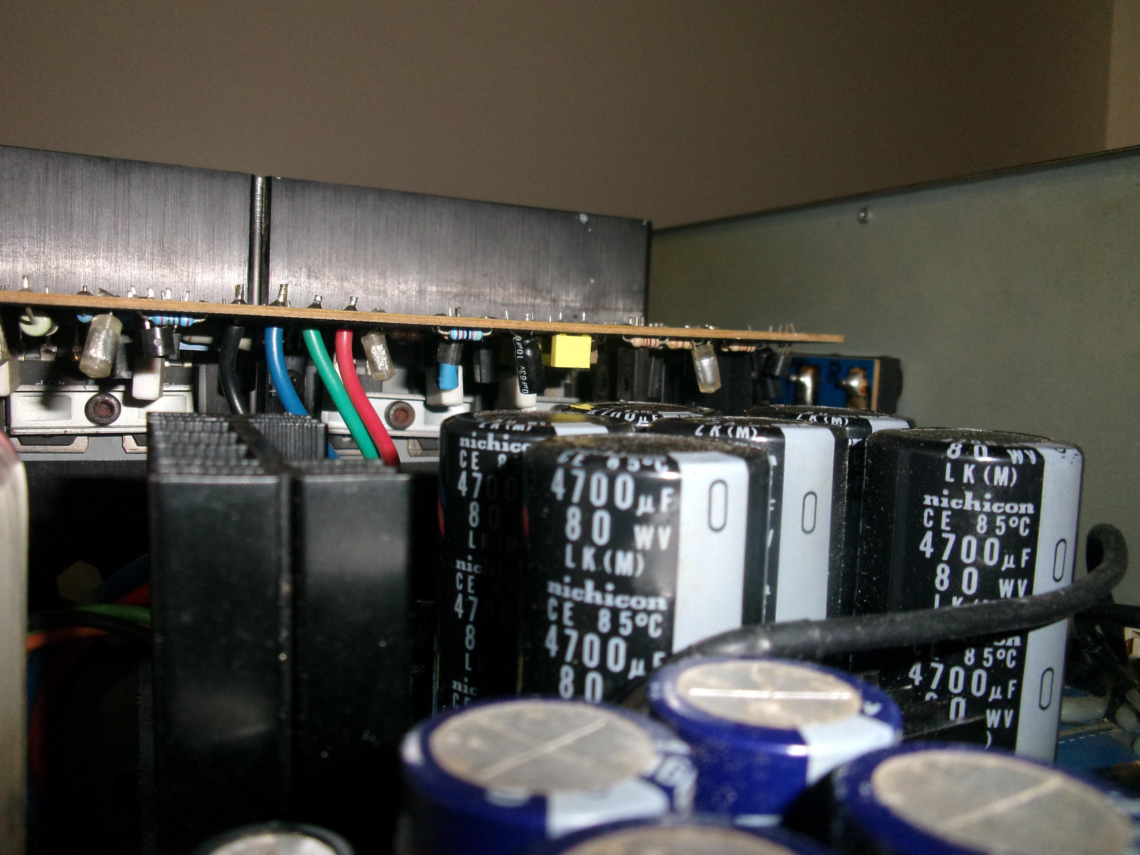

So here is the pic of the 15000uf caps. Not easy to give a clear impression, but as you can see one is bulging quite a lot, with a clear pointy top, the other just slightly rounded. And the one with the pointy top has come loose from the board, and been pushed up slightly it seems...as theres a small gap between it and the board.:

Hello Tommy72 the last photo you posted with the 2 caps on the back of the board one is a electrolytic and the other (is not a resistor) it is a ceramic capacitor and they both look stock check your schematics
If you dont have the schematics you can download the service manual here if you sign up for free NAD C320BEE - Manual - Stereo Integrated Amplifier - HiFi Engine
On the big electrolytic you posted a picture of on your #9 post comment look normal imo but one cant tell if there in specs without testing them with a ESR meter and a capacitor meter.
The brown gunk as you call it is most likely glue to hold them in place during the assembly of the amp
I have included a picture of my NAD 216 main cap's that look similar to the ones in your first picture on your #9 post comment and mine have been tested and are good
As far as the other picture on the #9 post comment the different color caps are maybe a different series from the same manufacture and are most likely ok.
