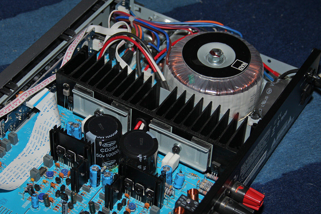

Just bought cheaply 3 year old NAD C350BEE for repair. It has problem witth the output volume. Even when volume is set to max, you can barely hear the sound. I only tested it with headphones and i noticed that only the left channel is working. When switching between audio sources the sound cracks loudly.
I started by making a visual check. It seems that 4 biggest capacitors has leaked, or NAD uses some type of glue undernearth capacitors? Tested all capacitors with meter but did not found any shortings.
Power LED is staying at RED so i think it has some protection circuit on?
Can someone give a hint what kind of errors can cause such symptons? I have been playing a little with electronics but never done anything with the amplifiers.
Thanks in advance
Samu

What you see under the capacitors is most likley glue. however i have seen many of these amplifiers and all needed a re cap. Replacing the caps will maybe fix your protection mode problem. Before changing the caps i would have a test around the output stage and check for shorted transistors .
Yes glue. A bit acidic too. Clean it up.

Because the electrolytic caps are partly close allocated to the heatsinks they are exposed to high thermal stress.
This devices I would replace in any case.

Maybe Bjorn did the layout, maybe he just did the circuit. Unless he is watching, we may never know. NAD takes quite a beating, and their older reliability history makes it somewhat justified, but they still provide decent performance for the price. In their price range, there is a lot of real trash. They at least try.
Do you have a variac? Makes this kind of work not quite as dramatic. (Kill the protection and bring it up slowly)
Expected life for an electro is 8 years IF they are not abused, like getting warm. 3 to 5, yeas? I can believe that!
I might be inclined to cut open the case bottom and top replacing the louvers with more open screen, and put slightly taller feet on it. After you get it working of course.
