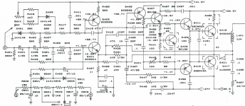

Hello, this is my first project since years. I am trying to repair a NAD 7020e receiver and need some help. The right channel of the amplifier is working well, the left channel measured -14V DC at the speaker output.

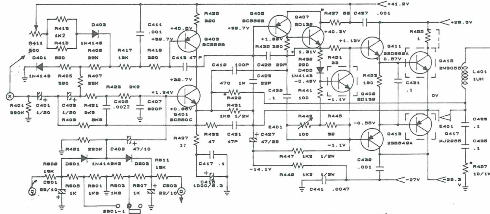

Q413 was BC shorted and no connection between B/C and the emitter. Resistors R437 and R451 were burned due to this. Also, C415 was leaking. I replaced Q413, C415, C427 and the burned resistors.
After replacing the broken parts, the left channel was working but only at a low volume. After increasing the volume, Q413 became really hot, shortened again between BC and the resistors started smoking. The left channel measures -14V DC again.
I replaced the burnt parts and the amplifier is working again at a low volume. I measured all BE voltages, they are around 0.6V. Also, all the voltage indicated in the schematics are ok. Any help is appreciated!

There are a lot of NAD related topics here. With a recent one, the MJ2955 was not good.
Notice this 2N3055-MJ2955 has no emitter resistors. R455 is for the idle current setting.
Caps C415 and C427 got -14V (replaced), C401 can be unreliable too.

R455 is a 1.0Ω resistor to measure the bias current. Transfer it to the emitter of Q415 and add another (same power rating) at the emitter of Q417. Compare with equivalent nad circuits which do have these emitter resistor by default - value may differ (0.47Ω - 0.33Ω).
Definitely modern epitaxial mj2955 2n3055 require at least .22 ohm emitter resistors to not thermally run away. .33 or .51 would better. NAD must have had homotaxial mj2955 for this sleazoid arrangement to work, even if not manufactured by Motorola. there were lots of little semi houses in 1980. I'd use minimum 3 watt emitter resistors, although 5 W are more traditional. You may have to cut the trace on the board, and stack the resistors vertically. Plus modern epitaxial resistors tend to oscillate ultrasonically. The repair for this is base driver resistors, typically 10 ohm 1 watt. Another mod to the board. sorry about the bad news.Does this mean that I can replace it with a modern MJ2955? Or should I also add the emitter resistors for thermal stability for both the MJ2955 and 2N3055?

I replaced all 2N3055 and MJ2955 transistors and added the required emitter resistors.
Q413 of the left channel does not get hot anymore. I did the alignment for the center voltage and idling current as described in the service manual.
The amp is working again! Thanks again for all help and good advice.
