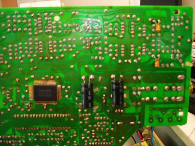

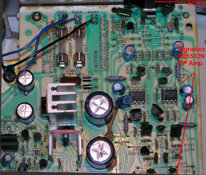

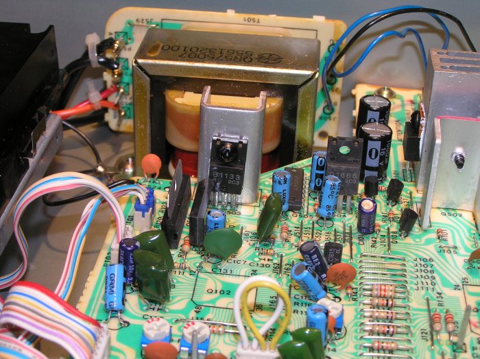

Cover yanked. Spotless inside. No signs of smoke. Actual fiberglass circuit board, not cheapo phenolic. As I predicted a 60Hz analog PS. copper and iron xfmer 18-0-18 VAC, two fuses to discrete 1N400? bridge followed by electrolytics and 3-term regulators. Good. I see some (4) Signetics NE5532 op amps (8 pin dips), two in each channel's audio path. No ribbons to the display, it is mounted 90 degrees to the main board with a light hood/dust cover.

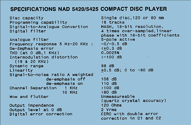

Schematic time. The unit is circa 1992.

Also keep an eye out for solder joints on the regulators and a device called a semifuse. They look exacty like a transistor, but with only two legs. You will generally not be able to see the legs.
Find the oscillator and stick a scope probe on it. You should be able to see a scan waveform on the display pins.

5. Shorting the output resistors is a bad idea. The OPA2134 is not especially tolerant of capacitive load and keeping at least one resistor is advised to maintain op amp stability.
