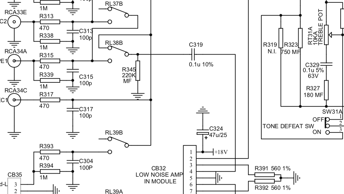

I have the above integrated and the volume adjustment range has always been poor in that it goes from silent to very loud within 10% of potenmiter ajustment range. In other words. If volume is 0 at 7 o’clock position, by 7.5 to 8 it’s reasonable listening levels and by 9 o’clock it is as loud as one would ever wish. Above that it’s ear splitting and clipping.
I have tried it as an integrated and with a variety of external power amps out the pre out. Including a NAD c370. The anustment is more or less the same in all cases. Slight increases in adjustment range but never being able to use more than 1/10th to 1/8 the total range. I even experimented putting a second volume control before the inputs and that was not very helpful either. Of course on amps with gain adjustment one can increase the range of the vol on the c325 as a pre. But it just can’t be “correct” . And doesn’t help if using it as an integrated.
This seems extremely strange and non-optimal. Both In terms of ergonomics and sound quality.
I am not sure if the underpaying problem is the volume pot or a larger design flaw in the preamp/line stage gain being just far to high , the c325bee’s week point seems to be its preamp section. Having tried various combos, using It just as a power amp with an external preamp (some many tines the cost of the 325) is surprisingly good! Using it just as a preamp with external power amp is always produces a hard and thin sound. Almost as if the preamp line stage is being overdrive.
Is this “normal” for this amp? Any suggestions on ways to fix this volume range?
Your problem is the input sensitivity of the preamp section of NAD 325BEE which is 240mV according to the manufacturer specification (see attached). This is really high sensitivity for most modern sources where line level output is more in the range of 1~2V. The amp section has sensitivity of 730mV which is not as high as that of preamp and thus should allow using passive or simply buffered attenuator with a more convenient adjustment range.

The line inputs require attenuation. I suggest 18dB of attenuation (i.e. reducing the input signal voltage to one eighth of its value). A simple passive resistive attenuator can be wired internally across each of the line input sockets. I suggest you try 18K (R1) and 2.2K (R2) resistors wired as shown in the following calculator:

Wasn't trying to put you on the spot, just putting the preamp circuit out to a wider audience as I'm not an expert myself. I can see discrete transistors at the preamp outputs, so perhaps someone can suggest how to tweak their gain.

Perhaps a resistor/trim pot just after the protection relay at the input stage before the capacitor 319 in the schematic above? ? Or perhaps lowering the value of the resistor 345 that I guess is shunting some signal to ground ?
Thanks. This issue appears to be an inherent design issue rather than an isolated fault. I have searched and found no service bulletin on the issue; it’s not mentioned in the service manual either.

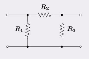

Look at the 'Tape 1' input. When this is selected, the resistors R339 (1M), R315 (470) and R345 (220k) form a Pi-pad attenuator which will also provide impedance matching between the source and the preamplifier.
The equations for calculating the values of the three resistors for unequal source and load impedances are quite complex, but it would appear that increasing R315 while decreasing R339 and R345 increases the degree of attenuation.
https://www.electronics-tutorials.ws/attenuators/pi-pad-attenuator.html
To keep it simple, you could try increasing the value of the 470 ohm resistor (R2 in the attached thumbnail) to see how that, on its own, affects the degree of attenuation.
