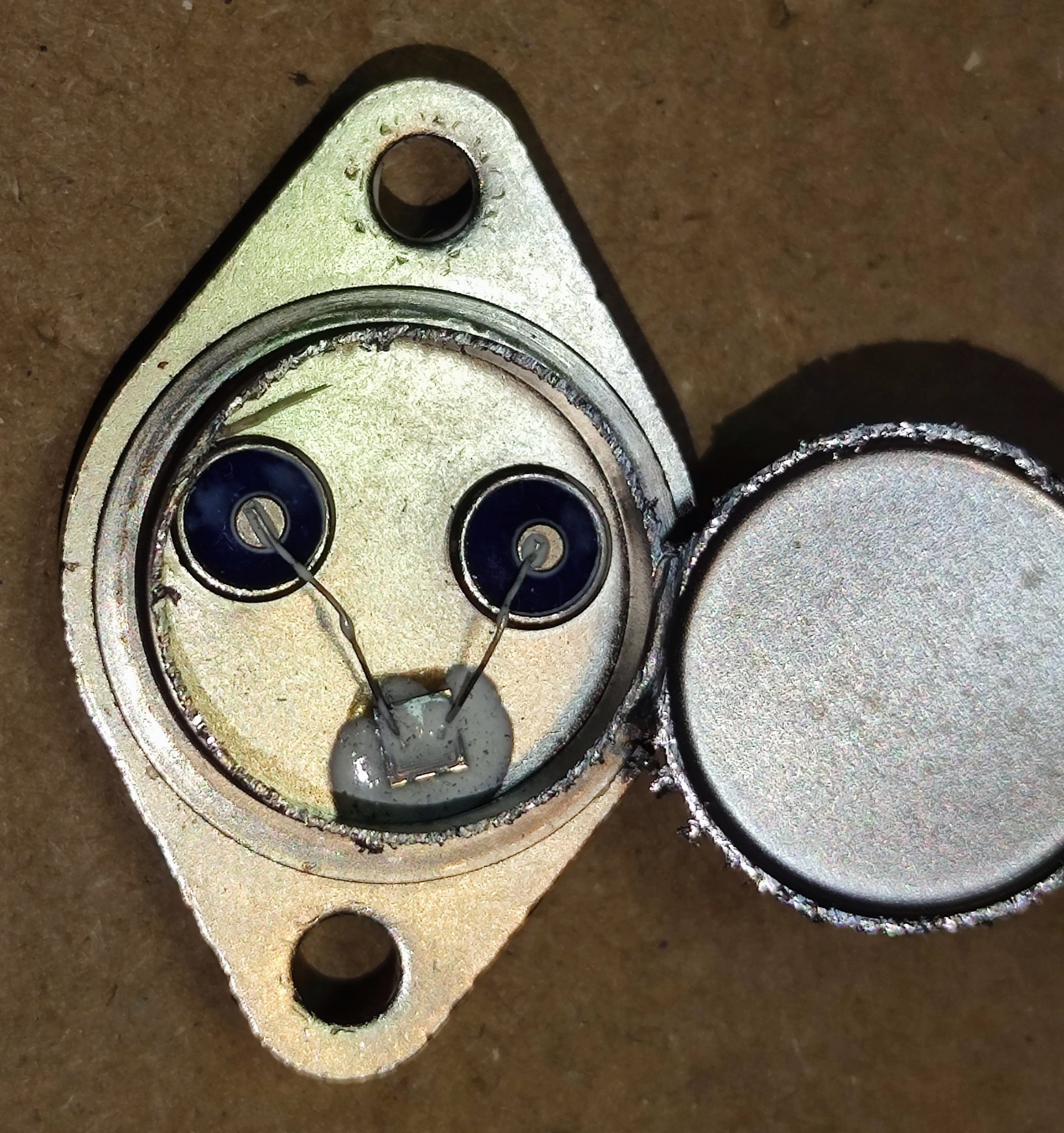

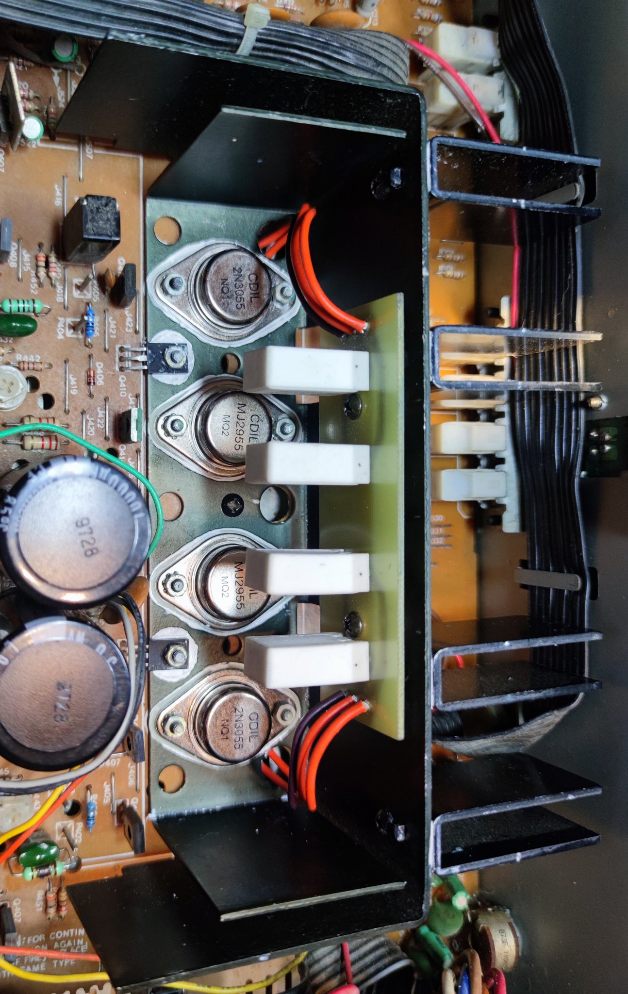

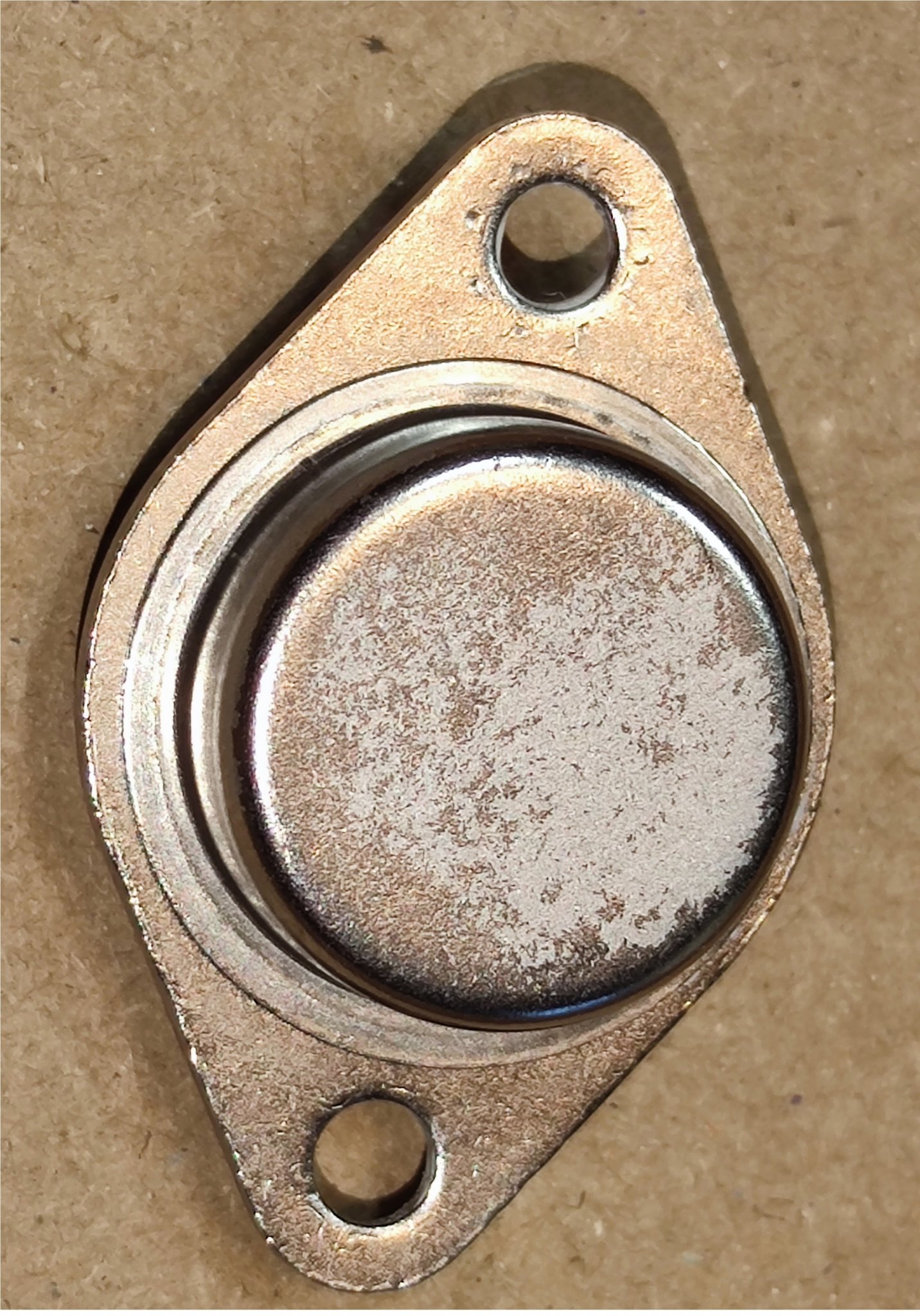

1st picture is from one (fake) but working 3055 after rubbing some propanol on the markings
2nd the look inside picture, does it look like a 115W die ?

If you can, get those.
But American poster 'indianajo' says there are better MJ series transistors, which can be used instead.
The shipping and handling adds up, CDIL is a long standing company, see their web site.
Should not be a problem, and nobody bothers to fake those....and good TO-3 are hard to get now.
Even 'BEL' made ones are sometimes fake, it is a government company, silicon to final product, which is defense stuff of excellent quality, and supplies to the civilian market are mostly devices which are below testing requirements, in other words tolerable rejects.
Price tends to be well in excess of market, so half price stuff is automatically suspect. Their 2N3055HV is famous, High Voltage grade.
CDIL has no such problems.
But find the fault first.
Getting ready for second round, parts on there way.
Going to run with the suggestion on another post and fit 4 resistor with the new set(s) of 3055/2955 but have to get 0.51 or 0.56 Ohms (have to buy) or go with 0.33 or 0.47 that I have in stock.
Recommendations ?
