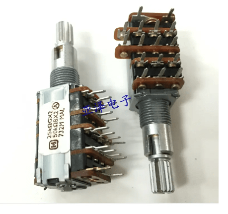

After a recap of my NAD 3155 I dropped and fractured the volume control. I repaired it with a Panasonic volume control which has loudness taps and two shafts for balance, but I would like to get the correct pot in it.
You'll have to post a good photo of the original.

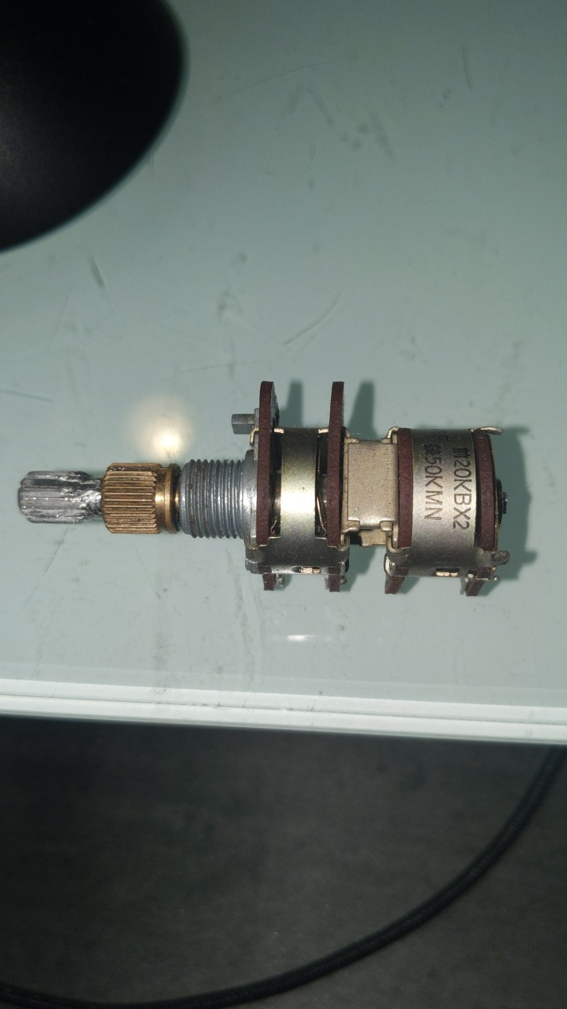

Image Below:
Rear section (according to schematic and from the part) 50KMN balance connected to inner shaft.
Front section (according to schematic and from the part) 20KBX2, I believe this one is an audio/log taper since the center tap is 5.87K from the low side of the control.

Thanks. I feared as much. I found the stages so I will build one up using the Panasonic's mechanicals.

That pot seems to have been used on some other NAD products as well (7140), etc. You might try emailing NAD at Parts-USA@Lenbrook.com. The NAD part number is 41-686-0-0. I've attached the service manual as well.
