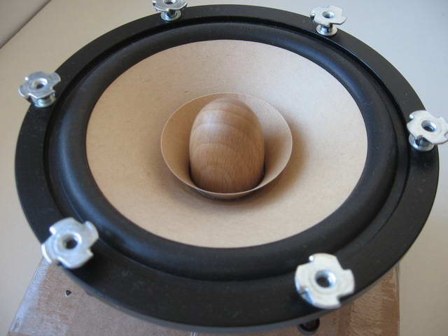

Finally i understood your speaker plug utility avoid treble to be cancelled with waves reflected and crashing one agains other and cancelling one each other.
A good friend, an Acoustic Engineer said so and explained me using graphics.
Is those plugs alike egg skin?... say... are they ligthweigth , non solid, having air inside?
Can this be made using metal?.... is the weigth important?... can be a magnetic metal?

It is off-topic, but we can always split off a new thread....
My plugs are spun out of wood so they are solid -- some people say/thick the actual wood makes a difference. Non magnetic metal can be used and sometines (if designed in and tightly coupled) can be used as additional heat sink for the motor. I have seen cast platic Lowther plugs. Non-magnetic metal could be used but one might have to account for changes in the magnetic field.
dave
