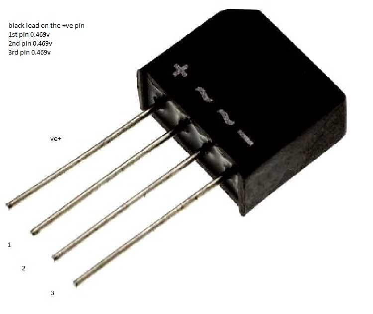

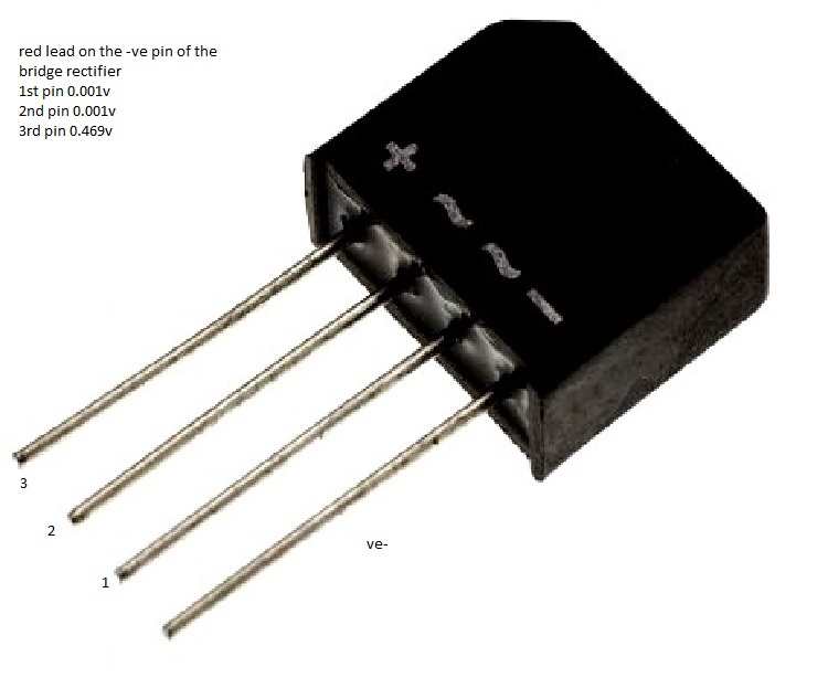

red lead on the -ve pin of the bridge rectifier
1st pin 0.001v
2nd pin 0.001v
3rd pin 0.469v
black lead on the +ve pin
1st pin 0.469v
2nd pin 0.469v
3rd pin 0.469v
1st pin 0.001v
2nd pin 0.001v
3rd pin 0.469v
1st pin 0.469v
2nd pin 0.469v
3rd pin 0.469v
Normally you check bridge with pin names like "AC", "AC" "+" and "-".
The pins I type as "AC" have a wiggle printed next to them.
- to any other pin .001 v on diode scale is shorted.
Try to buy a bridge with more voltage (400 piv) and amperage ( 8) next time. cost cutting is for OEM's, not diy people.
so something like this?
AttributeValue Bridge Type Single Phase Peak Average Forward Current 8A Peak Reverse Repetitive Voltage 600V Mounting Type Through Hole Package Type GBU Pin Count 4 Configuration Single Peak Non-Repetitive Forward Surge Current 200A Maximum Operating Temperature +150 °C Minimum Operating Temperature -55 °C Peak Forward Voltage 1V Peak Reverse Current5µA
so its simlar to testing any diode then, including how you would test a transistor?Two of the diodes in the bridge are short circuit. Replace it.
Sid
Yes it's the same, you just have four diodes in one package.
