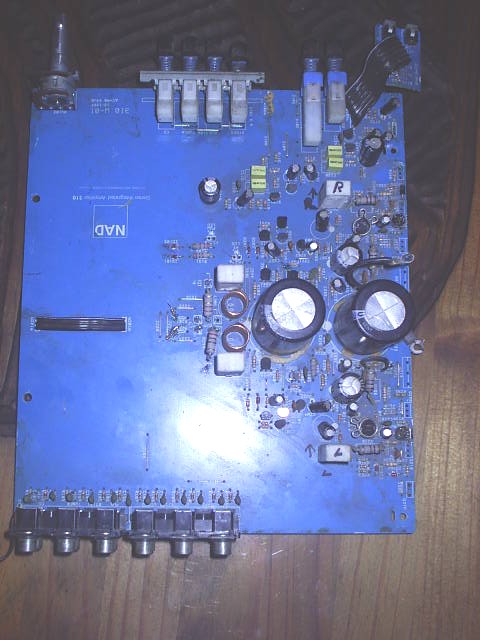

here is a pic of my yet to be modified NAD-310
Ill post the modified pic later this week:nod:

I couldn't get it repaired anywhere because of part availability here in SA! so it was going to cost me more than buying 2 5.1 surround Amps!🙁
so Im busy building my pre Amp Inside the 310!😎
with a ESP surround Decoder!
for Amps
Dual P3A Amp Modules
and my own design a Stereo SoundBoy Amp!
Will Post Pics Soon!
