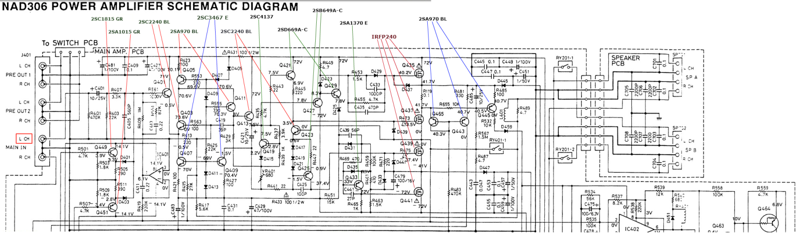

I have this Nad 306 that I really love but now I readed on different topics that old Nad models have very poor speaker protection and if the amp fails usually will also kill the speakers .
Maybe someone can take a look to tell if the speakers are safe using this amp .
This amp also have a relay but I'm not so sure what a good speaker protection really means regarding the schematic .
Adding a series 2A fast blow fuse in each speaker line should be good enough.
What speakers are involved, and for how long have you been using the NAD without “protection”? This amp model is over 25 yrs old, and while I don’t currently own any NAD products, I certainly did back in the late 70’s though mid 80’s, and can never remember damaging any of the dozens of pairs of speakers that rotated through my systems in those halcyon days. Car stereos were a different story back then 😱
But if you’re paranoid enough about it, and still love the sound of the NAD, there are several options for DIY friendly protection circuits - i.e. fully engineered circuits, PCBs and bills of material - that providing sufficient internal space might be able to be shoe-horned into the existing chassis. I’d probably prefer to add something like that than try to hack an existing circuit.

Can you go up the circuit so we can give you a good advice?
Here you have the link.
https://www.hifiengine.com/manual_library/nad/306.shtml
If the NAD 306 really has a protection circuit with relays, it is much more effective (it cuts the current of the output stage) than a 2 amp series fuse before a peak or high crossing distortion .. A tweeter goes to a better life with much less current than 2 amperes, the Nad 3020 had (I still enjoy) a circuit of Soft Clipping, if the 306 has the same, leave it always activated.

Well, you already have the circuit, and yes, it has protection by peaks of distortion by crossing (clipping) and by short circuits (3 relays) so the only recommendation that I would give you is that you do not abuse loads too low, I always distrusted the 2 theoretical ohms that many manufacturers claim to endure without problems.

The schematic snippet above cuts-off much of the TA7317P chip, which with Q445 et al does provide a "complete" protection against both over-current and dangerous DC offset.
Thank you all for your helpful responses the schematic of this amp is very complex .
