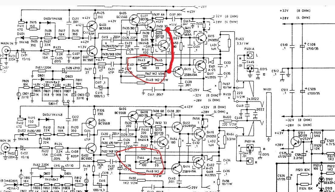

I didn't say you could short the thermistor, I said you could short out between the base of the two drivers. That's Q411 and Q413 here.
The red link shows the idea and most amplifiers are of this configuration (ignore the red circle).
Your thermistor may act in conjunction with a transistor (Q409 in this diagram) or it may act alone directly on the driver transistors. That is why we need the circuit details.
