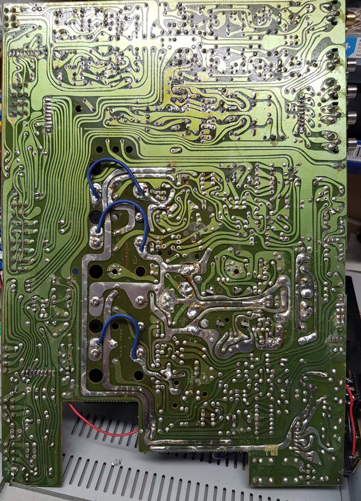

Something to be wary of in replacing components soldered directly to the PCB is the rather "budget conscious" quality of board traces and solder eyelets. I'd use solderwick, and be careful about excessive rocking or twisting to remove any part - those traces are easily lifted or broken, and can be a nightmare to repair.
It is a very good advice. The PCB is not of the quality you might want to go changing components if you do not have a great experience in the field.

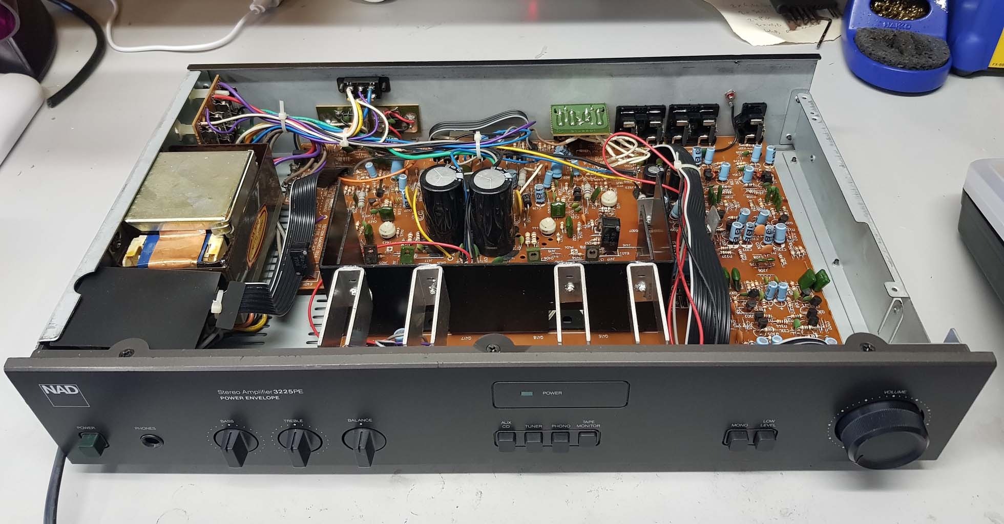

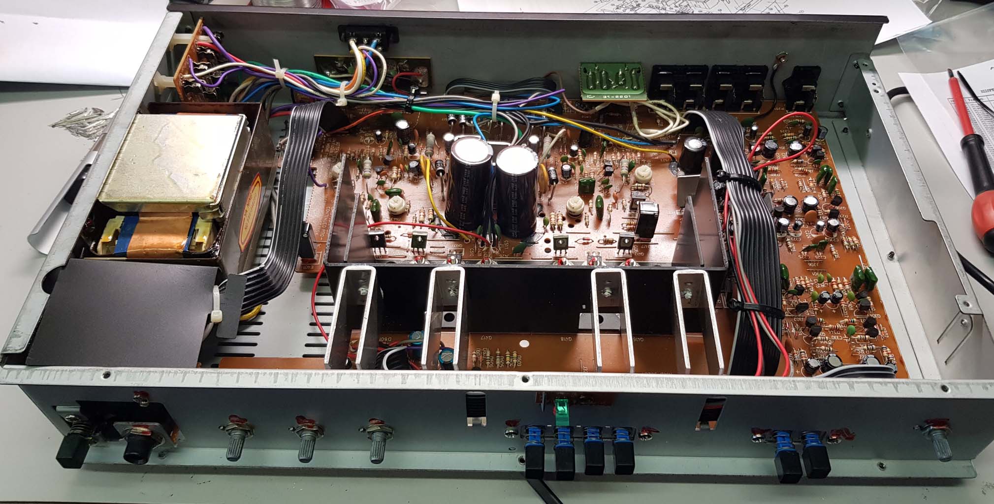

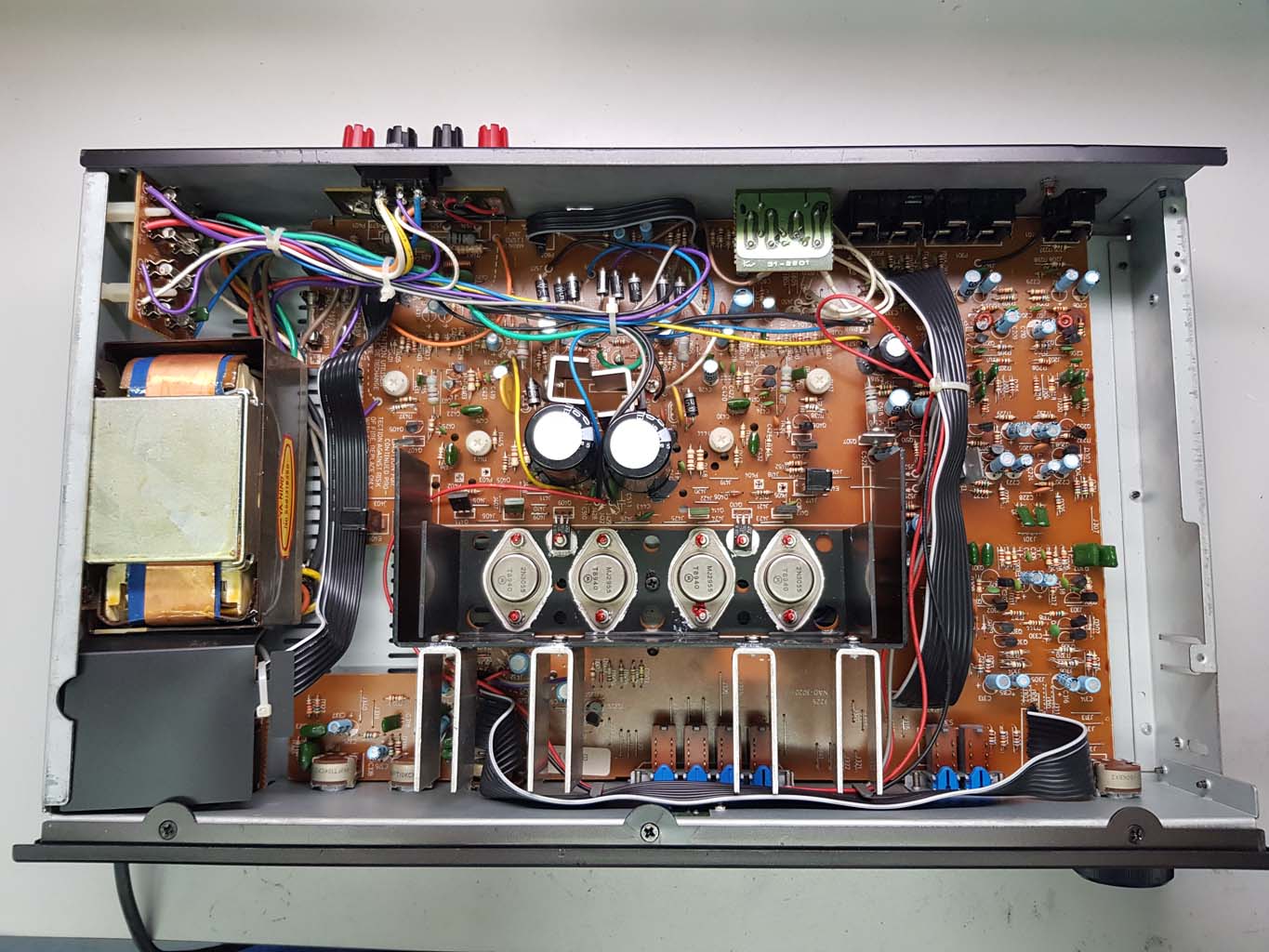

I just recapped an (auction site) special NAD 3225pe as a side project and am pretty pleased with the results. Just under 50 electrolytic capacitors to change out in total I think it was.
I didn't tinker with the values at all, apart from substituting the 0.68uf 50v for some 0.47uf at the low pass filter network (availability issues).
$25 for genuine, reasonable quality caps (nothing too flash needed for my intended use) and under 2 hour labour total to complete was pretty worth it. I too had a bit of hum but she's pretty clean now!
Hunting for some speakers to match this one now...

That looks really nice. I keep an eye on auctions for gear that's broken, but usually the price of postage to outer woop-woop where I live is more than what they want for the gear, which makes it somewhat difficult.
Even in 'the big smoke', some places still try to charge me as 'regional freight'. But every now and then a decent bargain appears 🙂

Can somebody tell me whats the capacity and voltage of C427 ?
I was searching this capacitor in service manual, but i couldnt find it.
The other thing to watch out for in any NAD amps is dry joints. I've seen a lot particularly when (on some models) the transformer sits on a pcb. I had a NAD2200 with dry joints on the transformer centre tap which caused uneven supplies and a major blowup of the power amps. It was a semiconductor graveyard! Just worth a look while your at it.
If 3020i or 3225pe, that one is 47uF, 25v, 20%
What version 3020 is yours? If it is 3020B or 3120, C427 is a 50V ceramic cap. 0.0082uF +/-5% according to that particular manual. NAD 3020 - Manual - Stereo Integrated Amplifier - HiFi EngineCan somebody tell me whats the capacity and voltage of C427 ?
I have the first version of NAD 3020
