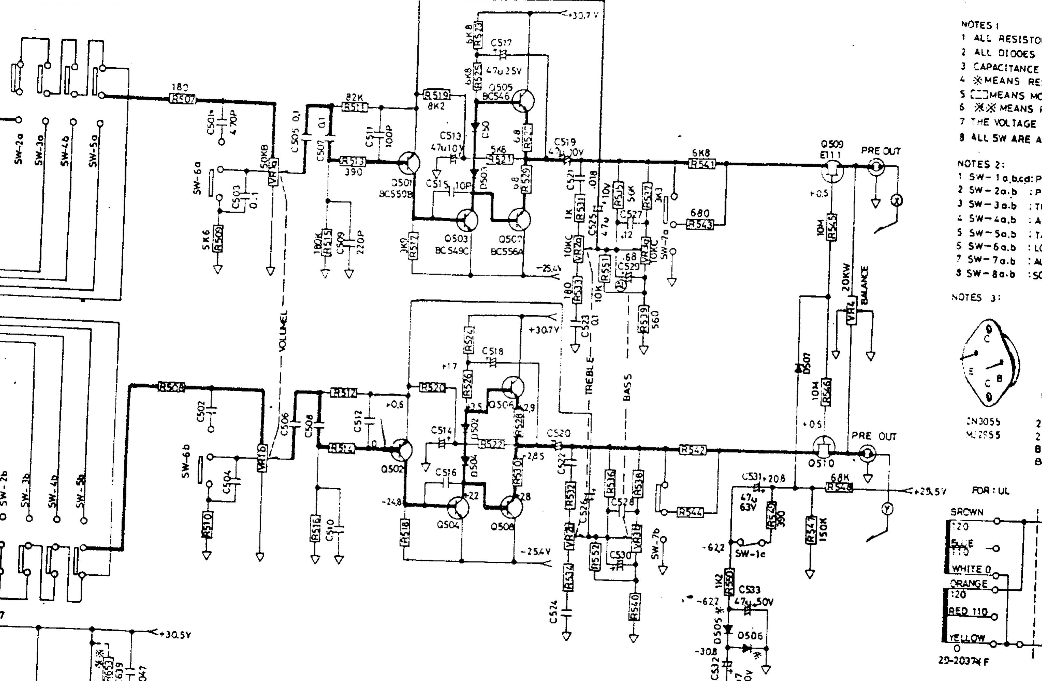

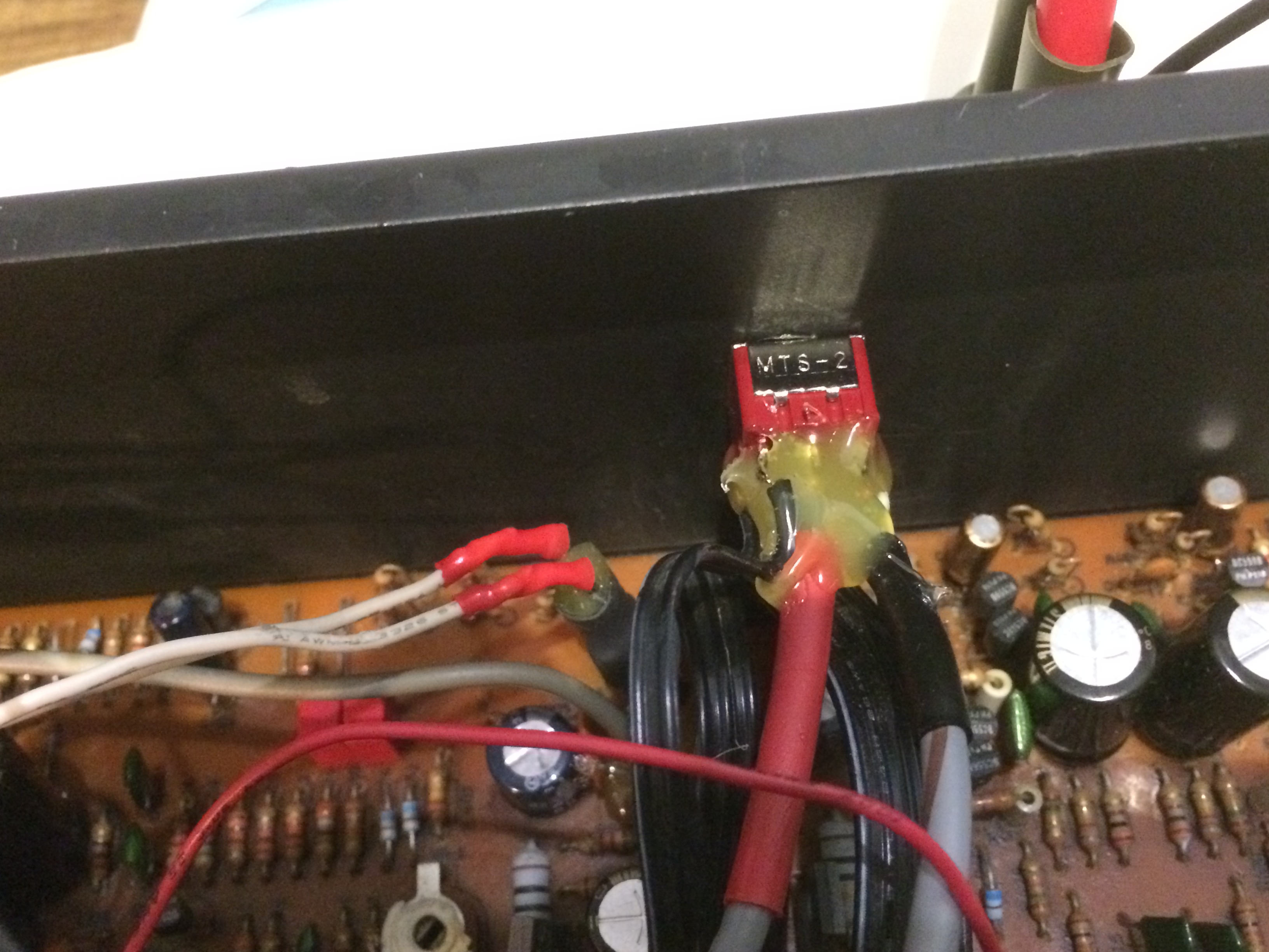

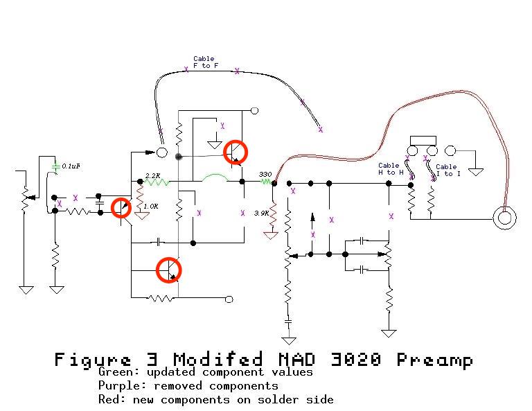

I want to repeat the transfer of the signal directly to the output
But I have a different circuit with 4 transistors! they use different
Figure 3 transistor! and I need to withdraw from the 4 transistors\
http://www.angelfire.com/ca/rchau/audio.htm
help how to draw !!

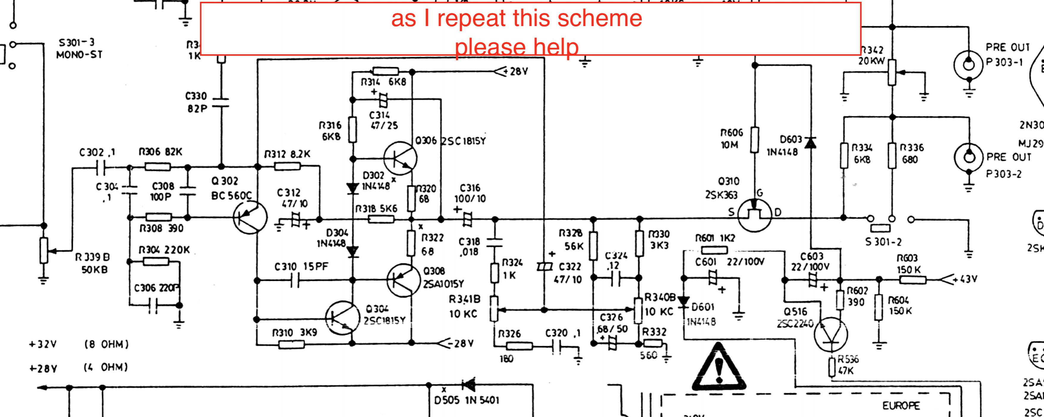

I want to repeat the transfer of the signal directly to the output.

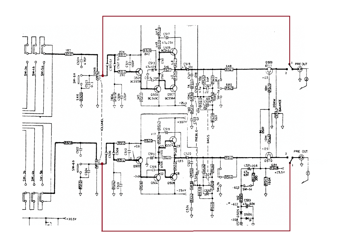

The tone control components can't just be removed, because they are part of a feedback loop that sets the gain.
Is your goal to bypass the muting circuit FET. If so, simply connect the source and drain of the fet together with a jumper.

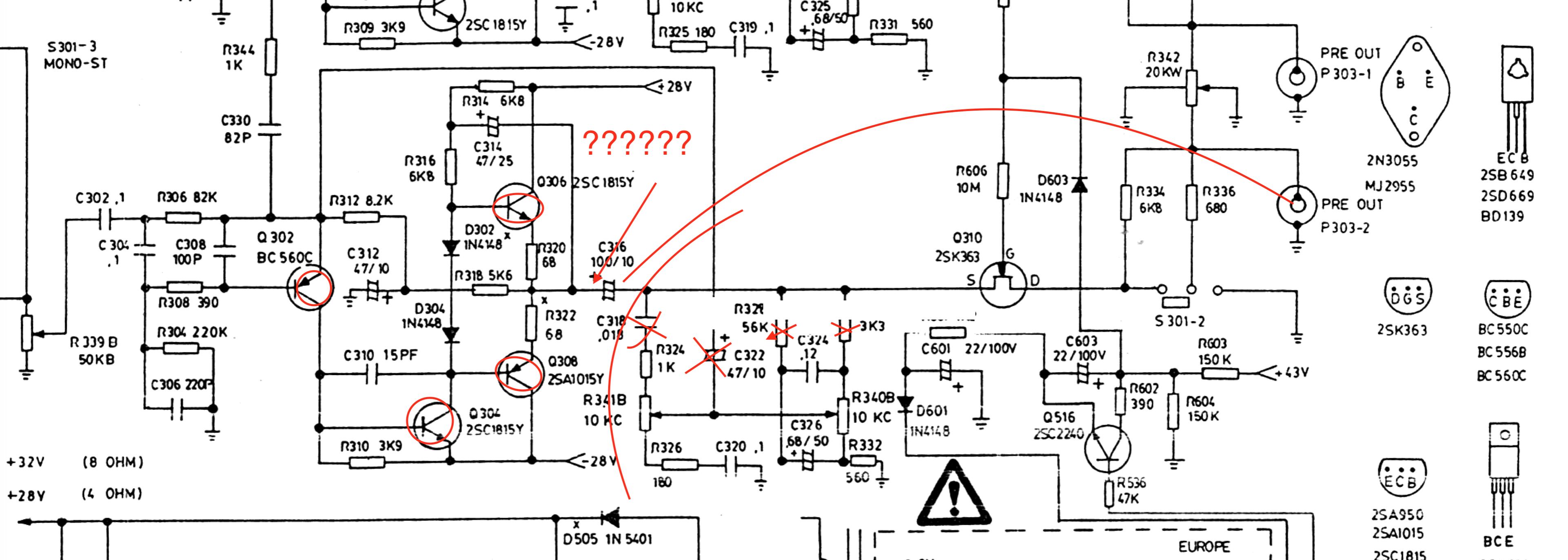

you will be able to draw? directly on the chart

Connect a jumper between the drain and source of each FET, to short it out.
Center the tone controls so they have a flat response.
It's also possible to delete the tone circuit but it is more complicated,
so do the above first and make sure that it works properly.
I beg to draw the diagram!
you can draw on the scheme
I'll have to do that tomorrow, my scanner isn't working right now.

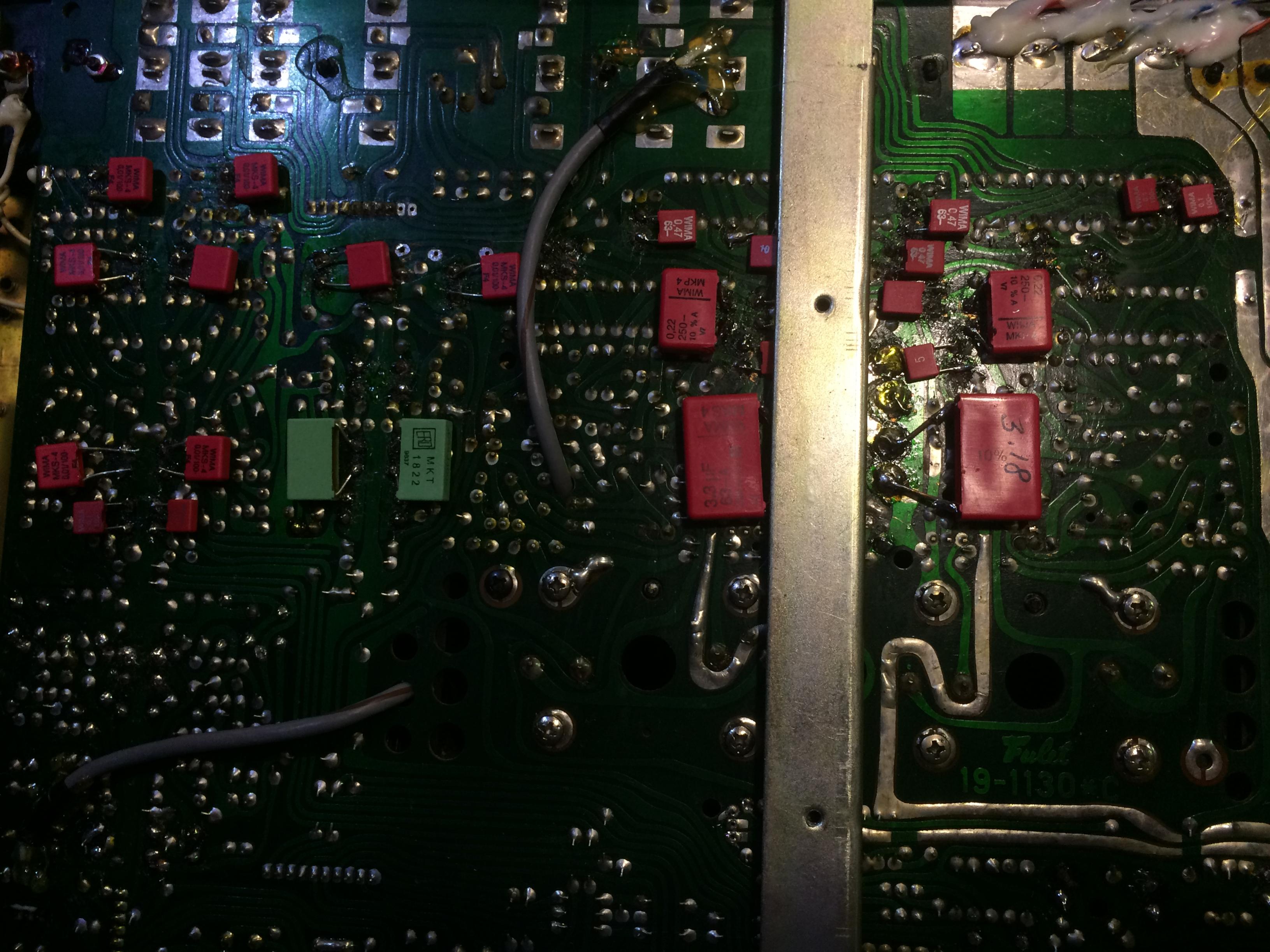

My teacher helped me! we did everything just like that !!!! The concept is simple
You do not have to fence not a bias!
It is playing a little quieter and everything but! You'll be rewarded with clear sound !!!
and the ability to adjust the sound level without loudness !!

Sure, now it's a "passive preamp" with no gain. Just keep the output cable short, and low in capacitance.
- Nad 3020 modif
