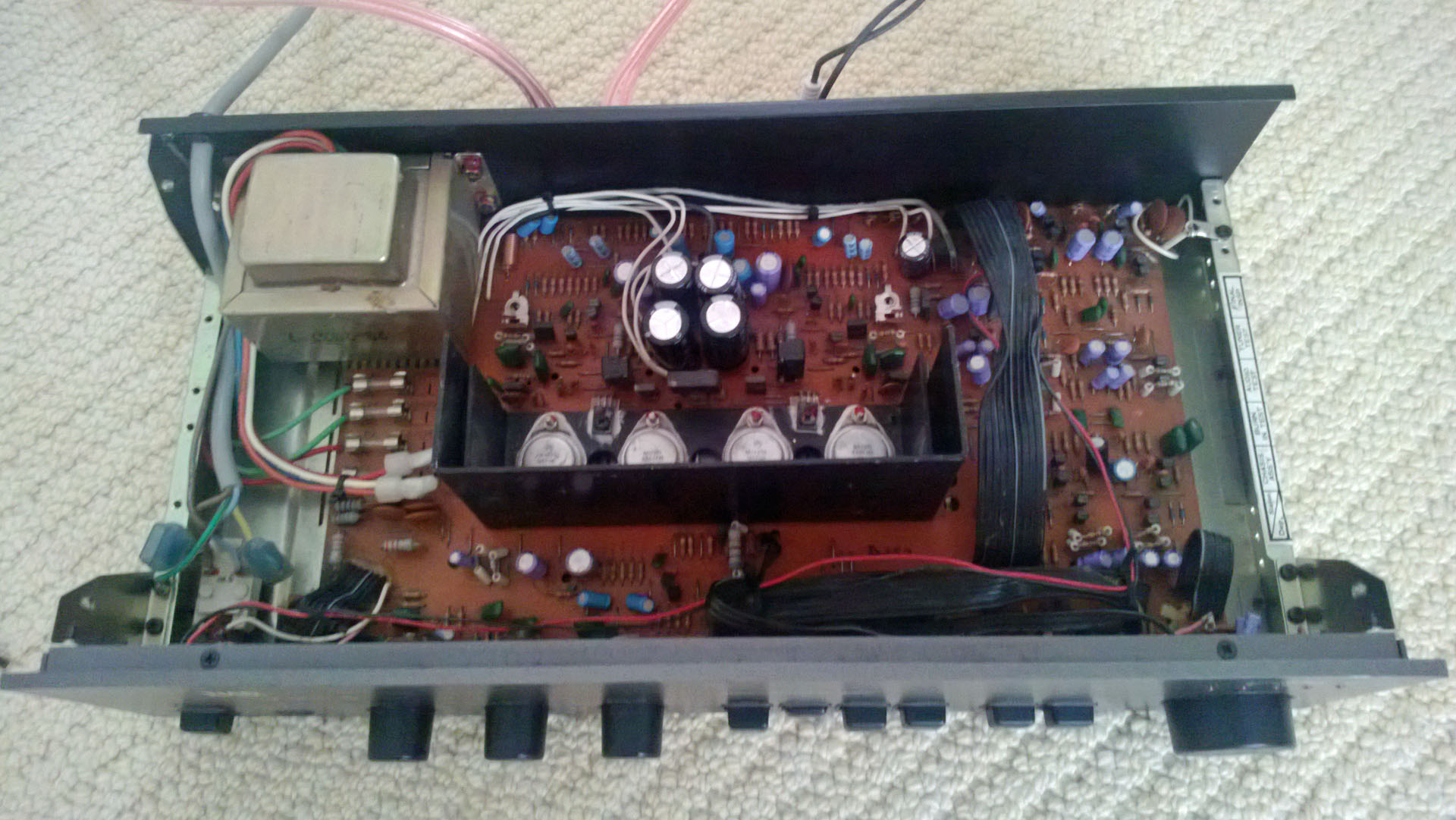

Confused now but here is the pic of the one I have.

Model wise it says NAD 3020 (no any other letters) on fascia. If it helps to identify it further then Serial Number is A3253294.
No, 3020 is 3020, not 3020A or B revisions. This appears to be the original 3020 model. Note that for UK distributed products, AFAIK:
1) Location of the 4 large electrolytics (compare with position on 3020B layout diagram)
2) The mounting of the transformer to the rear panel.
3)There's no 8/4 ohm speaker load switch, that swaps power transformer tappings on later models.
4)The front panel logo position is further from the left side and 3020 means only what it says.
5) Q509,510 (the JFET muting switches in the 3020B) are just not there.
6)The separate PCB you referrred to is that of the power meter only, not the preamp. (located above volume pot.)
There are more differences but that should do to distinguish them. Common part numers are retained from the 3020 and this is why you see the same capacitor reference numbers. This helps if using the wrong schematic, provided you read the label and are mindful of which model you are dealing with. There are plenty of free schematics for these on the web, so there should no problem, taking care that the Google engine doesn't just bundle all variants containing the search term together. An easy mistake, to assume the engine can sift for all your search priorities with only one reference.
This example appears to have had a replacement part or two already, as it should have, after 30 odd years. (C513 and apparently the main power supply electrolytics, and the bias sense transistors, Q609,610 may have been remounted for some reason, perhaps in error.)

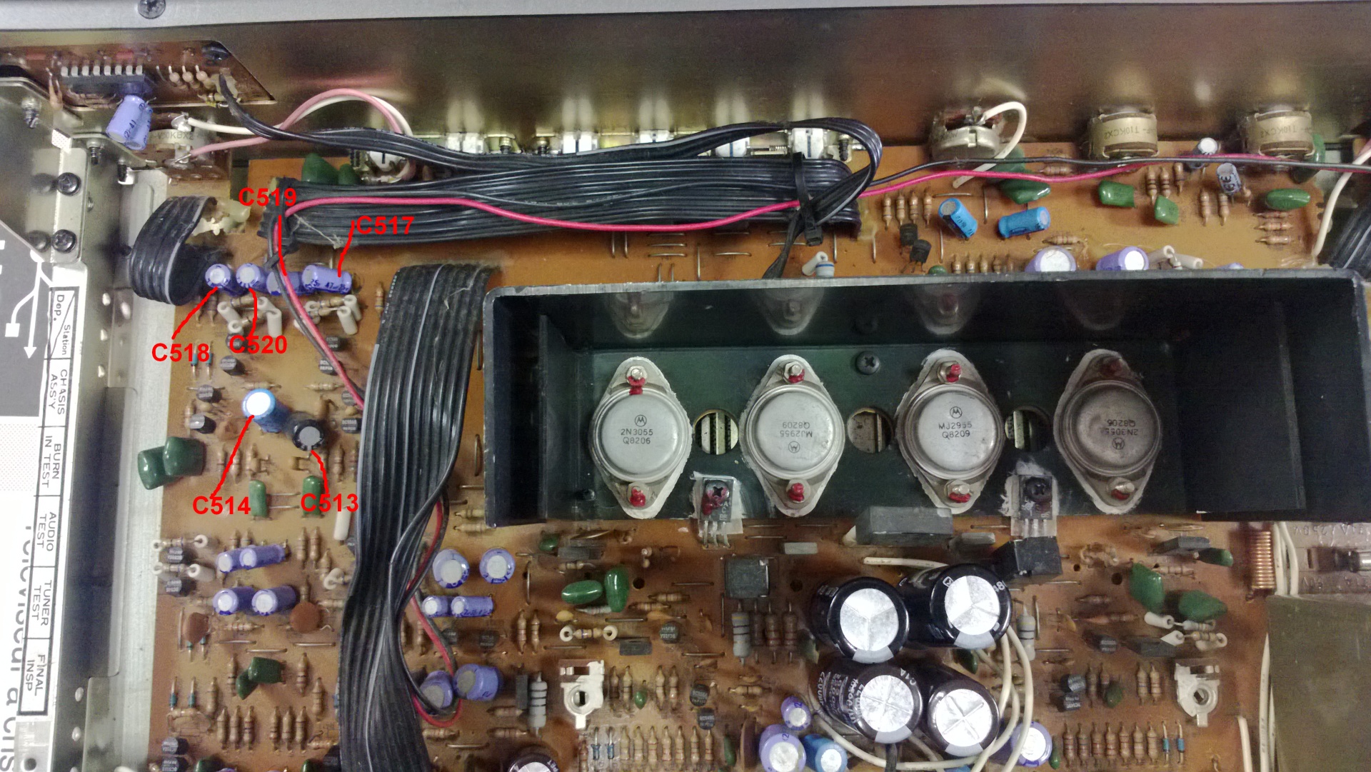

Thanks Ian for your input once more. The points you've mentioned match the amplifier I got here and I also had a look at the service manual available on hifiengine and I'm pretty certain now that it's the original 3020.
It kind of contradicts with what jaycee said earlier in regards to the pre amp caps:
but after having a look in the service manual looks like the caps in question really are C513, C514, C517, C518, C519, C520 (as already discovered on the map), jaycee was referring to B model in regards to these caps, mistake?
Another thing I've discovered is that there is a discrepancy in the capacitor values I've found in the manual as the caps in the amp are slightly different, probably replaced already at some point?
According to the manual the capacitor values should be:
C513 - 47uF 10V
C514 - 47uF 10v
C517 - 47uF 25v
C518 - 47uF 25V
C519 - 47uF 10V
C520 - 47uF 10V
but as per my previous post the capacitor values installed are:
C513 - 47uF 16V
C514 - 47uF 16v
C517 - 47uF 25v
C518 - 47uF 25V
C519 - 100uF 10V
C520 - 100uF 10V
If there are no other immediate suggestions I'll proceed to order the replacement capacitors? I'm now confused which are the correct capacitor values, I'm guessing the ones mentioned in the manual? In having said that C517-C520 looks like the original capacitors? Could it be that there is a mistake in the manual?
At the same time I'd also inspect for broken PCB traces.

Forget the rest, change C531 and C533. They form the voltage doubler for the preamp stage and give problems. Make sure you fit 105° types and always fit the same voltage rating!
Christ on a bike, looks like I'll have replaced all the capacitors by the time I've finished with this thing. 😀
By saying "fit the same voltage rating" I'm guessing you are referring to follow the service manual entries (C531 - 47uF 63V & C533 - 47uF 50V) instead of matching the voltage rating for the two caps, let's say both 63V?
Sorry, for all the noob questions but I'm learning this stuff as I go along.
Will order some higher grade caps next week but I've checked my local Maplin and they have both caps in stock but only one of them is 105° but it shouldn't harm to fit 85° for the time being to at least try out your suggestion. Will try to fit them tonight to see if this is a culprit of the issue.
I think both at 63v will be OK but when I often read about people changing a 10u 16v for a 10u 100v that is silly as they are a different construction and ESR etc.
OMG, you won't believe this.
Changed the caps Jon suggested - C531 and C533, plugged the amp back in, still humming like mad. 😡
I though, well I need to order more caps to replace C513, C514, C517, C518, C519, C520 as suggested earlier but then decided to inspect for broken PCB traces as suggested by Ian. I didn't have a magnifying glass at this stage so was just using bright torch and eyeing the board as close as I could. Went over several times but could not see any interruption in traces but then noticed that two of the Phone Input soldering points have one edge ever so slightly lifted off the PCB.
I thought that it surly cannot be the culprit of the problem and I was convinced that there is still contact made and I was going to leave it but then I thought, what the hell, I might as well re-solder the contacts while I have the soldering iron out.
Plugged in the amp afterwards and it greats me with absolute silence. 😱 Plugged in source and it plays music like there is no tomorrow.
The moral of this story is that sometimes it's more simpler than one might think. 🙂
Thank you all for your input it was much appreciated.

In fact, before I sign off, I just would like to clarify the capacitor values discrepancy I've mentioned earlier.
Just in a case I ever need replacing any of the caps, as mentioned before C513 & C514 is 47uF 16V instead of 47uF 10V as suggested by the service manual. It looks like these two caps have been replaced at some point and my understanding now is that if they have slightly higher voltage rating it's nothing to worry about?
On other hand the caps C517 - C520 all look originals and I can't see any trace of any re-soldering. While the caps installed in C517 & C518 matches the suggested values in the service manual the caps installed in C519 & C520 are 100uF 10V instead of recommended 47uF 10V. Should I be concerned about this or is it OK to leave them as it is?
My further concern is that if I ever need to change these two caps what values should I uses, as from what I can gather while it's acceptable to use slightly higher value caps it's not to use lower value. So let's say if I follow the manual and replace 100uF 10V (installed) with 47uF 10V (suggested) and if it was a printing mistake in the manual I could mess up things, could I?
On a completely different matter what's the best way to clean the switches to get rid of any crackle? I believe there is some sort of spray?
Use Servisol Switch Cleaner or if they are really bad 3in1 Lawnmower oil. Yes, it works a treat!
C531 and 533 are the main ones to change!
