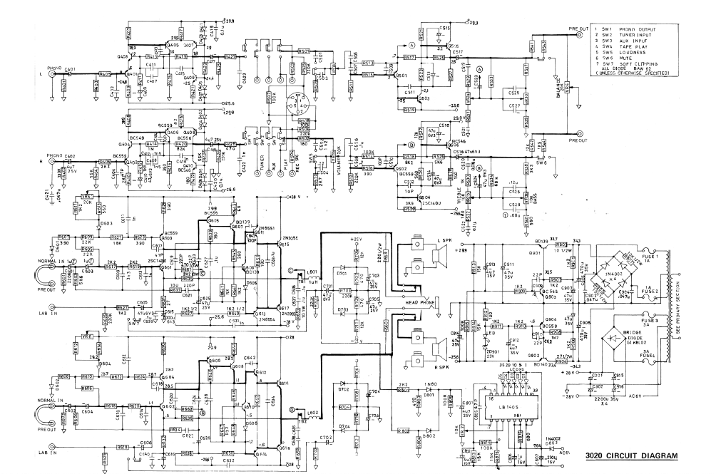

Hi this amplifier nad had no sound and -3.4v dc on both outputs i found that the 38v supply was missing. I found that R513 1K5 o/c and C518 220mfd 50v s/c.

If one side of the power supply is missing then you will get a big offset ,have you got a circuit diagram ?
Hi yes i have a full manual and yes i would have expected a bigger ofset but both o/ps were at -3.4v thats why posted the repair one to watch for

Had a similar problem with mine. The bias link across R456 had gone o/c, burning out R456. Unfortunatley mine went +VB (33V) at output, therefore burning out the voice coil of the R/H speaker, an old Tannoy HPD315.

Your right this is no NAD 3020 which I have in my room somewhere .

Yes, the 302 was a later circuit but not, i believe, based on the 3020. See attached service drawing. The 3020 used the old TO3 2N3055 and 2955 output transistors and is a far simpler circuit.
More difficult to mount (a TO3-P would have been easier, had they existed back then). The 302 is also significantly more complicated.
