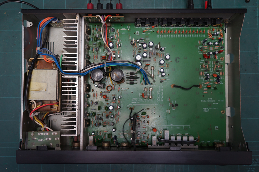

Hello.
integrated Amplifier NAD 302.
Power on but
Blown fuses F503 and F504.
All power transistors desoldered and tested OK.
Transformer dead?

With the fuses removed what AC voltage do you get from the transformer --have you tested for that FIRST ?
Also which section of the power supply is dead ( if at all ) as you have a higher voltage stabilized feed and a slightly lower non- stabilized feed on separate winding's of the transformer --both sections have their own twin fuses ?
On the transformer winding's with a simple diode bridge and no stabilization you should get approx 33Volts DC +/- output and the output from the stabilized winding,s approx 28 Volts DC +/-.
At the input to the fuses you should get a higher AC voltage than the DC output of each supply .
This amp I know. Most reason are faulty caps C508/C509 and S502 for switching the secondary winding for two different supply voltage.
Replace the caps, check the rectifiers D505-508 and remove S502 (solder connections for 4 Ohm impedance).
Now the next steps are as follow:
1) Introduce bypass resistors around 10-15K in parallel to C508/509
2) Disconnect the power amplifier stages from the power supply in such kind, that only transformer, fuses D505-508 and C508/509 are in operating after switch on.
If fuses blown again, check PCB-traces. If don't blown, check resistances between pos. rail and GND so as negative rail and GND to the power amp stages.
If resistances below 2-3K-ohms, you can connect again the power amps to the voltage supply after discharge C508/C509 for start usual troubleshooting

So you have confirmed that the AC voltages are okay ?
Also the fuses no longer blow --or do they ?

Its solved.
Resistors fuses R437 & R438 was dead.
After replacing Amplifier works fine.

I am glad you managed to locate the fault and repair it this sort of learning sticks in your brain for any future audio problems .

Any reason therefore ? To find out this is important, otherwise the same fault occurs sometime soon.Its solved.
Thank you very much.
Maybe too high current through Q407/408 (BD139) at both channels (temporarily RF oscillation ?).
