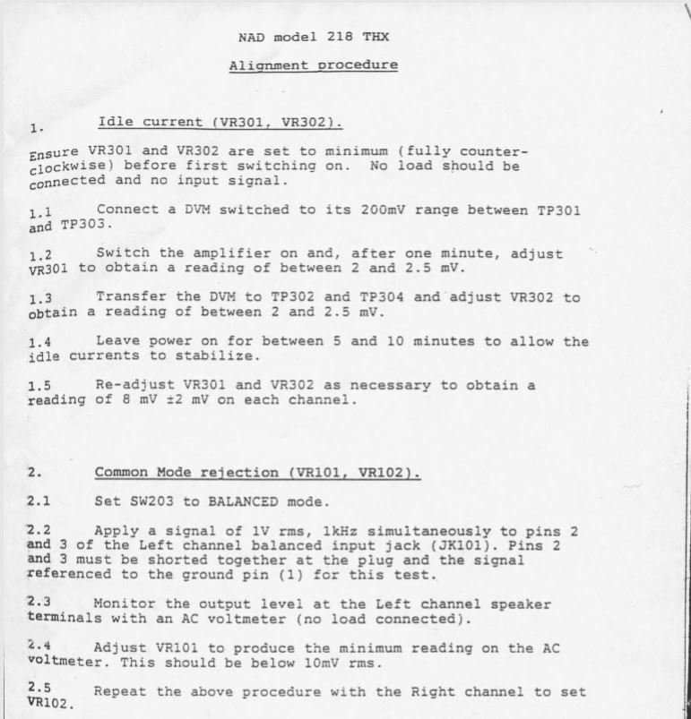

Yes as bullittstang mentioned trying a phone or if you have a cd player with volume output control you can use that straight into the amp to make sure it isn't your preamp do you have the service manual? if not it is easily obtainable on the web here is a page from the service manual on how to set/check the idle current and common mode rejection i would also change speakers from left to right to see if that changes anything and or the source cables and sources from left to right ect cd player/TT/tuner ect..
