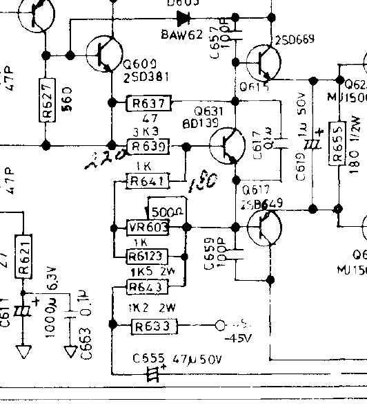

The bias is controlled by VR603 and VR604. The 500 ohm preset needs to be turned to maximum resistance (500 ohms) to give minimum bias.

Just a stupid question from my side, those VR's for adjusting bias, if they are turned all the way clockwise when looking from above (i.e. not from the "soldering side", sorry mind my limited knowledge of terms here) is that giving maximum resistance? or is it the other way around? Because I'm a bit unsure which way I'm measuring it...

Forget setting the preset by trying to visualise which way it might be... measure and be sure.
As shown on the circuit you need it set for maximum resistance, in other words so that it appears as a 500 ohm in parallel with the 1k across it.
You won't get a true reading measuring in circuit but that doesn't matter. Just measure across the 1k and the minimum resistance setting will show as almost a short (we don't want that end) and the maximum direction (which we want) will show as some much higher value.
And use a bulb tester initially. It will save damage should there be any problems anywhere else.

What was confusing me was that I get “inverted” (or rather, “switched”) values depending on which probe of the multimeter goes where on the VR. So should I measure across the two points of the 1K and adjust from there?
And also, about that dim bulb, also something new to me. Will try putting one together in the next days. I recall the written power rating on the Nad is 300 watts, does this mean I need multiple bulbs in series? Or is it the output wattage I’m looking at (50W in each channel)?
You get different readings because of the other parts electrically connected to the preset, and the semiconductors are polarity sensitive and so will alter the reading depending on probe polarity.
Measure across the 1k (so R6123 in the above diagram).
Remember 'a short is always a short' and so can not be influenced by what is around it.
So turn the preset to give the lowest measured resistance (should be zero but may read a couple of ohms). That is the direction we don't want.
Now turn it fully the other way. Job done.
