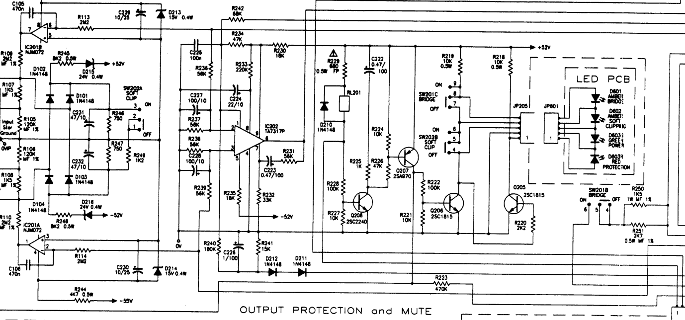

Have some problems with my NAD214. Some background: there was a speaker of 4 Ohms of DCres (although it states 8 Ohm on the speaker) connected to the NAD214 in BRIDGE MODE. Some distortion and one BAM sound. The speaker was disconnected fast.
Any more ideas guys?😕 The main part is what can cause pin1 of TA7317P be at 0.7V and why POWER LED sometimes after a few minutes turns off at all (no RED or GREEN).
Please find the most important schematics part attached here.

Now the NAD stays in PROTECTION mode, but the power LED sometimes changes between RED and GREEN when turning on/off the amplifier. After several minutes turns off at all (voltage across it drops). BRIDGE and SOFT CLIPPING LEDs works (but flashed at first).
Changed TA7317p protection IC (IC202). Tested and changed small capacitance bad CAPs around it.
The relay is new. All components contacts are resoldered. Switches and cables/joints too. Previously had the issue when cleaned a switch and sound came back.
Checked the resistors - values are good.

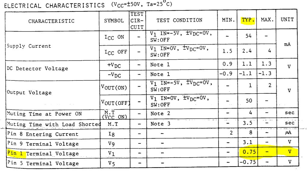

Even though the amp is in protection mode, it is working properly till the realay (checked with an oscilloscope and 1kHZ testing signal and the Idle Current is good for both channels).
What I found interesting that on the pin 1 of IC202 voltage is 0.7V, so MUTE is triggered. Changed diodes D212 and D211. Checked transistors on the power side of the amp. Nothing changed. Power supply voltages are good and noise-free (multimeter + scope).
No DC output on the pin2 and pin3 of IC202. Supply voltages good.

*Check DC output on Pin2 and Pin3 of IC202 (those pins responsible for DC detection). No DC voltage (only few mVs, - detection range for IC ~1.1VDC).
*Checked channels with scope and sine signal at the input, both channels works properly (clear and undistorted sine wave comes until output relay) and the power transistors' Idle current stays around 22 mA (20 mA according to a service manual). So pre-amp and power-amp are working.
-> The only thing is 0.7V on pin 1 of IC202 where this pin is responsible for over-current protection. But where does this voltage or over-current come here if everything's OK.

Have a look at D211 and D212. 0.7v is suspiciously close to a diode drop voltage..maybe one of those died?
Changed into new ones. Nothing changed.. When I turn on the amp, relay is turned ON even RED indicator is showing. Then it turns to GREEN for a second and then back to RED and relay disconnects..
And then amp turned OFF RED LED stays for a long time...
What voltages do you get on each pin of the IC?
Is C224 ok? That one appears to be for the muting circuit on pin 8.

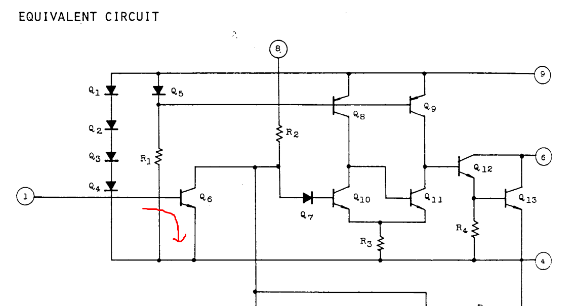

But you can see if there's 0.7V on the pin1 the transistor inside drags pin8 to GND..

So here are the voltages of IC202:
1. 0.73V
2. 0V
3. 0V
4. 0V
5. -0.73
6. 48.8V
7. 0V
8. 0.04V too litle?
9. 3.1V

IC202 could be damaged - shorting pin 2 and 3 of J303 would have connected the +49v at pin 6 to -55v at the anode of D209 on the schematic. I'd check out these zeners (D208 and 209) as they were known to cause trouble on other models.
When IC Pin 1 is less than 0.7, the Pin 6 should go LOW and turn the relay on (Provides signal to Anode D210 via 2 thermal fuses). Have you checked this pathway yet - continuity check between IC202 Pin 6 to anode D210.
Check C226. The schematic has that one +ve lead to 0v - if you replaced it, check orientation. If you didn't replace it, test it out.
Print a copy of the schematic and highlight everything that was connected together by the short circuit that shouldn't have been and see if those components are good.

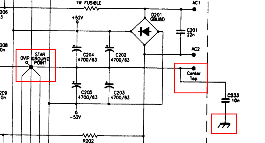

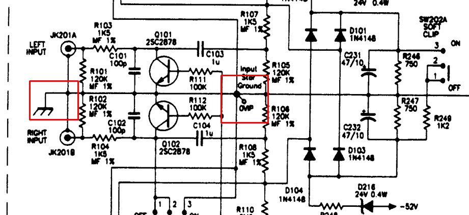

And a little bit more of magic. Everything starts to work as soon as RCA plug is plugged into L (MONO) INPUT. It's going from old generator even it is turned off. Suspect some signal-ground problems.. Plugging RCA without generators doesn't work.
Sounds like there could be a short to GND that gets sent to earth when you connect the RCA.
NADs are usually double insulated (no chassis ground) and they have 0V and transformer secondary centre tap connected to chassis via the C233.
I would check the condition of C233, see if there is any voltage between chassis and earth, check for connection between RCA input signal ground to chassis.
Does the amp work again if you connect the chassis ground screw terminal to earth with the RCA disconnected?
Checked C233, it's good, but I replaced to a new one just in case. I'm confused why this cap is used to isolate 0V from chassis when RCA 0V is connected to the chassis (see pictures attached) 😕 When everyhting is connected 0V everywhere is short to chassis.
