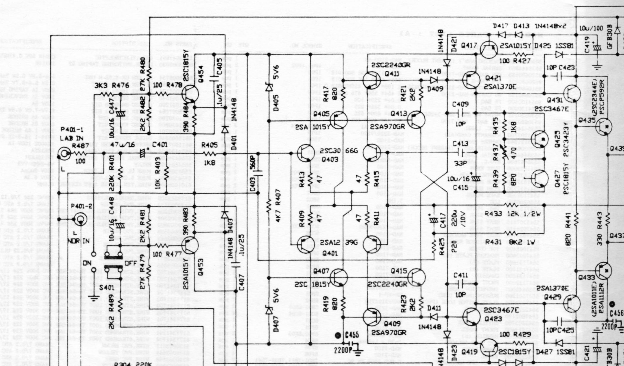

All, Sorry for the *noob* question, but I've been working on this guy for quite a few months now and I'm not getting anywhere.
I've got a NAD 2100 Power Envelope amp, and it's working well and sounds great. I recapped EVERY electrolytic (Nichicon FG), changed out the preamp to an LM4562, pulled out some Sanken output drivers that a previous owner had once repaired the amp with (I replaced them with Toshiba 2SA1943/2SC5200), and set everything up as best I can.
My issue is with the DC offset. One channel is right at 110mV at turn on and around 90mV once it warms up. The second channel is around 40mV.
This is not technically outside of the service manual specs, but I'd still like to get it down and I don't know how. I read one thread that suggested changing the input resistance (R403), so I put in a pot there. It did make a MINOR difference, but only down to about 70mV and only when the resistance lowered to about 1K or less. That was too low for my taste, so it went back to 10K.
One thing to note: the DC offset measured exactly the same BEFORE I did any of the re-cap or transistor changes. So, I know my changes did not affect anything regarding this issue.
Here's a snapshot of one of the amp's channels:

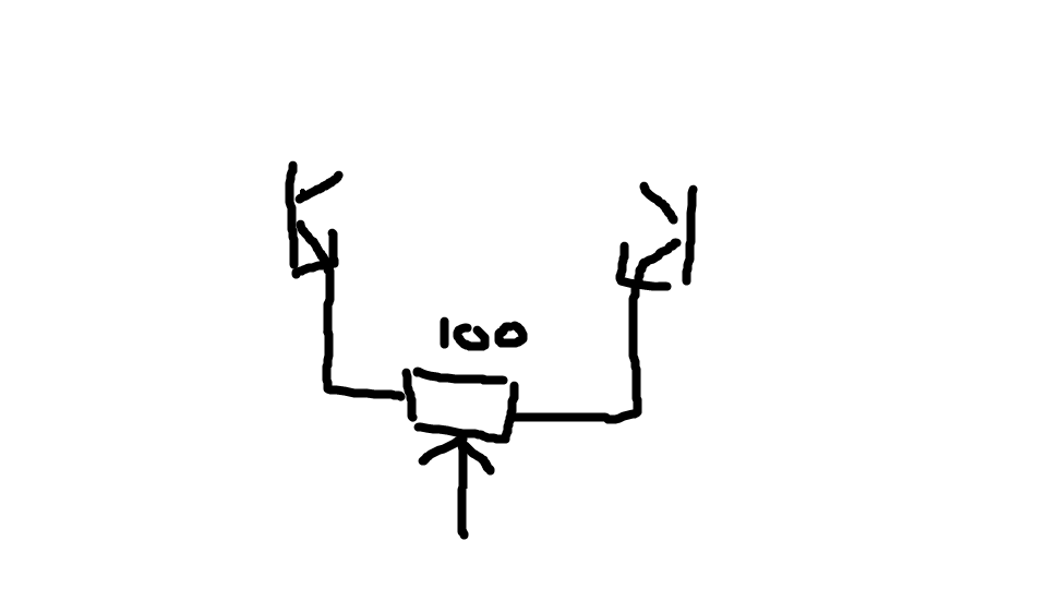

A 100mv offset in practice isn't a problem. If you calculate the power into 8 ohms and the current flow you'll see why... however 🙂
You could try removing one of the two pairs of the 47 ohm resistors and replacing them both with a single multiturn preset.
Like this
I'll try and give that a shot. I assume that the center pole of the 100-ohm pot will feed the collector of "tapped" transistor?
For example, if I replace R413/R415 with the 100-ohm pot, then the collector of Q407 will be fed by the center pole?
Thanks for your suggestion. Any help is welcome. I was certainly surprised to not see a DC offset adjustment on this amp.

Mooly - I just wanted to follow up and say THANKS! Your idea worked great. I replaced the R409/R411 pair with the pot and was able to adjust the offset. When I got it down to 40mV offset, I stopped and pulled the pot out. The measured values stand at R409 = 60ohm and R411 = 38ohm. Given the rather large imbalance (typically 47-ohm each), does this indicate anything more troublesome, or can I keep those values as is and be happy?

Your welcome. Pleased to hear it worked OK 🙂 and you can keep those values and be happy.
(you could possibly get it more balanced still by seeing how sensitive the design was to such things as minor changes in those two zener voltages or more specifically the current in the two 820 ohm resistors R417 and R419. Are they equal ? Just measure voltage across the resistors to check. Tweaking either of those would also trim the offset. This shows a similar front end. Look at the offset voltage and the effect of altering the 220 ohm. Its very similar to yours. )

Mooly, the current across the two 820's is very close (4.96V versus 4.95V) now, but I've already used the pot to adjust the offset. I see how adjusting this could affect the DC offset as well. Thanks again for this idea!

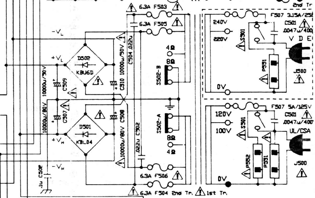

My only issue now is the fact that one of my two main power supply caps keeps bulging (slightly on the top of the cap, not to the point of rupture). I've replaced it twice now, and the caps seem to keep bulging. When I pull out the cap, it measures within tolerance, but I had some extras so I replaced it. I can't keep replacing $10 caps though. It's always the same capacitor (C507, which is the main 80V power supply cap for the +Vh rail). I've measured 71.2V across it during operation, and I've never seen it vary. C508 exhibits no such bulging, and there is no real heat in the area. Any ideas on that?
Eldam, are you saying to place two 1500uF FC caps across C509. C510?
