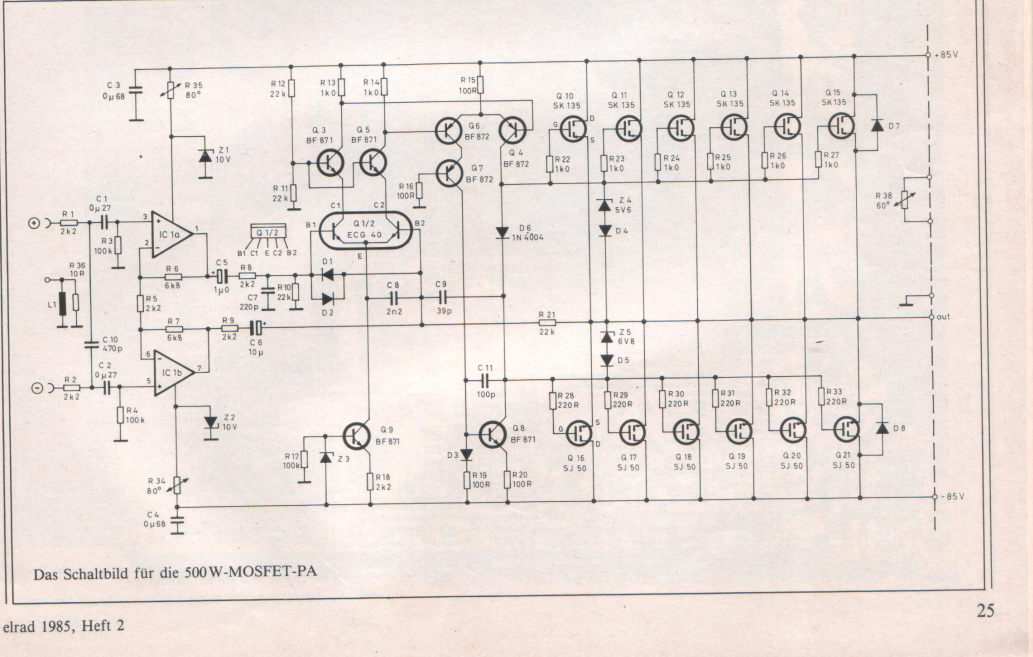

are you sure these were HEXFETs? A copy of my 500W MOSFET PA article with Hitachi lateral MOSFETs (ELRAD 2/3/4 1984) has been published in Audio Amateur 1/1987 and some other journal I forgot.
I'm fairly certain. The amp design appeared right after IR released the HEXFET technology. HEXFET was the first robust P channel FET's to hit the market. Thanks for the schematic!
The 2SK/2SJ devices on that diagram are Lateral FET's rather than HEXFET. You definitely wouldn't want to use anything other than Laterals in that design.

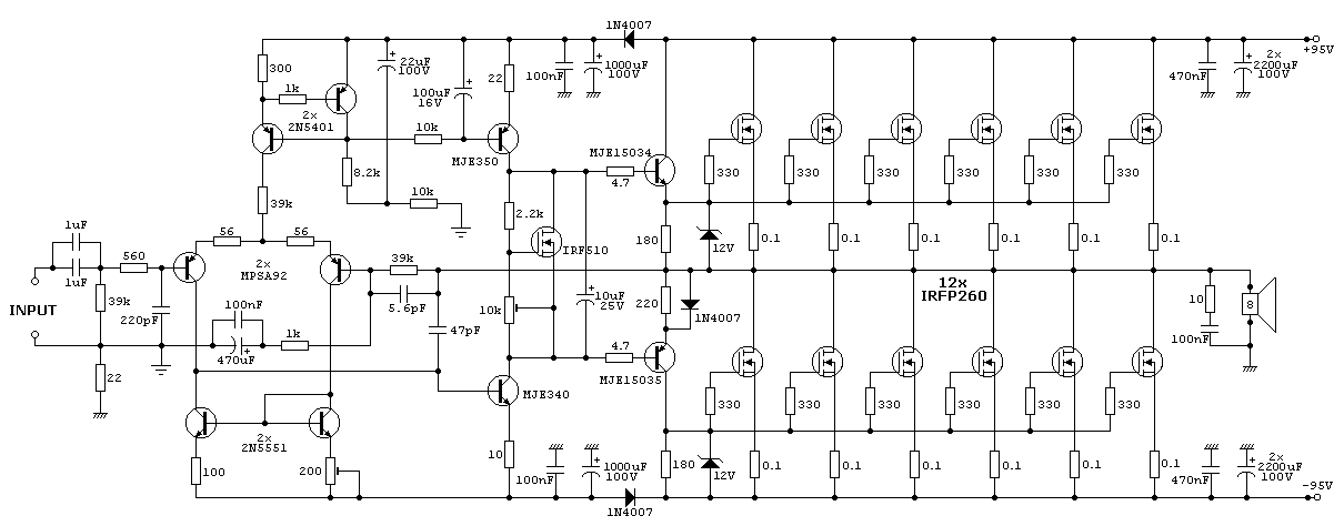

I have come across a number of successful power amp designs using HEXFET's. The HEXFET is kind of a VMOS-LMOS hybrid. Bob Cordell has designed a few. I haven't heard of anyone using power fet's in a Sziklai pair. Too many capacitance problems that end up as oscillations and the Sziklai topology is a beta multiplier and doesn't work with Gm. FET's work quite well in parallel. IMHO
Yeah, that Hitachi LatFET Monster! Strange that current balancing source resistors are missing. In the article they claimed they aren't necessary due to the inherent positive tempco of mosfets. I've always thought that this would only apply if they operate as switches?

Indeed source resistors are redundant here. Current balancing was excellent within one charge. At that time I built 5kW Mono blocks with 36 Hitachi pairs in parallel without source resistors that served the German Navy over years.
Thanks! OTOH, Elektor provided balancing resistors in their Crescendo and Gigant designs that also featured those Hitachi's.

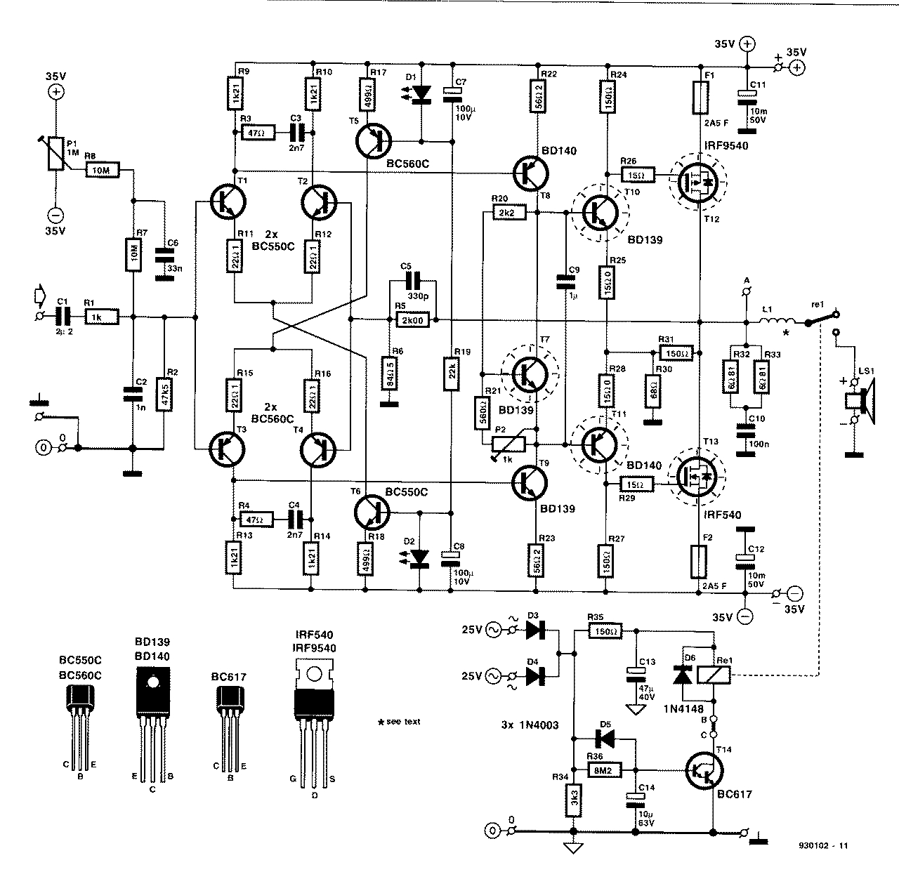

Elektor made the Crescendo and some variants like the Hexfet 60 (IRF540&9540) as well as a IGBT version. There might be others.
The pic is of the Hexfet 60 amp
My audio hobby, now profession started with this amp. Never had trouble with the oscillations (used Bradley resistors mostly, maybe that's why?).
They really started to sound "right" with 2 fet's in parallel.
The IGBT version had awesome bass quality. Sadly that was all there was to it.
The original Crescendo use, iirc, Hitachi fet's. Apart from the higher current draw when cold, you really didn't need any source resistors at all. The modern Exicon also don't, none of the lateral fets do.

I also never had issues with the original Crescendo amplifier, most probably 'cause I've built it along the supplements Elektor has published in the months after December 1982. It was the first serious amplifer of mentionable output power that I've built and it still works flawlessly until now.
