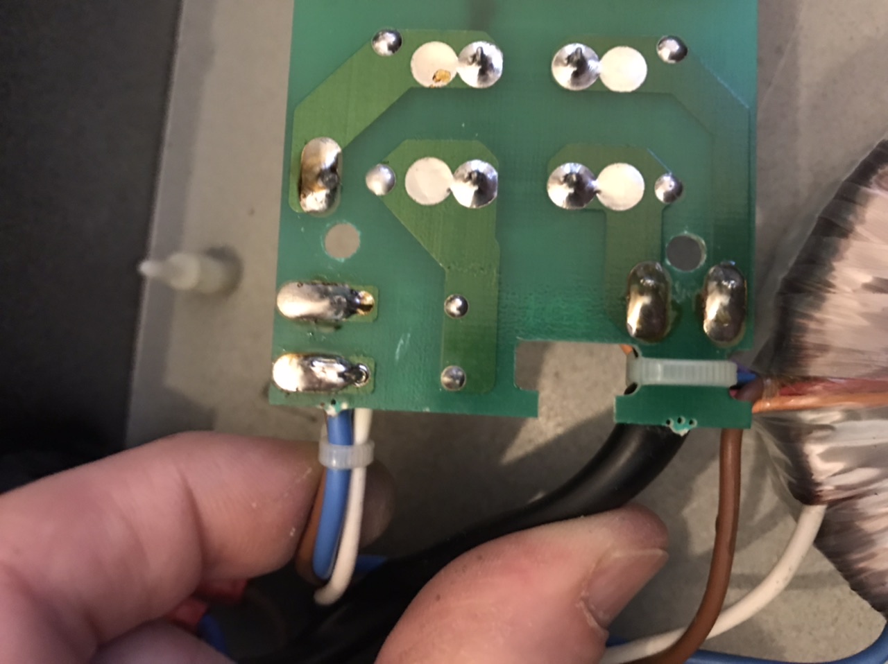

I notices something. Spot the issue:
I was probing the power supply and the underside of the board lit up with mains arcing.
Turns out that the that a couple of joints weren’t even soldered or just tacked with the arcing it probably Leading to arcing! Only been that way for since 1996/97 but having not moved it much. So soldered that.
