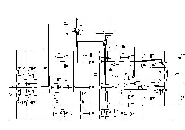

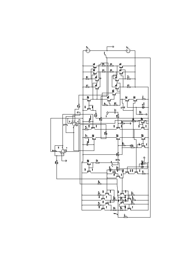

Hello all,
I have to give a lot of credit to a friend of mine who used the basics of this circuit to make a pre-amp.
I made it into a power amp !
The circuit is based upon a diff-pair in where both legs are used to connect to the VAS stage. The VAS steers a CFP pairs in the output.
The voltage offset is nilled by the 2 opamps at the top of the circuit.
Please, your comments !
grtz
Simon
Sorry, did not know how to rotate it !
