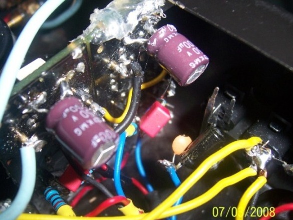

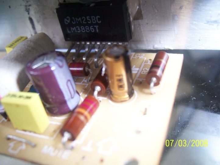

Simple PCB layout, several Riken RM resistors , one 0.7uH inductor paralleled with 10R 1 Watt resistor (at bottom side of PCB), Nichicon Gold 47uF, Nippon Chemicon 100uF...
LM3886 supply pins (at the bottom side) decoupled to ground with 3300pF Wima FKS and ground pin connected to central grounding with 22K Resistor... reducing the DC offset from 30mV to approx. 4mV....

The pictures are difficult to follow. Did you have your own PCB's made ? if so show us the schematic. I have not used an inductor. where have you put it ?

I put the inductor as per schematic, parallel with R7...
Problem is... now I'm hearing very small hum...
(shouldn't be isn't it ?)

The one thing that is different to the circuit I used is the use of the inductor. Do you know why it is there ? I understand that inductors pick up RFI.
The output inductor is for isolating the amp against capactive load but also to block RFI picked up from the speaker cable.
Peranders. Is it just Class D where inductors attract RFI ? They say that when modding Class D amps you should shield the inductors (copper) and ground it ?
The Thiele network on the output does two jobs.
1.) it provides a defined load at high frequency.
2.) it attenuates back emf/RFI that tries to enter the feedback route.

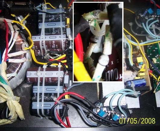

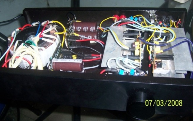

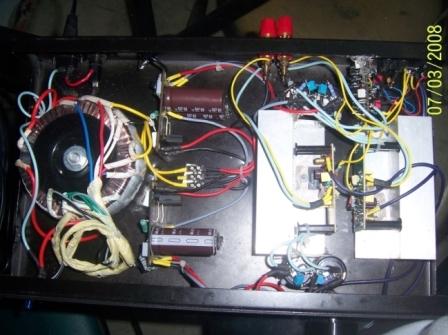

Dear All...
After browsing so many threads in this site, I finally found a way out to solve the humming problem... A separate ground for power and signal (sounds silly eh? 🙄 ... one of those DIY Greenhorn mistakes I presume...)
I also applied grounding circuit as suggested in Elliot Sound Project' website on grounding a power supply for amp...
So, afterward...humming is VERY SMALL and only on right channel.. only can be heard when gain knob at full volume...
Now.. everything ROCKS!! ...

If your chasis is metal sheilded you must not separate the main earth with signal gnd, it is dangerous.
main earth can be connected to signal gnd via a 10 ohm resistor that will reduce gnd loop and elevate danger.
Hi Ttan98 & Andrew T
Thanks for your advise...
FYI, the electricity socket from state supply to most housing in Indonesia is having 2 prongs only ... not 3 prongs as in many other country (which one of it is for earth grounding...)...
As to the signal groundings to the chassis, I have attached 22K resistor (please refer to my previous picture).... hopefully it is a safe measure...
