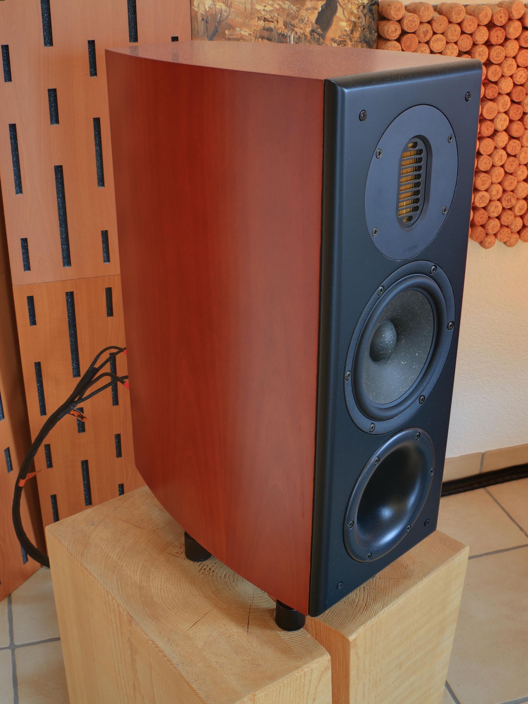

Technical Details:
Mundorf AMT23CM1.1-C
SB Acoustics Satori MW16P
The speaker was built in 2016. Bi-amp design drivers connect directly to the terminals.
Right from the first listen I was very happy with the sound of the speakers including the dynamics, the details and not the latest natural soundscape, to be honest, since I built it, didn't change or modify anything, I'm still very happy.

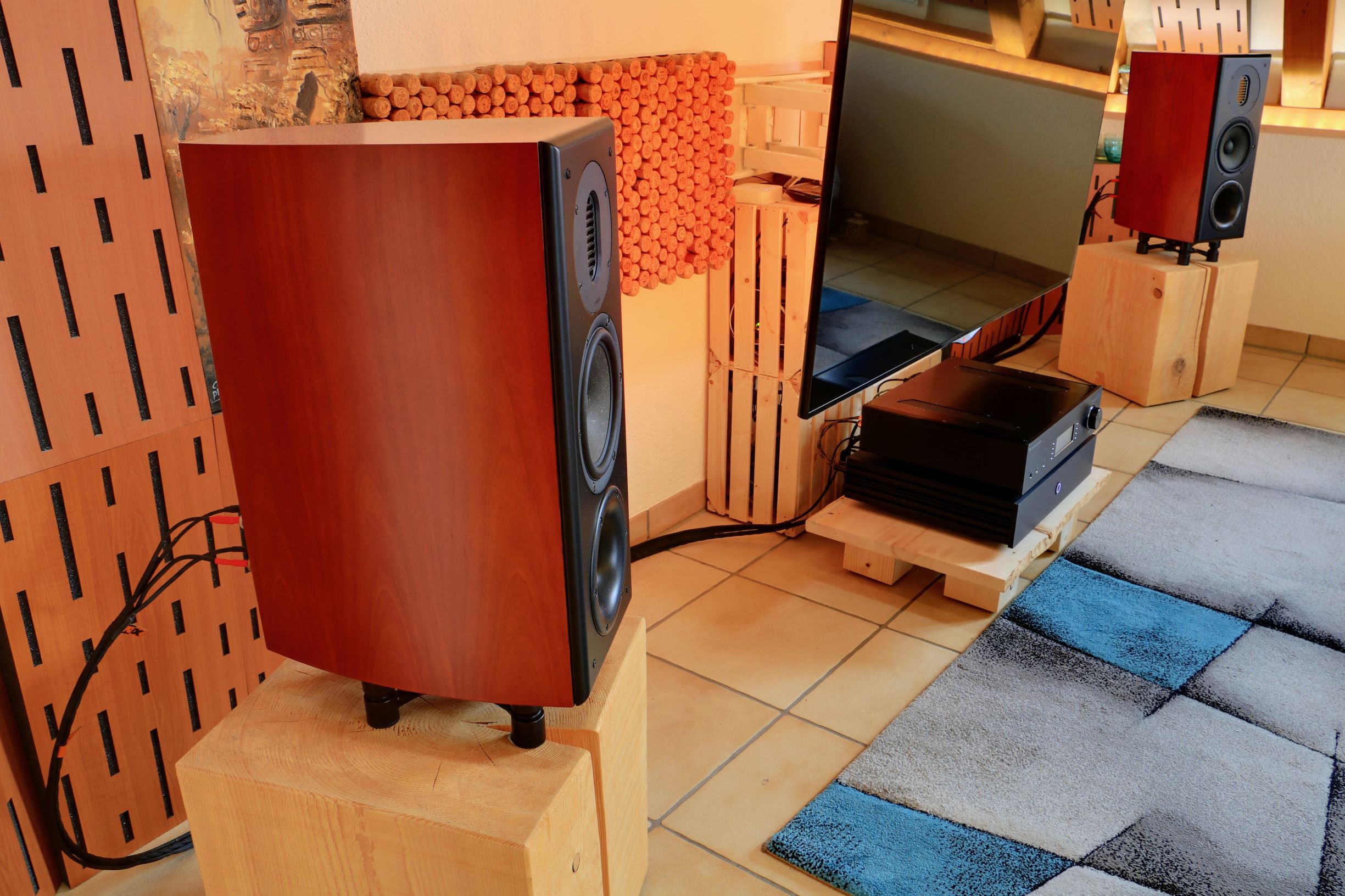

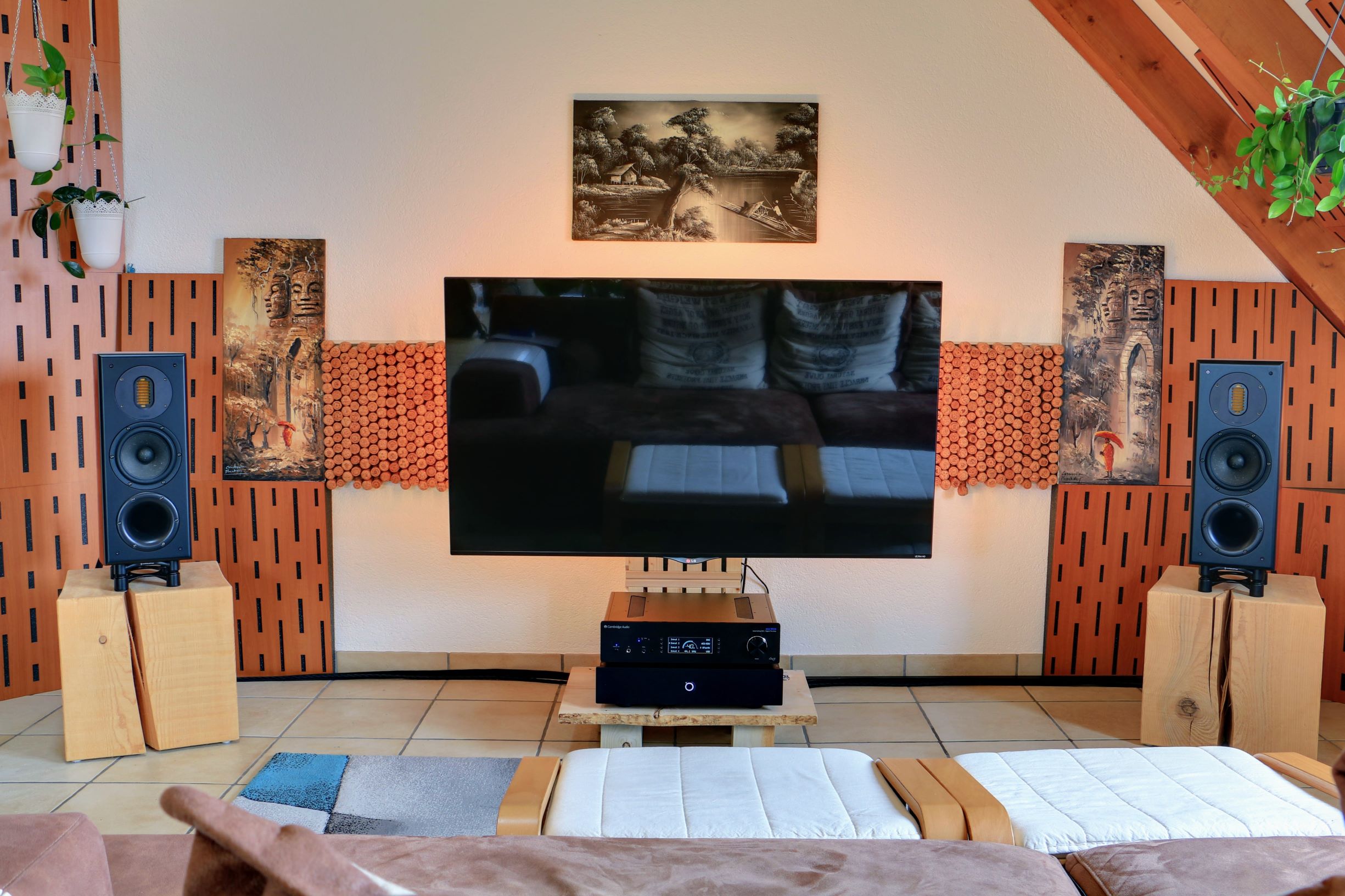

Due to the move in the meantime Sonitus Acoustics absorbers and bass traps came to help and it also became clear that a DSP cloud is doing a magic to correct some major anomalies in the room. The first attempt was the Minidsp 2X4HD with REW. The correction was very good on paper, but somehow the sound lost its natural feel, somehow it sounded like a "calculated" sound image. As I read on, I thought I should switch DSP processing to Dirac Live ... and I kept it!

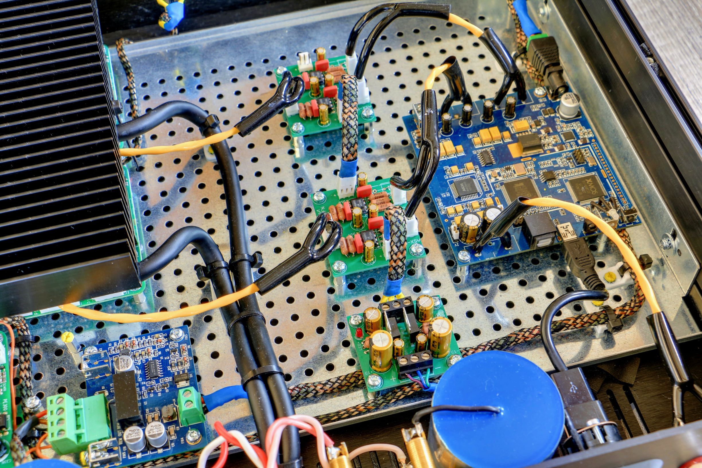

Components:
1x MiniDSP miniDC 12V Isolator Ignition Sequencer
Accessories : miniDC Isolator
1x DDRC24
Dirac Series : DDRC-24
1x BalBUF PSU
Project files: The BalBUF and PSU | theslowdiyer
2x ASX buffers
Project files: Opamp buffer for ICEpower ASX-modules | theslowdiyer
1x ICEXTEND
https://www.profusionplc.com/parts/icextend
2x ICEpower125ASX2
https://www.profusionplc.com/parts/icepower125asx2
HiFi2000 Slim Line
https://modushop.biz/site/index.php?route=product/product&path=120_246_249&product_id=102
In my project I use the 12V from 851d to trigger miniDC and the delayed 12V to start the amplifiers. Yes, I could use this 12V to trigger the amps directly (mute only) but since I had enough space in the case, I chose ICEXTEND to not only keep the amps mute but to turn them off completely when they are not used. (less standby power + longer lifetime)
The project started with some fixtures like DDRC24 and 125asx2 and during the planning process I found that the 125asx2 is a very good amplifier if the source can drive it properly. That would be a direct connection from 851d to 125asx2, but I have DDRC24 between. Then I also need something that will help with the impedance mismatch as the DDRC24 has a relatively high output impedance.
I got very good support from Pascal in completing the project. Very big thanks for this! He helped me to point out that using BalBUF PSU and 2x ASX-Buffer would be a solution that can be built in without other additional cards or power supplies. Basically, the BalBUF PSU is supplied by the AUX of the 125asx2. The 2x ASX buffer can be chained together thanks to the beautiful design to keep the wiring short and simple.

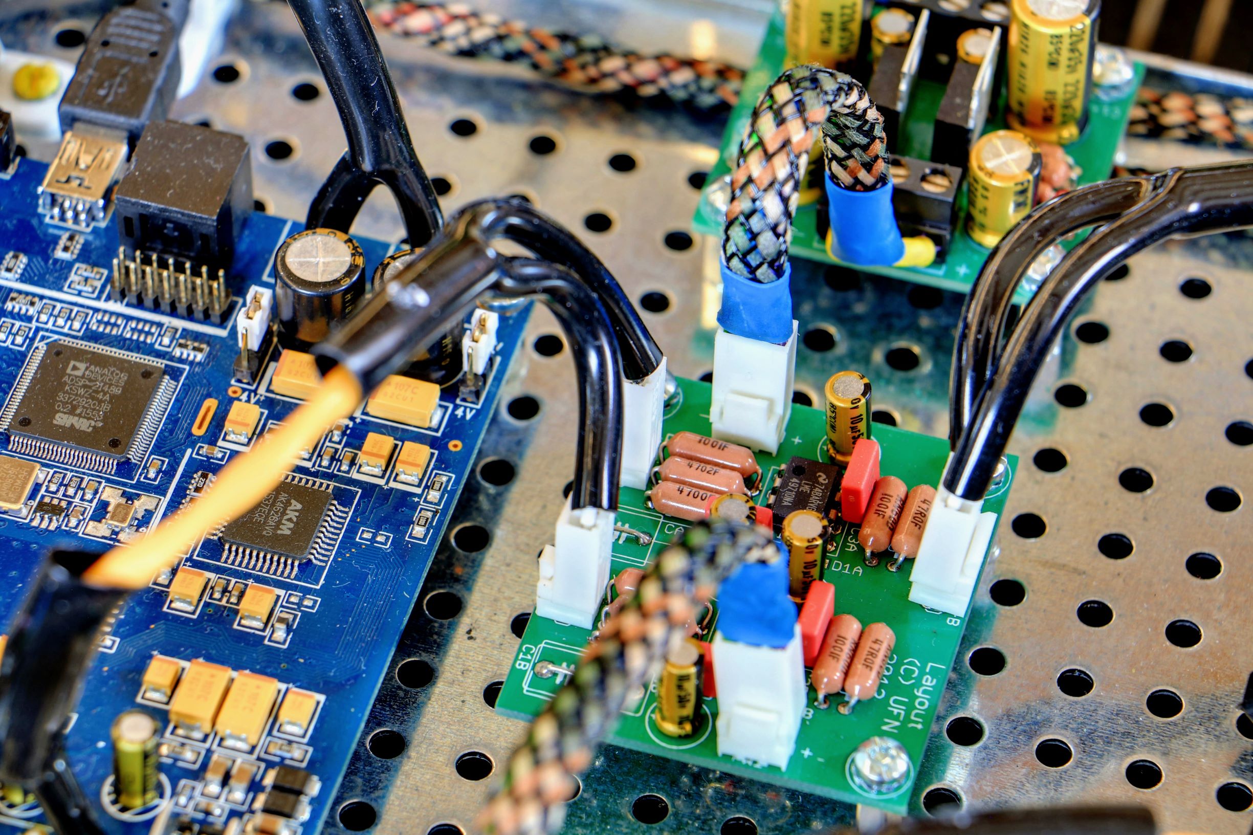

Due to a limited auxiliary power current, there is no way to supply the DDRC24 from the AUX 125asx2, and unfortunately the ICEXTEND has a 5V 1A AUX supply so that this is not enough to supply the DDRC24 with 12V ~ 300mA.
I chose to use an external power supply because I built in the miniDC card which not only contains the ignition sequence but also DC isolator.
The inputs are connected to the DDRC24 inputs and the outputs to the ASX buffer and then to the 125asx2. One amplifier drives the L&R High frequency range, the other amplifier drives the L&R Low frequency range.

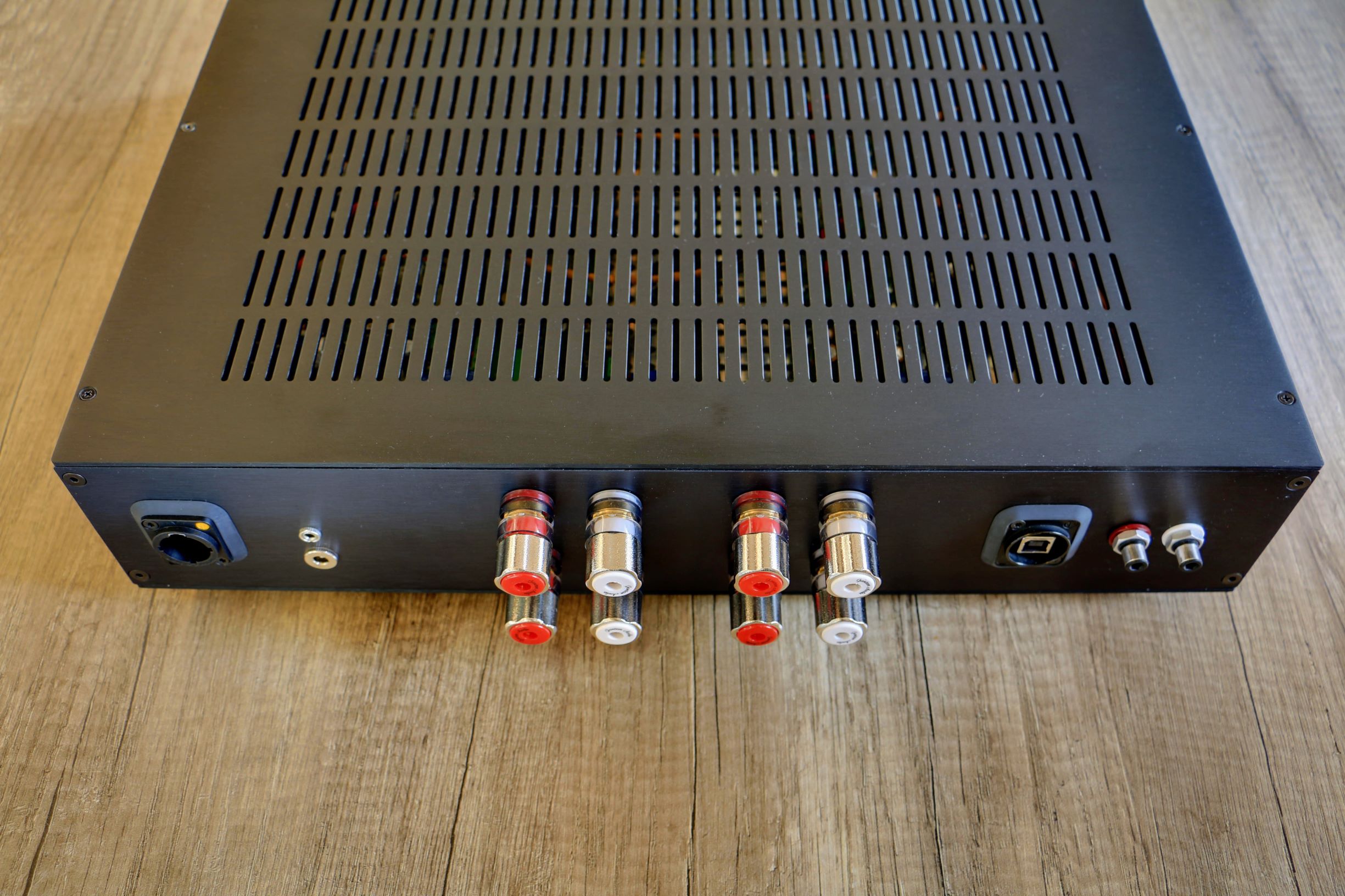

Due to the enough space in the housing, I opted for ClarityCap ESA47uF as protection for the high-frequency drivers.

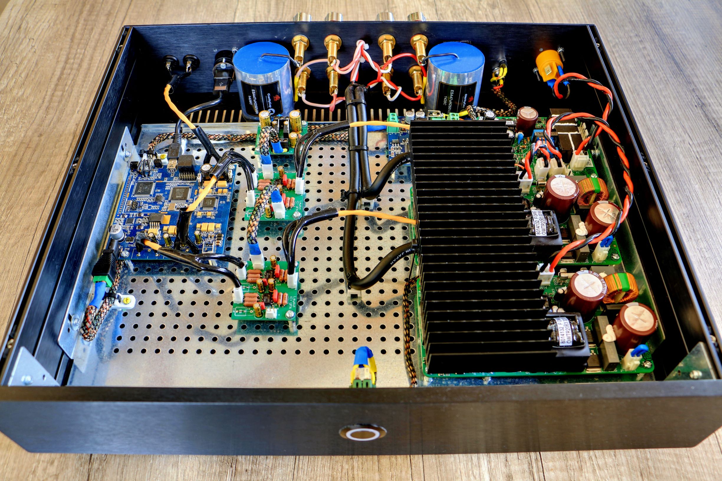

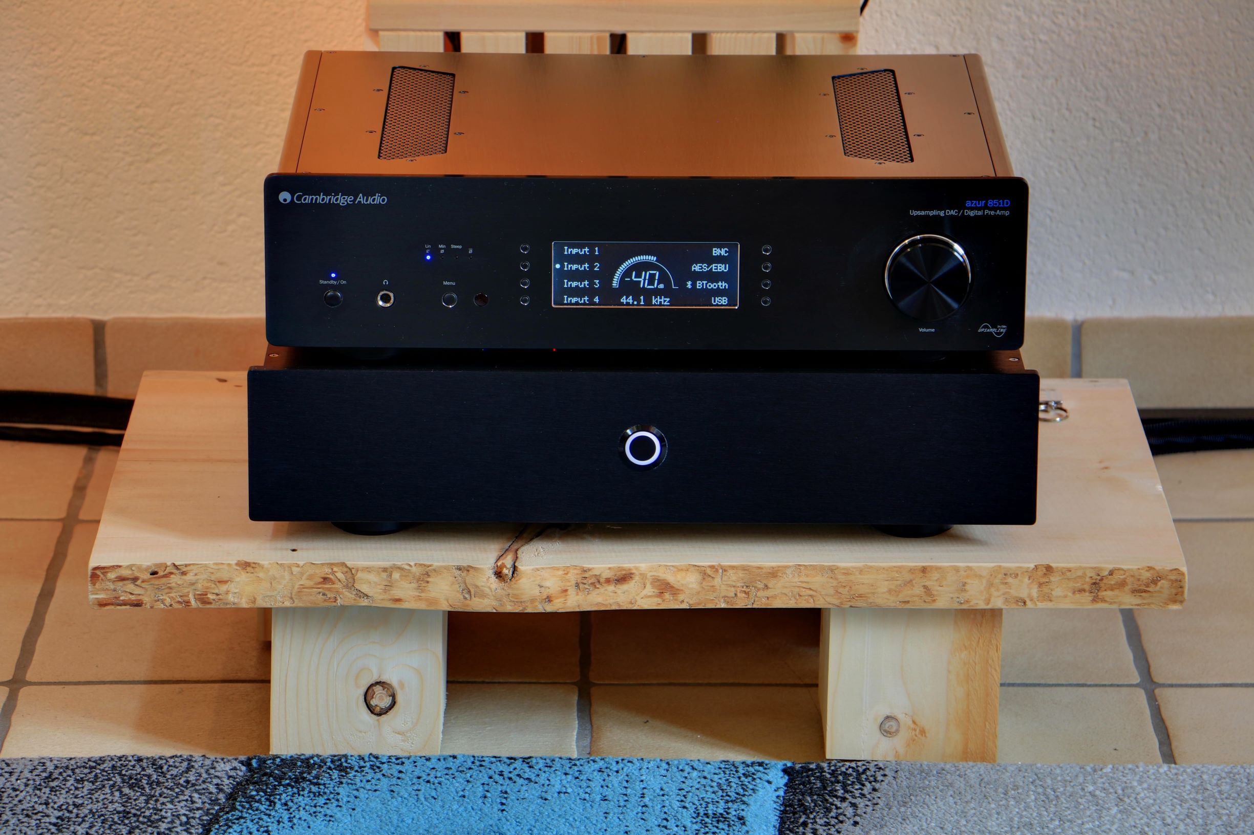

The housing is HiFi2000 Slim Line (all aluminum). The design created by me. I sent the design to modushop.it, where I had very good and supportive communication with Gianluca. The case arrived and in a very short time after I placed the order, the quality of the case including the cutouts is five stars, I am very happy with it.
The enclosure has a 10 mm front panel and a 3 mm top panel. The assembly of the housing is very simple and the removable and adjustable base plate makes it easy to install the circuit boards.
In the internal layout, the goal was to achieve the greatest possible separation between signal boards and possibly noisy parts. It is time consuming to make the correct length of internal wiring, but it is worth it because then the wires will not cross internally, which will also help isolate signal cables from others.
I know the extra heat sink is not must to, but since I had enough space, I installed an extra heat sink on top of the two amplifier boards.
The first start was very easy and straightforward, the 125ASX2 is very quiet in standby mode and the way it sounds is amazing. Significantly higher Dynamics, no matter where I turn the volume control. I mean there is so much detail and dynamics even at low volume - which also requires a high sensitivity speaker, but I have no complaints on Mundorf or SB - this is one of the best parts of this amplifier. The clarity and detail have also improved a lot compared to my previous system. The depth of the sound also offers a much broader stage for playing.
