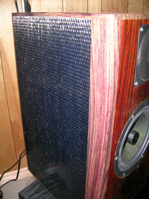

nate said:While you're being critical, why not check this out. This is a better example of my work.

btw I kinda like the look of that sattellite speaker, and nice clean work on it as well.
Yes, it's carbon fiber. The cabinet is two layers of 3/4" baltic birch ply with two layers of fiberglass and then one layer of cabon fiber. I purchased it locally at a fisheries supply house for about $7 per foot. I bought about $60-70 worth and I still have quite a bit left. I used West Systems clearcoat epoxy. Great stuff. The baffle also two layers fo 3/4" birch ply and is capped with 1/8" thick bookmatched cocobolo veneer that I cut on my band saw. The dust is quite unpleasant!
