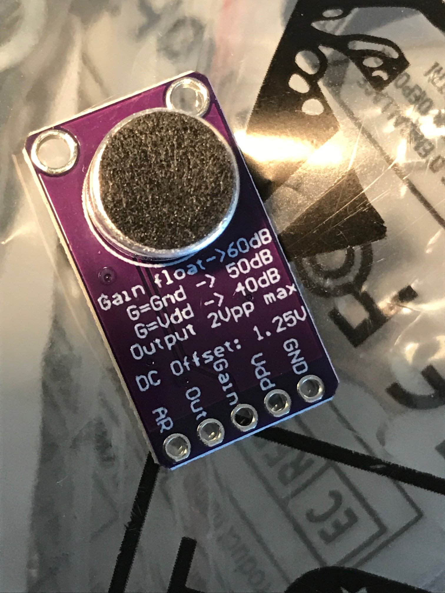

The idea is to use a small class d-amp (MAX98306) and a MAX9814 microphone module. The article contains links to a mother board pcb and a 3D printer enclosure. The authors use some high pass filters and show some results that this fits majority of the patients.

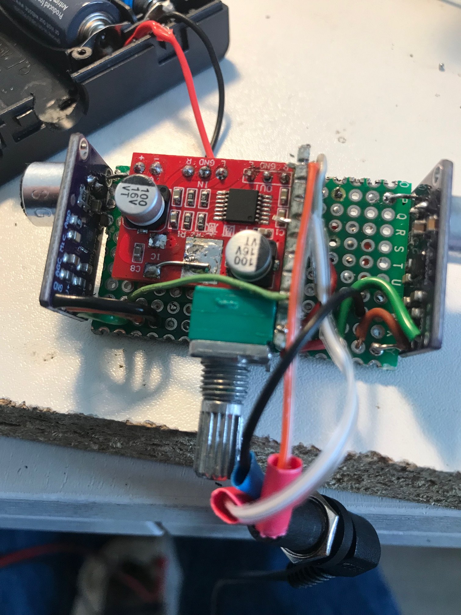

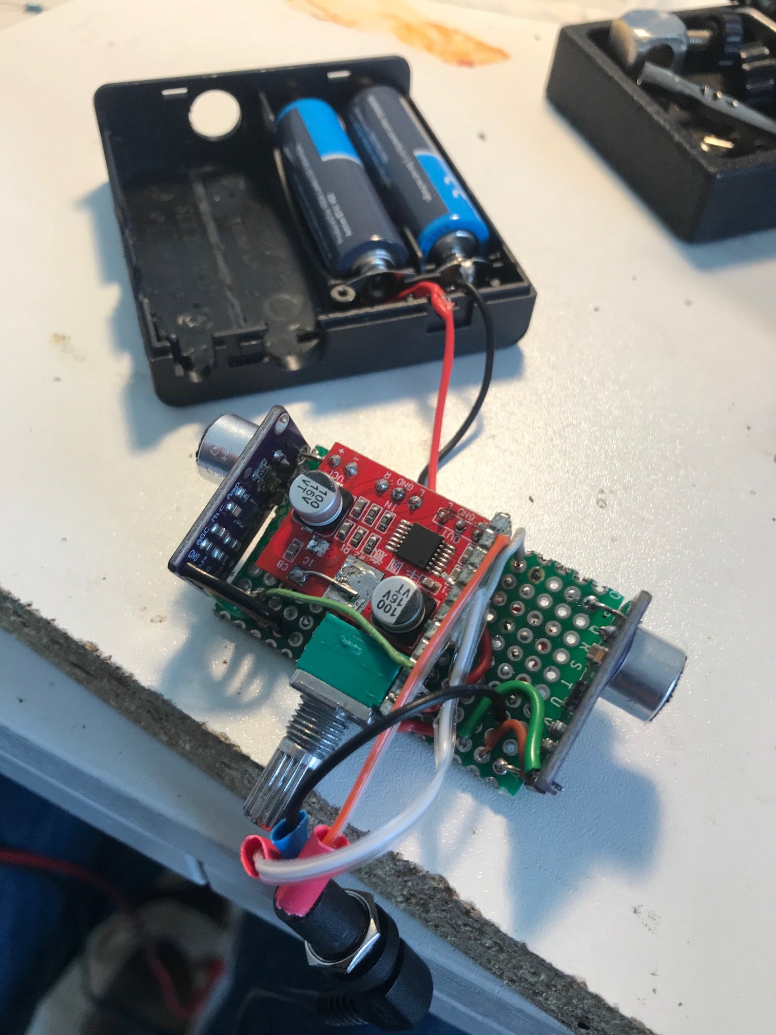

When I inspected the schematics I realised that the class d-amp used is in fact stereo so I thought I would make a stereo version. This cannot be done easily with MAX98306 because it is a "power amp" i.e. it is designed to be used with speakers and is (very) unhappy with the common ground connection in 3.5mm headphone jacks.

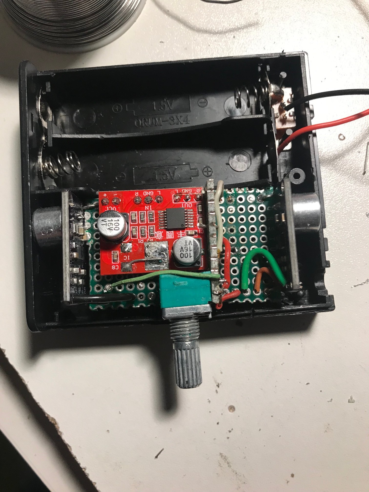

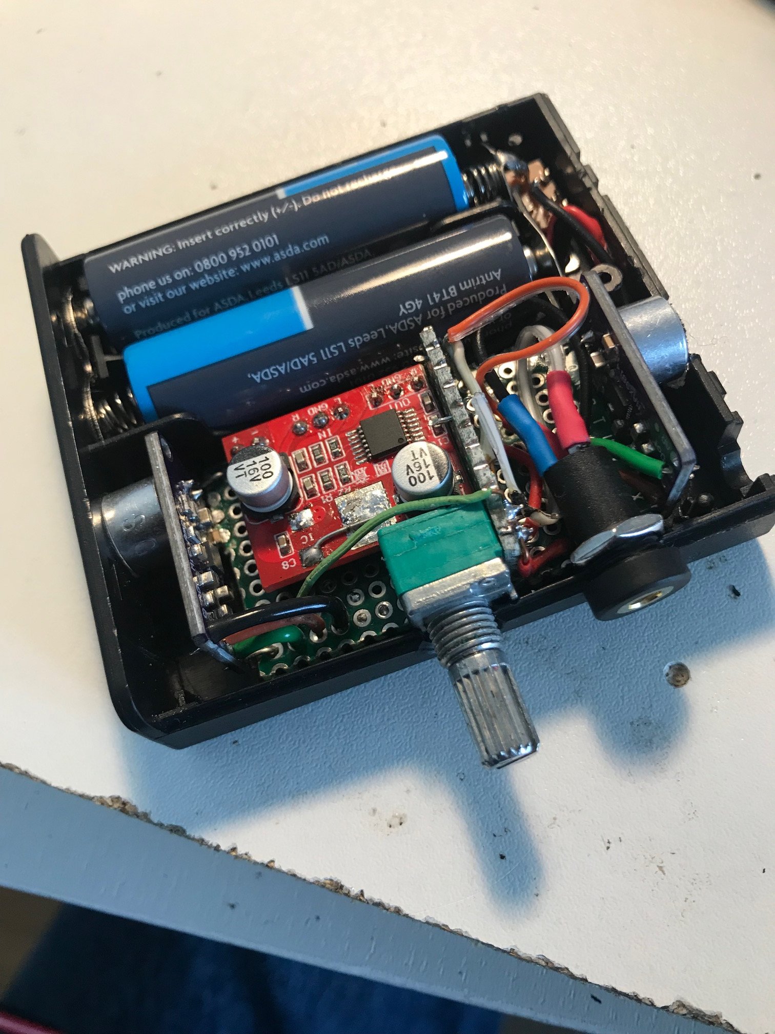

So instead I purchased MAX4410 which is a headphone amplifier. All the boards with MAX4410 I have seen use an on board 3.3V voltage regulator. I have decided to ditch it as I wanted to keep the whole device as small as possible - it was supposed to be powered of 2xAA batteries and all should fit in a a 4xAA battery holder.
The MAX 9814 modules can be programmed to 40,50 and 60dB gain. I ended up setting the lowest.
The device works fine. I suppose setting the volume to a level that one barely notices amplification should prevent extra hearing loss but should allow to have a decent conversation at a family table.

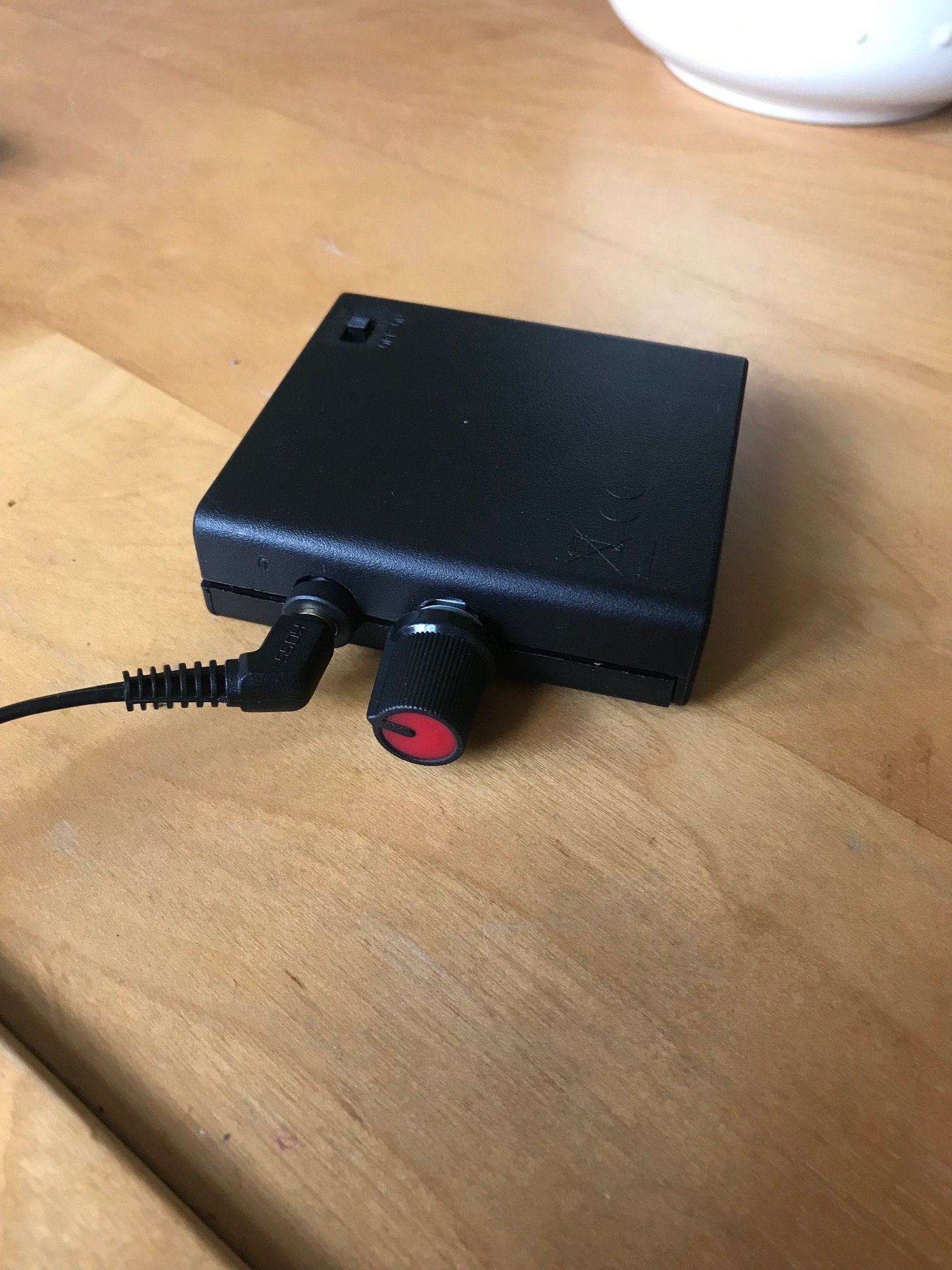

I gave the device to my father.
I did not expect miracles but it is definitely making a huge difference!
My father is active in conversations again!!!
If I were to do it again (which I might) I am not sure I would use two microphones, I think one is enough. It opens a possibility to make the device smaller especially if powered with something like CR2032.
