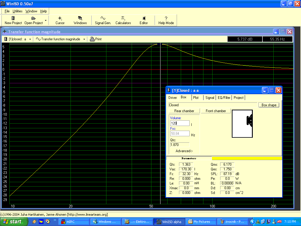

I bought my first woofer(driver) for 25Euro of "Noname" company.
"It should be good for first DIY sub", I said.For that price it has expected Q parameters(look at the graph).So I put a speaker in 120L sealed box,but there is no bass at all(friend´s logitech speakers for 50Euro play better
*Can you give me some opinion?What is wrong here?Construction of the box?
Thanks!
Dean

1. Your assumption may not reflect reality. The response attached would give boomy kick drum bass atleast
2. There could be a variety of problems with current unit
3. Buy something that many others have here,such as Adireaudio units and a plate amp,and problem solved

I agree that's one hell of a boomy curve, but before spending more money let's look deeper into what you are doing. How are you deriving the signal for the sub? It may be that you simply haven't got your filter right. Your amplifier could be at fault. Just for starters...
Ok.I made 100W amp from tda 7294 chip.For filtering I use active filter 12db octave-variable;about 100hz(I try variabling,but there was no diffirence at bass-except,that mids were cut off)
Have you tried the sub with another amp, a bought amp? I think your chip amp could be the problem.
Yup. I suspect the IC. At least try with another, prefereably much more powerful, amp and compare.
Re the TDA 7294:
-----The manufacturer's literature calls it a 100W unit. That's pure balooney unless you like 10% THD (and that's THD of the solid state variety). 50W is closer.
-----If you are really trying to run it at 100W, you are pushing it way up the thermal dissapation curve (see datasheet). Unless you have a sufficiently large heatsink to deal with that the chips protection circuits may be restricting the power available
---You didn't show the circuit elements surrounding the chip. If you are just cloning the application notes, I think one or more of the examples in there roll off HF a bit at the input (a high-pass filter) probably to save the chip from attempting to be used beyond it's capabilities.
---I think 100W (let alone a more realistic and listenable 50W) is pretty skimpy for a sub woofer anyway. Again this can be veruified by borrowing a higher power (200W?) amp and trying that with you speaker.
It may very well be that the fault likes with the loudspeaker after all, but I think you need to resolve the amplifier question first so that you can narrow the problem.

What do you expect? You have a high Q woofer in a box that pushes the Q even higher. Not only will you have exaggerated upper bass but the low bass will all but evaporate. The woofer is useless.

The Qts is enormous. Are you sure you have it right? If so, the speaker would want to be mounted in a wall or ceiling - or a really gigantic box. And I mean gigantic as in you could live in it. Even then you would have a big bump in the low bass region.
You should be hearing too much bass (around 40Hz), not too little. Either the speaker or the amp is not working right.

Since you know how to build an amplifier, I suggest to measure by yourself the T/S parameters of this woofer after 24 hours of break-in.
I've never seen a Qts that high.

Qts 1.363, yes that's high but not something I haven't seen before in dirt cheap woofers. These kind of drivers are crying out for mild Linkwitz Transform or EAS/ELF use in small rooms where they won't be driven hard.
I also have doubts that the values in the data sheet are
alright......
I would assume that the drivers resonance frequency is much higher than stated in the data sheet.
If you feel that entire T/S parameter measurement is to complicated, then you should at least check the resonance frequency of the driver
without box. Simply drive the driver with a sine wave, sweep the
frequency and measure the current through the driver. At resonance frequency the current will have its minimum, because of the impedance maximum.

Never trust a data sheet of no name drivers!
Richie already said: ....crying for a LT....
If you are able to measure the T/S parameters then you can turn the
entire behaviour of the sub by a linkwitz transform to any wish.
