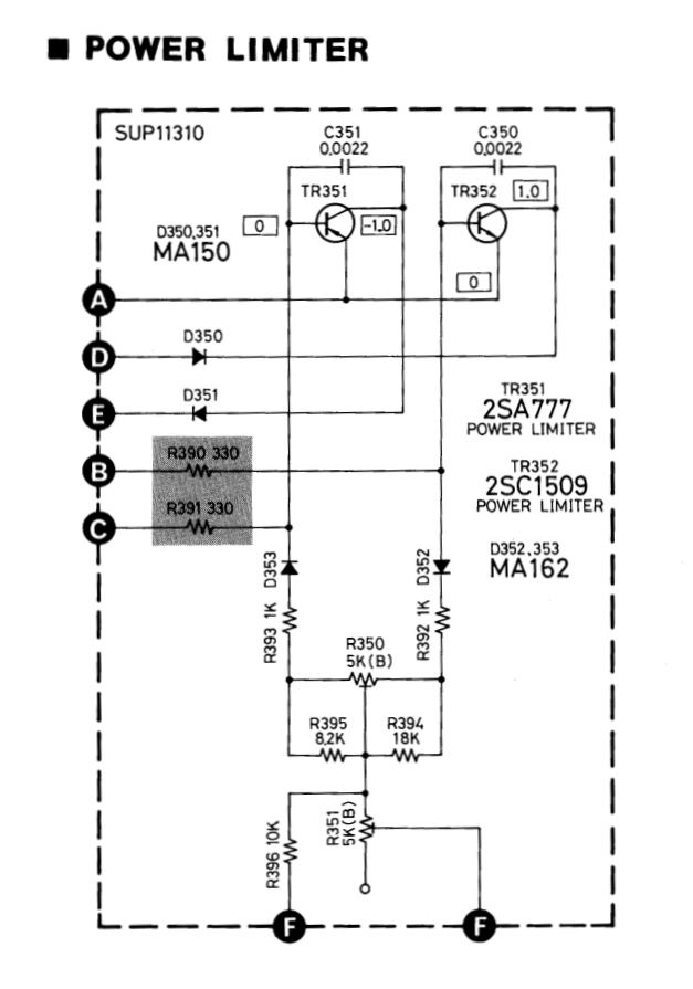

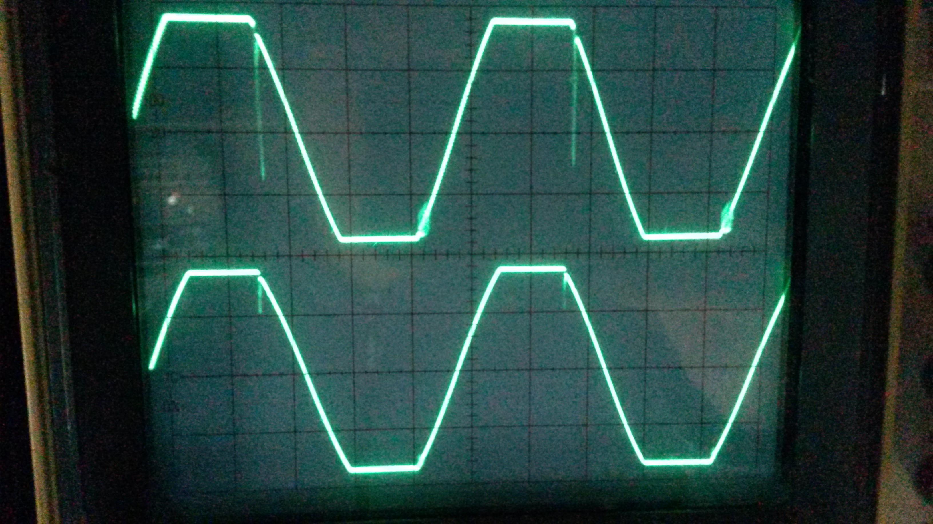

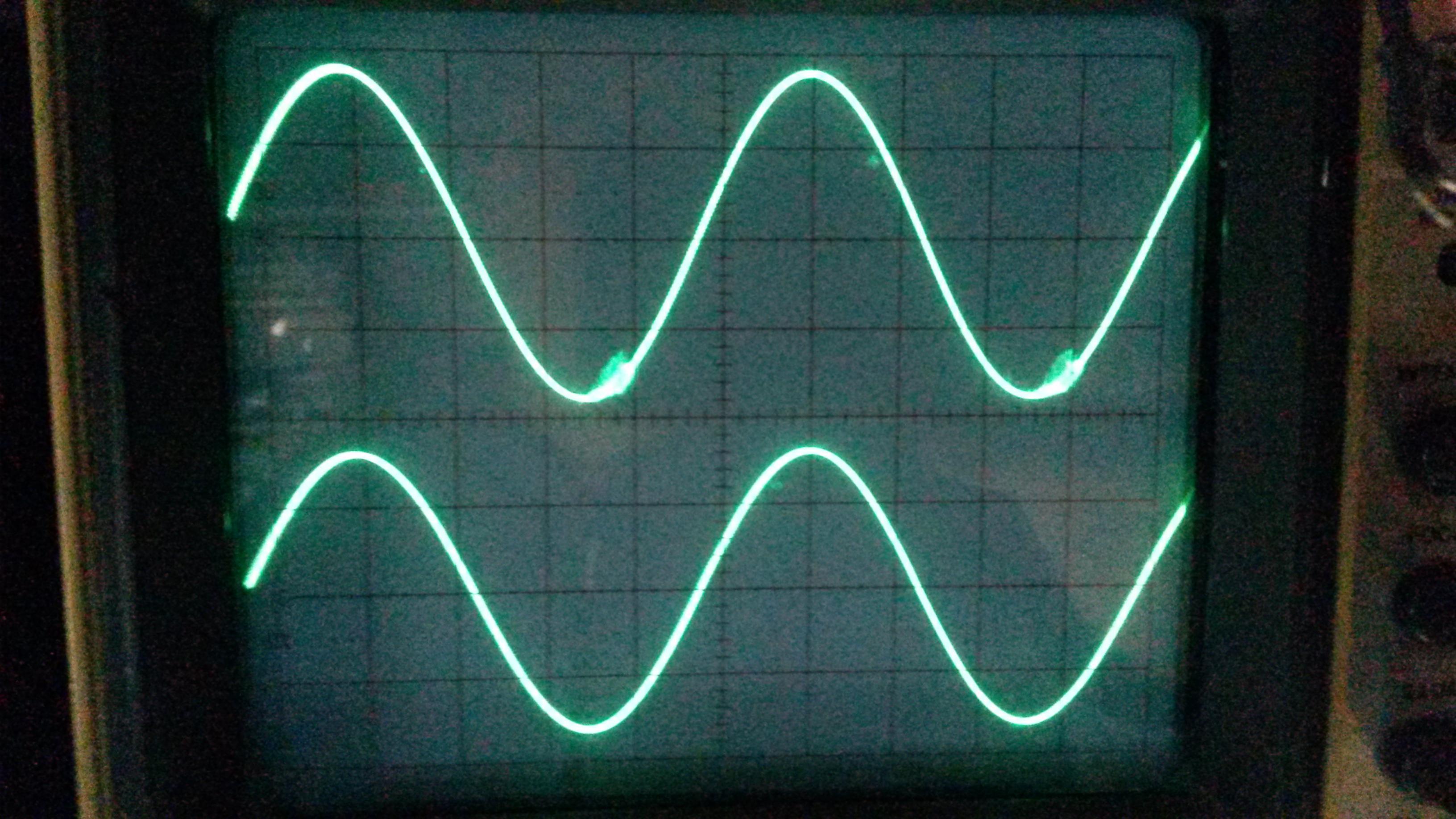

Hi. This is repairing a Technics Su8080. Replace output transistors with MJ15003G / 4G and drives with MJE15030 / 31. It works fine, but I notice some anomalies when the amplifier goes into clipping zone, at 8 ohms, and gets worse at 4 ohms. Any suggestions?
Thank you very much to all.
Power limiter
Could it be anything related to the power limiter? How about adjusting R350 and R351?
The service manual has all the guidance.
https://www.hifiengine.com/manual_library/technics/su-8080.shtml
You could do some careful testing with the limiter disconnected from the circuit. Just wondering.
